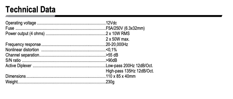

This is a low-price car-sound amplifier. The "rating" numbers are grossly exaggerated. It clearly works on a 12V 10A feed in a car, and probably can't suck all 10 Amps.
House-powered car-power "220VAC to 12VDC" converters are a very standard product. And really too cheap to DIY.
Amazon.com: AC to DC Converter, HOTOR 8.5A 100W 110-220V to 12V Car Cigarette Lighter Socket
Amazon.com: Acekit 180W AC to DC Converter 110v 220V to 12V Car Cigarette Lighter Socket
These days, most accept 110V-220V. Most in the size you need have a "cigarette lighter" 12V output. Be SURE you get polarity right.

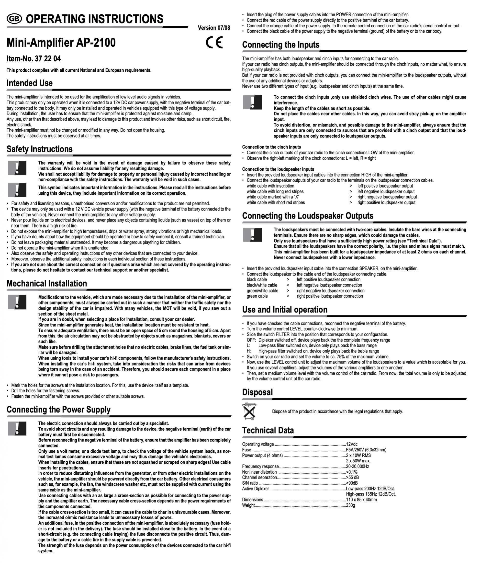

The users notice mentions a fuse of 5A, but nothing more, (see pictures attached)
Someone mentioned that it would cost about a 100$ for the right converter... but it would be stupid to spend this for a 30$ car amp...
Are you sure it would work on a 8,5 or 10A?
If so, can I cut it and wire it directly, or should I mount a male cigarette lighter socket?
