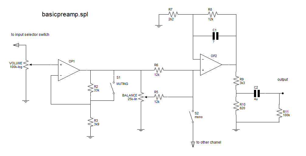

I did some work around this project.
So now I have this schematic
First stage 19dB gain and 0 dB when MUTE is switched in.
Balance pot & voltage divider 2 dB loss in neutral position. Maximum drift will give 6dB unbalance. One chanel rise 2dB
Second stage 16dB gain.
Output voltage divider & impedance matching 14 dB loss.
C1 is for high frequency roll off
Still to do: turn-on turn-off thump killer.
Question : should I make the second stage a voltage follower and put the high frequency roll off in the first stage ?

Running the second opamp with all that gain only to attenuate it passively seems... well... crazy 🙂 tbh. Why not run the second opamp as a unity gain follower instead and ditch the 3k3/820 ohm attenuator.
So yes, make the second stage a follower.
DC coupling pot wipers to opamp inputs isn't good practice although using FET devices (such as the OPA134) will let you get away with it in practice... its still bad design though.
Why do you want high frequency roll off?

Why so much gain? Did you check how much gain do you actually need? Also, the mute switch should cut the signal entirely and not simply reduce the gain of the first stage to unity. Another issue is the voltage divider at the output. First you introduce an unnecessary amount of gain and then passively attenuate... In any case, you can safely use smaller value resistors to reduce the noise. C1 may be needed for op-amp stability but I see no point in attenuating high frequencies this way. If you need to attenuate HF interference, then do it at the input of the first op-amp. Don't forget DC blocking capacitor between the volume pot wiper and the op-amp input.
Before you spent another 2.5 month to come up with the new circuit i would advise you to study known designs first. For example project 88 by Rod Elliott. It is currently discussed in the neighbor thread here.

The others are giving you good advice.
Most pre-amps when operated with balance control and tone controls centered, actually operate at unity gain.
Your source devices will be producing a CLL (Consumer Line Level) signal at your inputs. Your power amplifiers will be expecting CLL signals at their inputs. Any intermediate gain, as with your design, will simply increase clipping and distotion in the power amp.
Would somebody tell me why DC coupling wiper to OP amp is bad ?
Is it because it will change DC equivalent resistance at OP amp input ??
Reason #1.
If the wiper connection is intermittent at all then the opamp input will float and probably send the opamp output heading toward one of the rails. Any design should be constructed to be immune to such failures.
Reason #2. Yes, it will change the DC resistance seen at the opamp input and if that opamp is something like a 5532 (bjt with high input bias currents) then the shift in DC offset at the opamp output as a consequence of this would be significant.
Reason no #3. Its just not the 'done thing' and isn't good design practice.

Any current flowing on the wiper will be briefly interrupted as the wiper moves over lumps and bumps on the track (especially after a bit of aging), which can cause extremely loud crackling in the audio signal as the opamp output jumps to to the rail (remember opamp inputs require a bias current).
You can either use a DC-blocker cap on the wiper, or use CMOS or JFET input opamps, where the bias current is extremely small and the input capacitance of the device prevents the swing to the rail happening in the short timescales involved. You will still get some crackle, but limited to the same volume as the signal at most.
To put numbers on this, a typical bipolar opamp input has 300nA bias current and say 20pF of capacitance. That causes the input to slew at 15V/ms, causing the opamp to go into slew-rate limited output swing, perhaps 20V/µs. So even 1µs of contact interruption can cause a full 15V output spike, and typical bursts of contact bounce will be deafening.
JFET inputs might be 50pA and 30pF, ie input swing rates of a few mV/ms during interrupted contact, orders of magnitude less, and CMOS opamps have even lower bias currents, sub-pA
