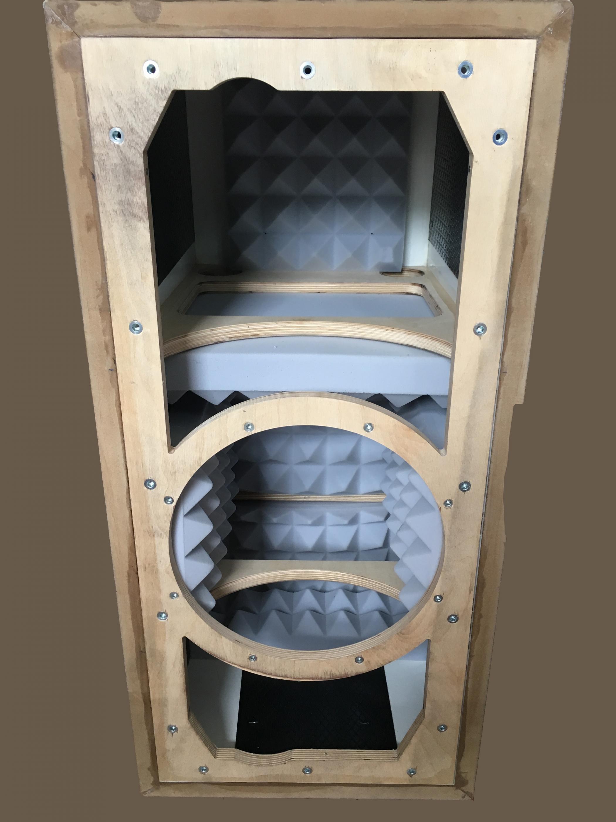

hi guys,
since a few of you already know; I am working on my ATC SCM100 clone
(SCM100ASL Pro | ATC Loudspeakers)
It uses a 12" ATC bass in a ~100L cabinet and a 10cm dia port tuned to 30Hz.
Now I am wondering about the cabinets damping.
I have some Basotect over laying around and was wondering if thats a suitable material for damping a cabinet?
I know it's brilliant for acoustic treatment in rooms but not sure about cabinet and speaker design?
Any experience and/or suggestions?
Basotect is great stuff: reticulated open cell melamine foam. You can also find it as “magic eraser” home cleaning pads. I think it’s one of the best sound dampening materials you can use inside a speaker. I often use it directly beside or in back of a tight driver chamber to prevent reflections. If you have it, use it.

Today I've worked on the damping and installed 8cm pyramid basotect in the cabinet. Behind that you'll find bitumen sheets.
In the upper compartment I will still install some polyster wool or the like.
The lower compartment won't show that, since it will have a BR-tube (see cut-out)
Do you think what I did is viable?
No clue, but sure looks like overkill for a BR, so looking forward to some measured specs since the real ATC speaker specs a typical T/S max flat alignment, which normally requires very little damping assuming the box isn't too undersized for the driver's specs.
GM
You can get 100 pieces of melamine sponge eraser pads for $5. Same material as Basotect.
Lots 100Pcs Magic Sponge Eraser Cleaning Melamine Multi-functional Foam Cleaner | eBay
They are a good size for many projects and useful for lining region directly adjacent to backside of driver around basket.
Regarding blocking middle of BR cabinet - a good idea to break up standing wave modes in a BR cabinet - just leave some room for air flow. It is permeable but has high flow losses due to tortuous path.

Hey,
I finished this project with the damping as shown in the picture above.
I even added a little basotect in the upper compartment left and right.
Further I filled the upper compartment with synthetic wool.
And I am more than happy with the result.
This is a very close clone to the ATC SCM100 A, hence a bass-reflex system.
What I really wanted to avoid is that boomy, inflated bass which I experienced in almost all other BR-system. My box almost remind me more of some closed cabinet designs.. Tight and linear bass but still with lots of headroom caused by the BR. I aimed for that effortlessness of BR-systems.
So I can report nothing but positive experience with basotect.
It might be more expensive than egg-foam but totally worth it.
I have to be fair and say that I didnt even try using egg-foam.
But I highly doubt that I would have gotten the same results.
By the way, I used thick pyramid basotect with 8cm thickness. (I wouldn't go any lower tbh)
