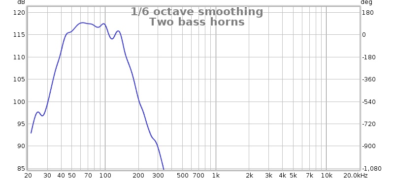

I have two Peavey FH-1 clones and use them for bass. I will replace them soon with Cervin Vega SL36s, just because I can get them cheaply. I would go for these as well, tend to like this kind of bass bins🙂

I guess I must have been really lucky with the CV horn clones. This is the response of a pair. When I install the other pair, it will kill🙂
