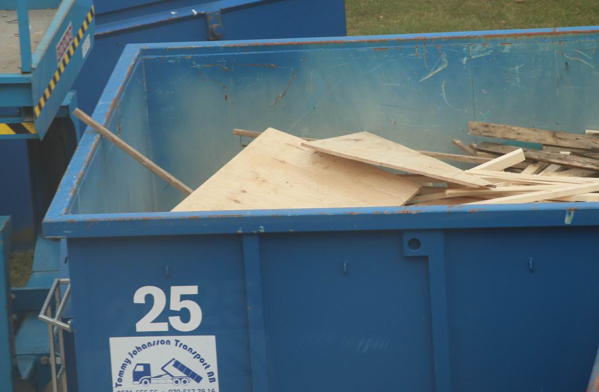

Right now I am waiting for the darkness of the evening to come as I spotted a huge piece of plywood in the container.
Being 70+, I don't want to carry around a 200kg rigg, but something slightly larger than a Calvin Cline handbag would be nice.
Thanks Printer for the schematic. Finding preamp schematics for a "normal" guitar is easy, but I haven't really found something for a bass guitar.
Just grab it.

😈🤣 se upp för poliser!Right now I am waiting for the darkness of the evening to come as I spotted a huge piece of plywood in the container.

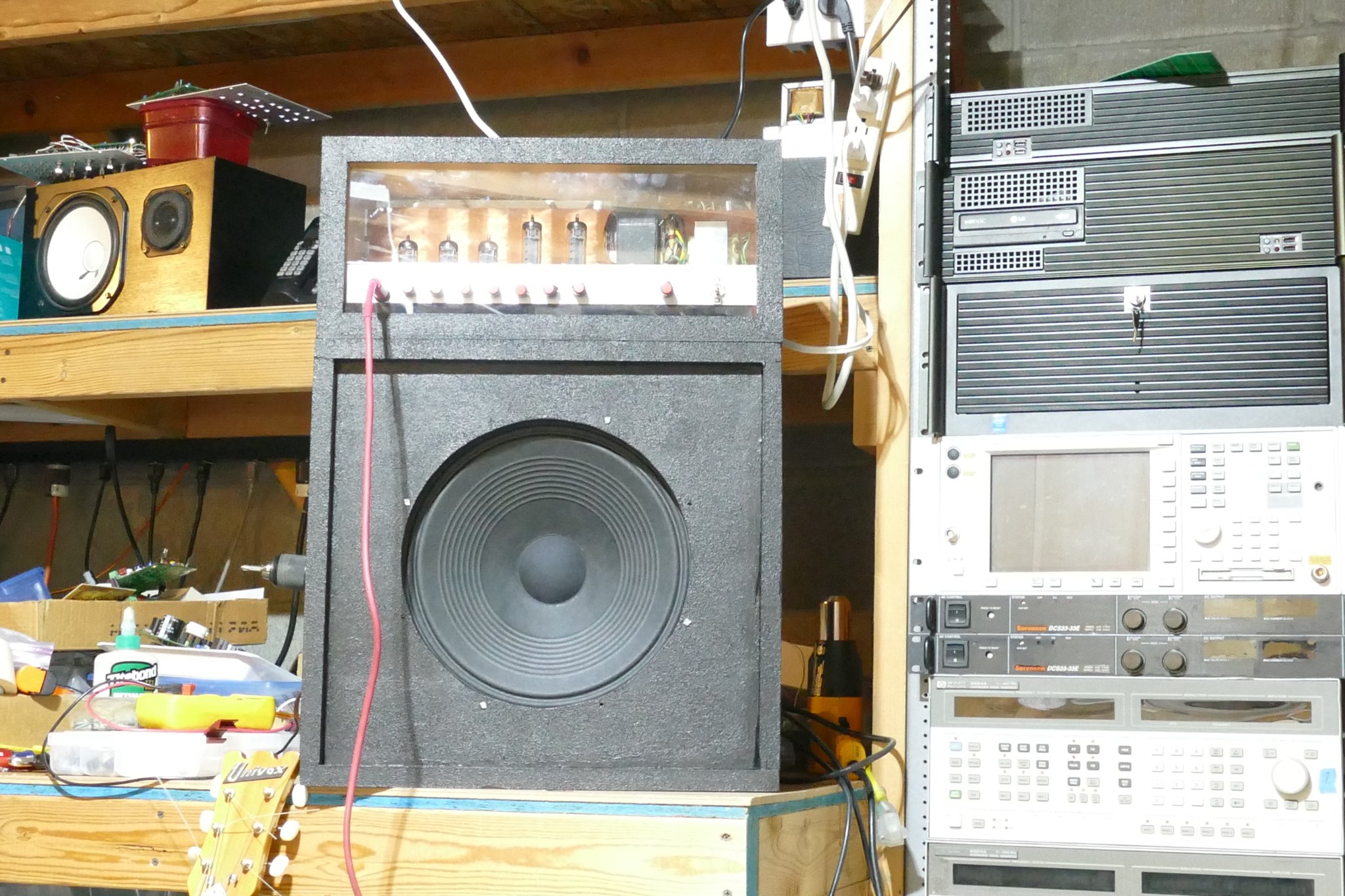

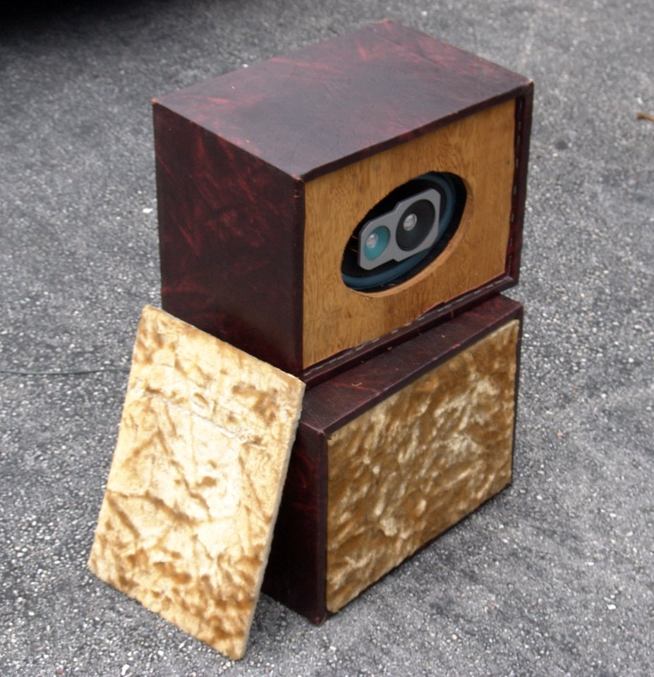

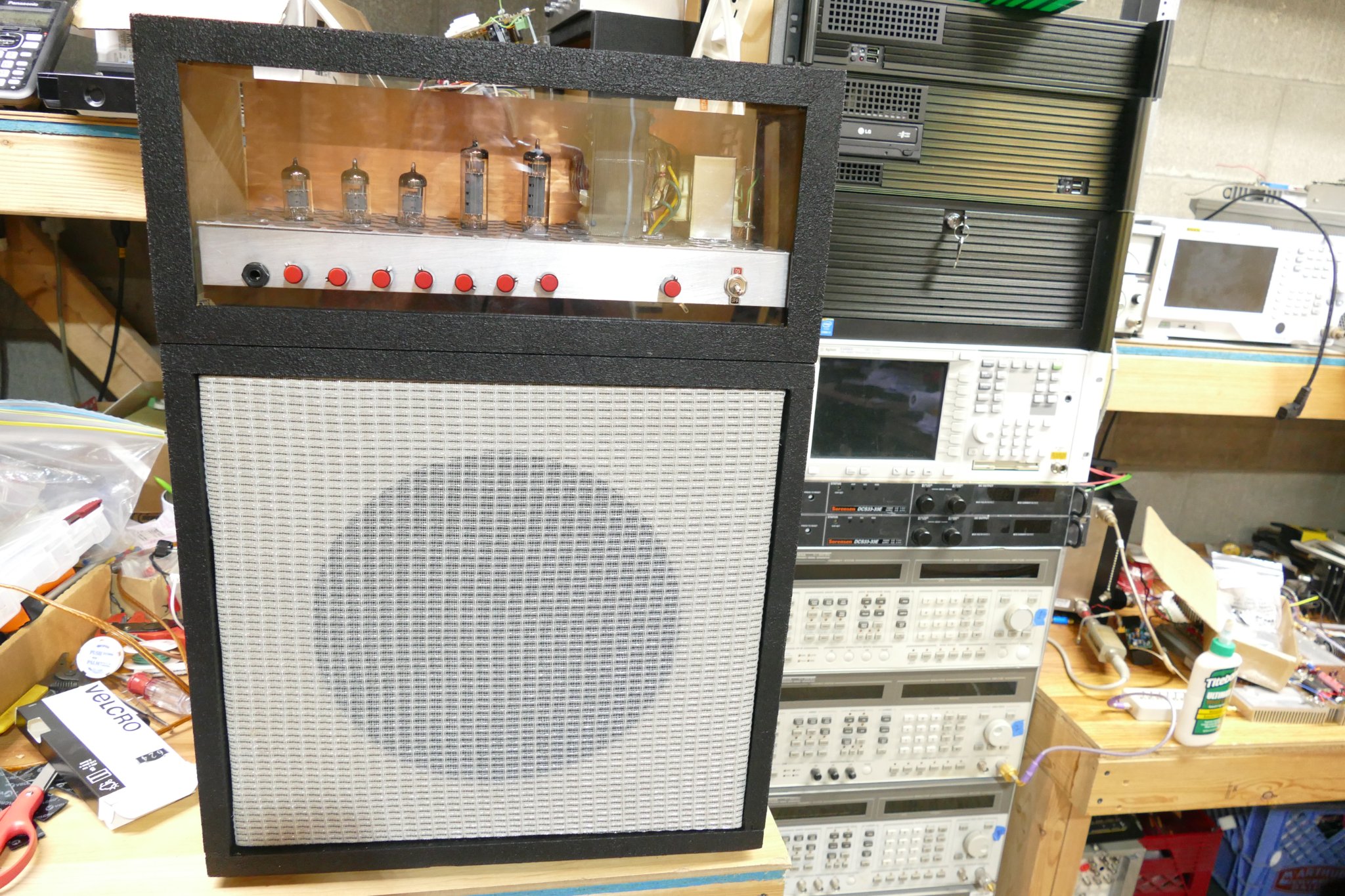

I have made several speaker cabinets from recycled wood. The speakers seen in post #12 were made from wood left from a re-roof job at a house near where I used to live in Florida. There were dozens of 4 foot by 8 foot plywood panels that had been removed from the roof. many were completely rotten, but some had reasonably large areas of usable material.

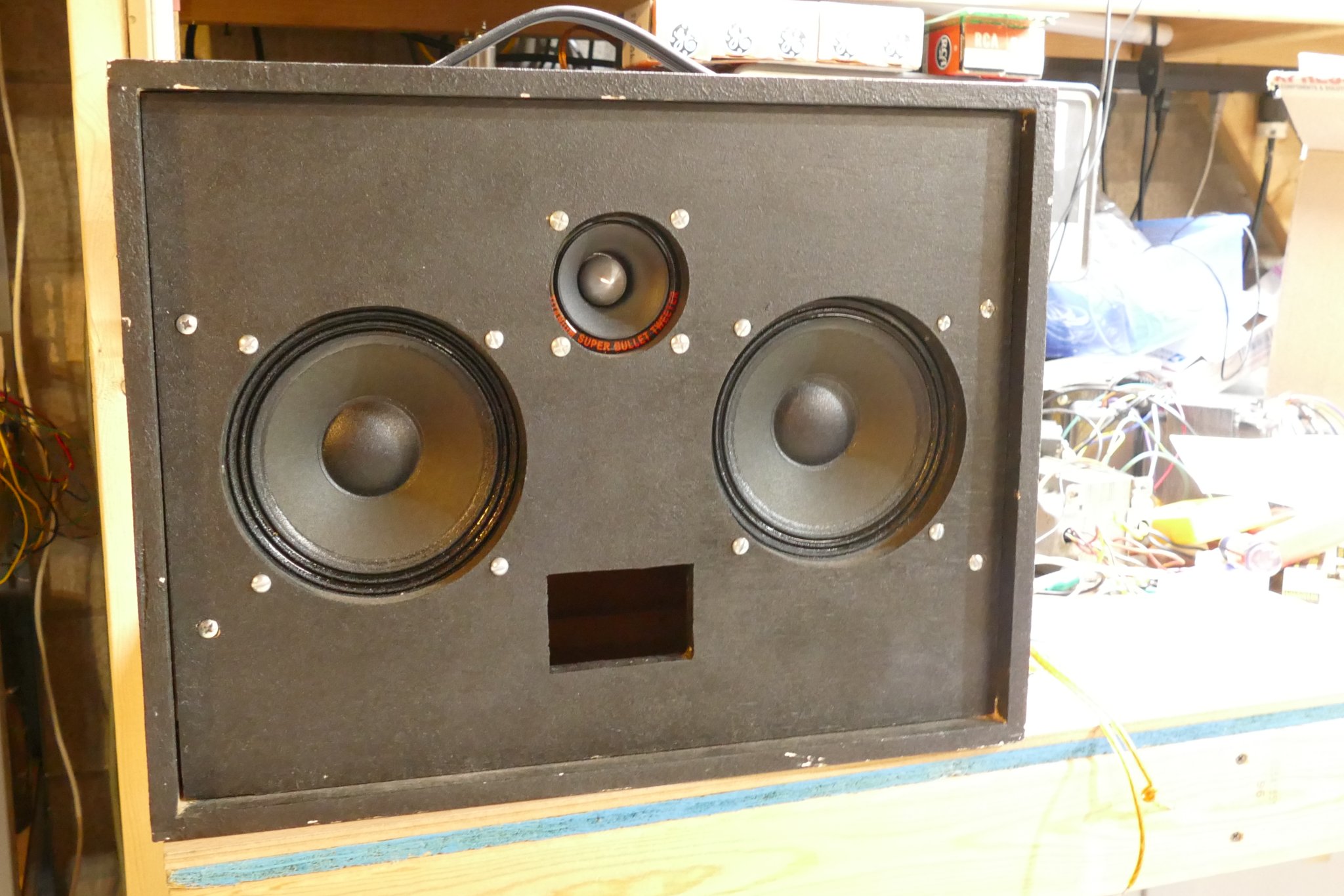

I made a pair of portable cabinets from wood that was "too thin for speaker cabinets." There are a pair of Dayton PA 165-8 drivers plus a "super bullet" tweeter. The PA165 is cheap, almost impossible to kill, and has an 80 Hz resonance. I tuned the cabinet for 70 Hz and wound up with a pair of speakers that work well for guitar even at really LOUD volume levels. They DO NOT LIKE the bass guitar even at low volumes.

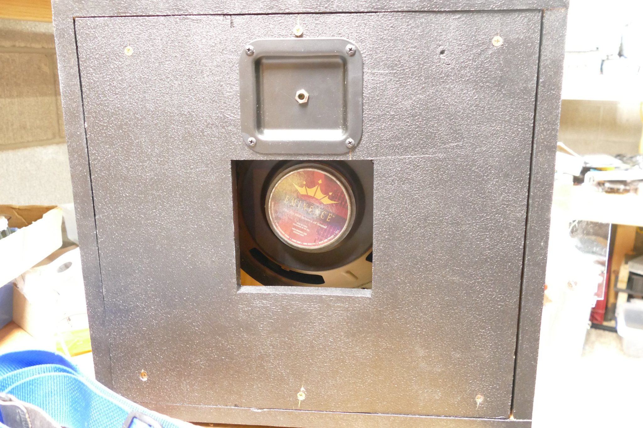

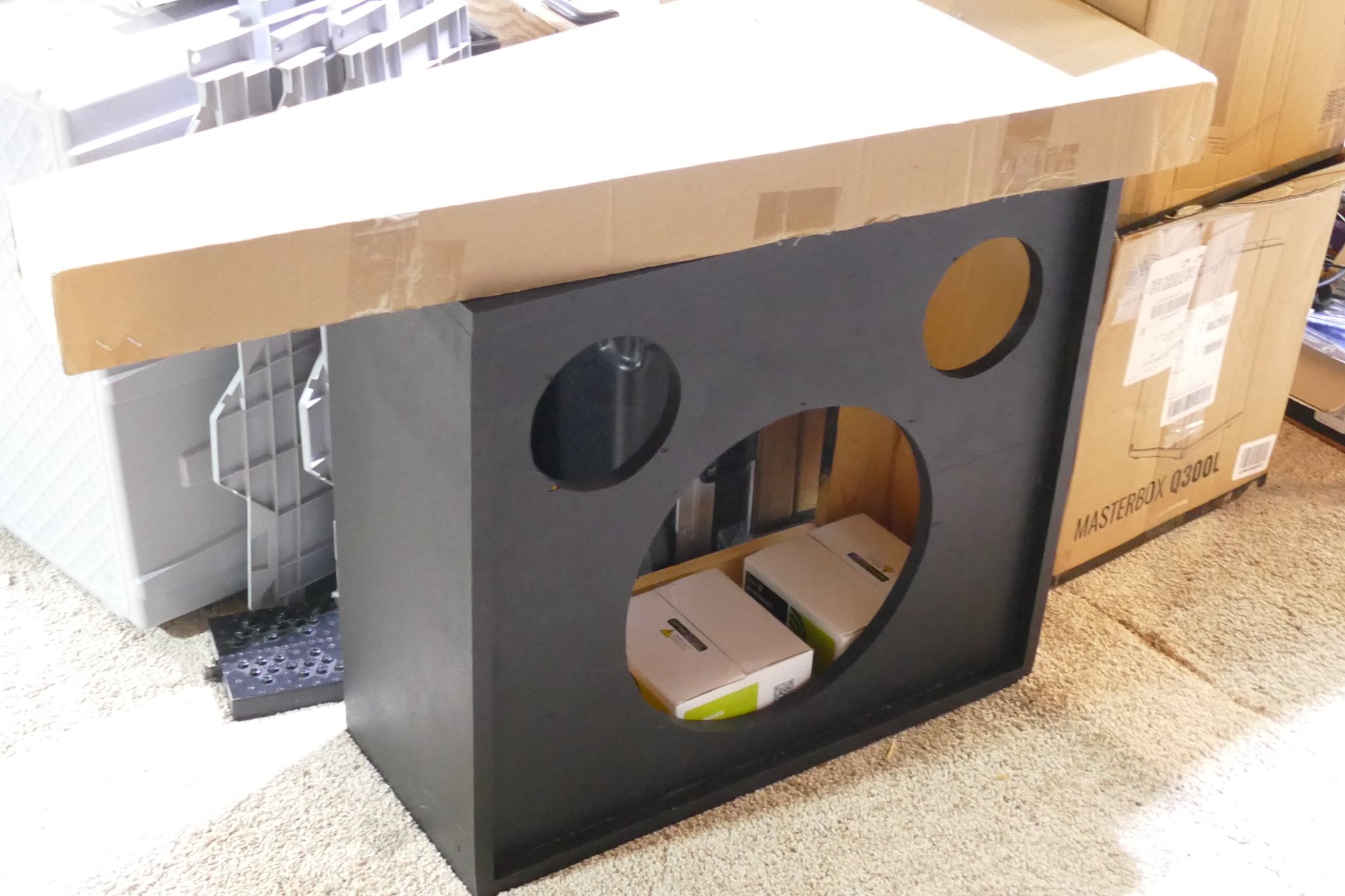

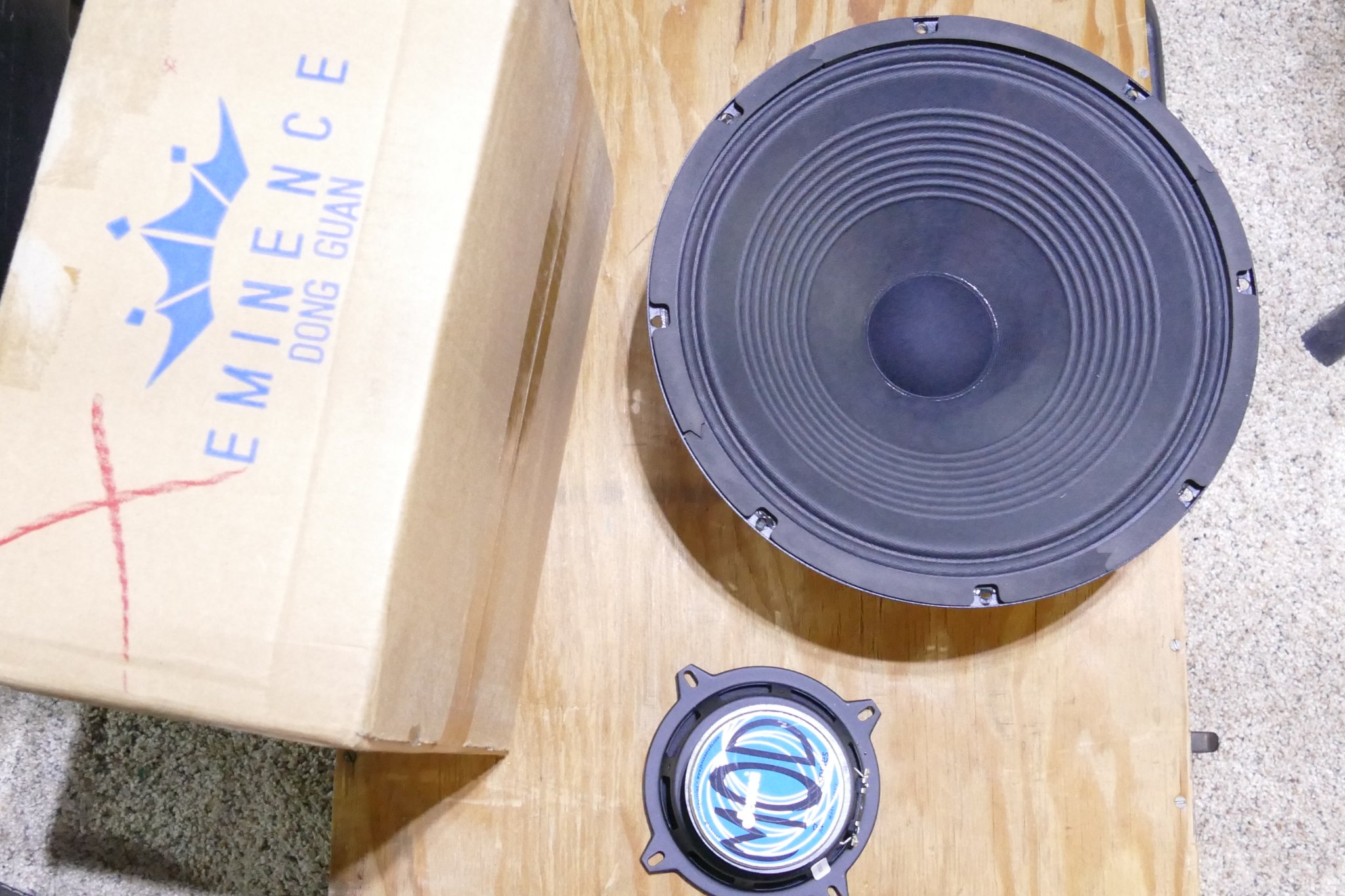

Many years ago I grabbed a pair of "12 inch Eminence guitar speakers" from a closeout sale at Parts Express. I stuck one of them in a box I made whose size was chosen to be the largest box I could make from a given pile of plywood left over from a nearby construction job. The back is partially open, again the opening is determined by the size of the wood scraps used to make the box. The front and back panels are made from glued together scraps. The seam line is visible in the back as are the cracks running from the screw holes. This thing has a real nice full bodied sound with my 1970 vintage Univox branded Mostite clone guitar. It will als do a decent job with the bass guitar at basement friendly volume levels. It eats the 20 watt amp sitting on top of it at full tilt with a bass with no poping or undue distortion.
The "bridge too far" cabinet sits on the floor unfinished, since it tried to kill me. I was sitting on the bench of a wooden picnic table in the driveway painting the black "liquid Tolex" onto the cabinet when the bench broke dropping me over backwards onto the asphalt. I caught the remainder of the broken wood support right in a sensitive spot between my legs before smashing my head on the pavement. I have had blood in my urine ever since this incident last summer. This has started a chain reaction of invasive medical tests with two doctors convinced that I have prostate or blader cancer, though none of the tests have found anything. If it ever gets finished, the big hole gets an Eminence 15 inch PA speaker and the small holes get a pair of Dayton PA 165-8 drivers seen inside the cabinet. A big tube or hybrid amp is in the works to drive this thing fully bi-amped. I have a TI TPA3255EVM evaluation kit. It is a class D "chip amp" capable of putting 400 watts into that 15 inch Eminence at 1% THD. The HF channel will use sweep tubes.

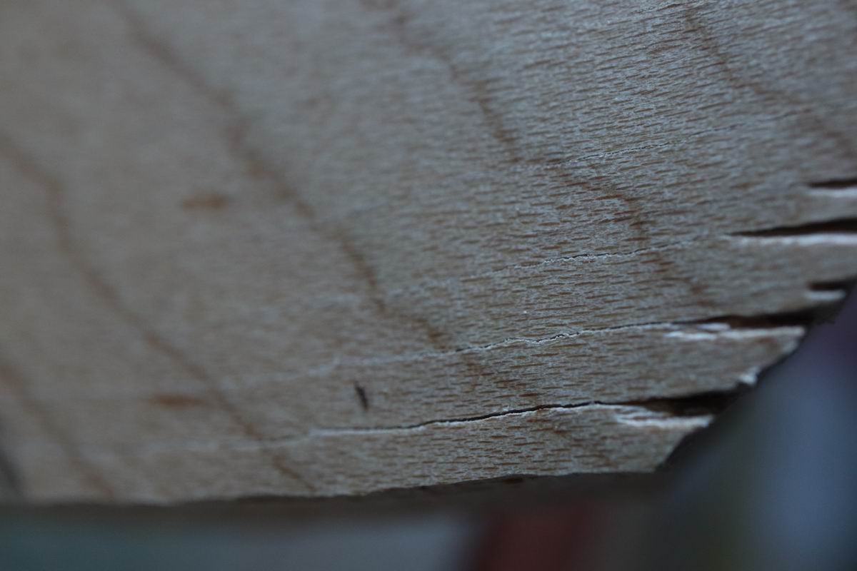

Whilst waiting for ... enthusiasm/strenght/time/whatever, maybe a good table saw, I started working on the guitar and ...almost ruined the headstock. The electric saw I borrowed came with just one blade for boards, so I made an attempt to shape the headstock with my router and that didn't go well. I've tried to squeeze glue into the cracks and have another emergency fix, but still, that ruined my elegantly planned shape.
