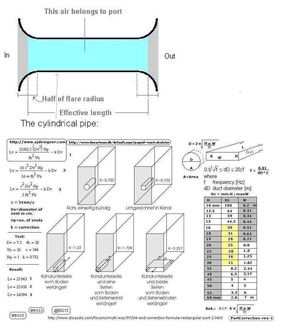

Reasonable port size and length is easy to figure out.

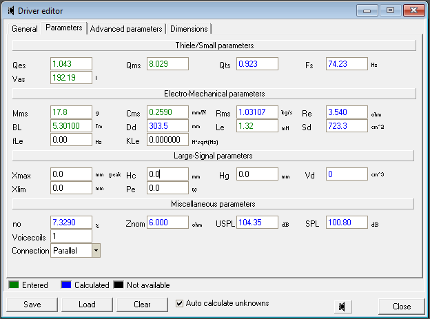

Green entered , Blue auto calculated.
Auto calculated on purpose to double check sheet provided.
They match correctly, but there seems to be questionable values.

.........or max flat in a faux corner built-in a very rigidly/massively constructed room. 😒In fact, about the only configuration that makes sense is an open baffle.

The data is not correct
Nobody would manufacture a driver as shown.
Curious if it was damaged or overheated or whatever surround material it has
If treated cloth it may have hardened.
Wild guessing of course but something will explain the odd data.

use 2x 3" or 2.5" round ports and calculate length and your done.
Velocity would be fine for its actual linear range.
If trying to make a slot port then the error factors with sharing walls
need to apply.

While I agree in principal, but having seen some pretty weird spec'd drivers for a variety of specialty apps; till we know more about what it was designed for I'm not inclined to dispute it, though fully aware from reading many BB/net forum threads/postings and witnessed incorrectly measured specs over the last ~ 6 decades, I know there's plenty of room for minor errors to turn them into floobydust.
Indeed, the Sd suggests a 15" driver (or very close) but the moving mass is only 17 grams? That really doesn't sound right.
Yes and 75 Hz for Fs would be rather poor 15"
With such high Qts

It's probably what WhiteDragon says, since I made the measurements of the T/S parameters at home following a YouTube video (
), and I couldn't follow it completely, since it does not have the same materials.
The speaker is a Thonet & Vander model Laut BT. It is the subwoofer of the system. My intentions were to be able to get better performance out of it, putting it in a larger box. Now I don't know what to do, because if my T/S measurements are wrong, I won't be able to do the enclosure calculations, neither for this subwoofer, nor for any of my other woofers.
Any recommendations to be able to measure the parameters in a better way?
