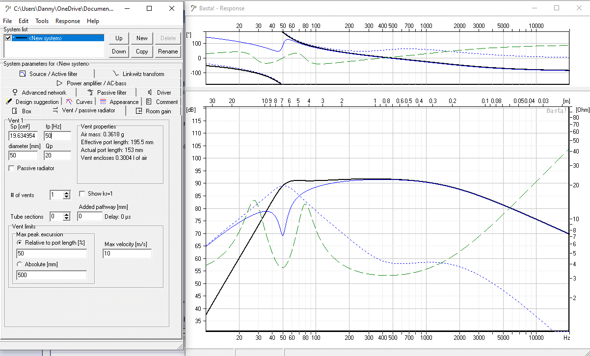

I like Basta! for volume/bass reflex simulation.
Use the serial number D4E5-EEA9-A5CE-8BD0 to get it started.
Here's a sim for your RS150 in a 12 liter box, Basta params from loudspeakerdatabase
Good vent area [Av] rule-of-thumb [ROT] for all but really low [Vas] and/or high [Xmax] driver alignments is [Sd]/3 and the others [Sd]/2 up to [Sd] where better to morph the box, vent volume [Vb] into a [folded] inverse tapered TL [TQWT].
URL="http://www.loudspeakerdatabase.com/Dayton/RS150"]loudspeakerdatabase[/URL]
FWIW, this is for the 4 ohm version, which has a bit different specs than the 8 ohm linked in the OP's post, though turns out it only changes its efficiency a minor amount.
Also, I've found enough [major] errors there to not use it after the last one had a [Sd] = 1.0 cm^2!, so instead search for whatever factory and/or measured specs I can find.
