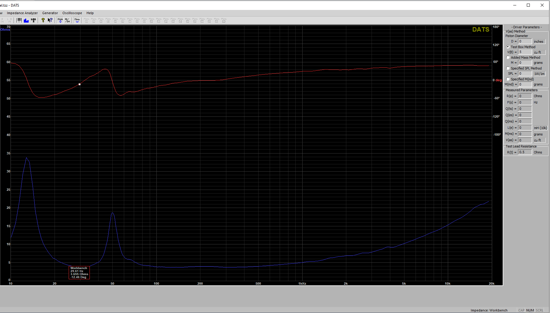

I would like to ask for help with the sound of a bass reflex.
There is something that does not convince me and many other people, there seems to be something "dirty" in the system response.
I believe there is some resonance, and I would like to ask you for help in identifying and I hope to solve the problem.
The bass is inserted in a 3-way system, is used up to about 500Hz and has 2 woofers.
The speakers used are 416-8B GPA and the cabinet, as you can see from the picture, I think I am right in saying that it is very hard.
The front is 40mm (beech) and the rest 30mm (birch)
the interior was filled with polyester fiber, obviously without saturating the internal volume.
Also you can see from the impedance curve, currently the system is tuned to 35hz.
We made a 25hz attempt, the overall response improved, but the "confusion" in the sound is there.
Thanks a lot for any help you can give me.

I doubt that the "dirty"/"confused" sound has anything to do with the venting. (..subjective responses like this usually are from problems higher in frequency.)
It looks like the the port has to much fiber near it - with that extended impedance "shelf" below 20 Hz.
I'd also make sure that the coupling between driver and baffle was physically secure and air-tight (..though the driver's resonance doesn't look bad, but it does look substantially suppressed in magnitude, again - typically the result of to much "fill"/fiber).

OK, I'm the only one that sees a problem in the impedance graph? Too many irregularities? It is just a bad measure/methodology or it is a valid impedance? If the latter the speaker is full of vibrations or other problems. Can I see an impedance graph of a standalone driver?

Bumps are either driver resonances or box resonances. What doe the speaker impedance of a bare drive rlook like given the same measurement kit?

Hmm, based on published specs and assuming only minimal series resistance for wiring, the cab is ~0.7 Qtc sealed sized in Hornresp, so vented is under-damped to the point where it's a good size for a single driver tuned to Fs and for best overall response, use the pioneer's [2*Vas/1.44] = Vb tuned to Fs.
For now, stuff the vents to get a ~46 Hz single impedance peak.

What GM says. I'd also point out you're running a 50ohm Y axis on a logarithmic scale, which may visually emphasise resonances at lower impedance levels. Shift the visual over to 50ohm with a linear scaling & see what you think then.

It appears that Francesco measured only 1 ( of 2 ) woofers present in the box ( with the 2nd woofer flapping in the breeze, so-to-speak, >> acting as a mechanical microphone ).
That's a sure way to get some unreliable/// hard-to-dissect results.
Ah, second woofer acting as another "vent"/passive-radiator. That explains the < 20 Hz irregularity in impedance.
(..the un-connected driver acting as a passive-radiator could result in a "dirty" sound: with too much excursion and it's surround causing audible problems.)
Still, the driver's resonance in-box has a very low magnitude for its Qe - almost always the result of to much "fill". (..the "peak" of the driver's resonance should be closer to 40 ohms at a minimum.)

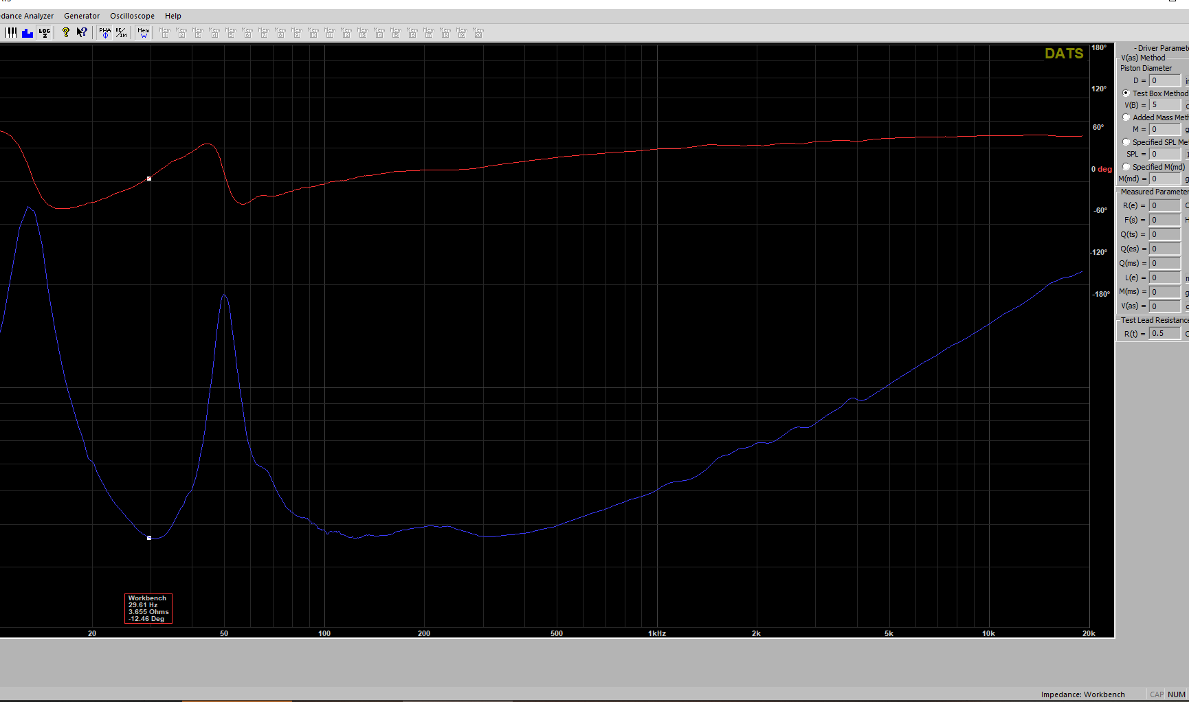

Wrong measure
Oops, sorry!
What a stupid measure I had done. 😱
Tonight I will do it again with the parallel connection of the two woofers, and using the linear scale.
However, the "dirty / confused" sound sensation is there; with the two woofers connected (certainly) in parallel.

The impedance curve looks more healthy now. I think the bumpiness might just be the lack of smoothing, though I have no idea what functions the DATS software has on that field.
It looks like first gen DATS software doesn't it? "DATS" in the title bar and not DATS v2 or v3. 🙂
