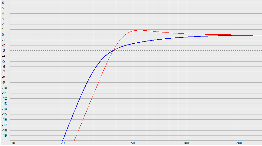

I'm in the process of constructing a 3-way floorstanding speakers with a tweeter, mid driver and two 6,5" woofers each (low to mid crossed at around 350-400Hz). I'm aiming to tune the box at 43Hz which using WinISD gives me about 20,5cm lenght of the port with 10cm width at 45L inner box volume. When taking away 18mm thickness of mdf panel which this port will be mounted in it gives me roughly 19cm of the port lenght inside the enclosure. Port is made of 2mm thick PVC pipe.
Therefore my question is, do you think at that lenght (and width) the port inside the enclosure might have some unwanted vibations at higher levels? Is the port too long to be just on it's own without any additional support i.e. some sort of bracing for the port itself to stop any potential vibrations? I'm guessing it wouldn't hurt it but is it necessary as it would obviously take extra work and additionally take away the enclosure's inner volume which I've not accounted for?
Or are the vibrations I am concerned about simply a "first port resonance" which WinISD is showing at above 700Hz (I don't remember exactly as I don't have my laptop with me atm)? If that's the case then I don't think I should worry as the woofers shouldn't be having much output above 500-600Hz given the ~350-400Hz Xover point...

No worries. Although you possibly could do with a 7cm wide port, a 10cm wide and 19cm long one won’t resonate much. The port resonance is there though, but as you point out, it’s outside the passband of the woofers. Still, you ought to check the result with a port measurement.
Thanks for your input markbakk!
I was originally thinking about using 7cm port, however the air velocity of the port would be close to 30m/s at maximum power of 60W which would most likely create port noise and even with flared ends I think that's still risky. Even at half the power air velocity would be at 21m/s. The 10cm one is at air velocity of 15m/s at max power so I don't think it will even need any flared ends... But obviously bigger the diameter longer the port needs to be and that's where my original concern comes from.
Unfortunately, at least here in UK, it is tricky (if not impossible) to find any other port sizes between 7cm and 10cm range so it's either 7cm or a jump all the way to 10cm. I am looking around on the web for PVC pipes in sizes between the two and I think I managed to find one at around 8.3cm inner diameter. If I choose to use that one it will give me (at max power) 21m/s port air velocity.
As I understand the general rule of thumb for the air velocity's limit (chuffing free) is at around 17m/s, is that correct? Therefore would I need to flare the ends to avoid a port noise at 21m/s? Would a flare at just one end be enough?

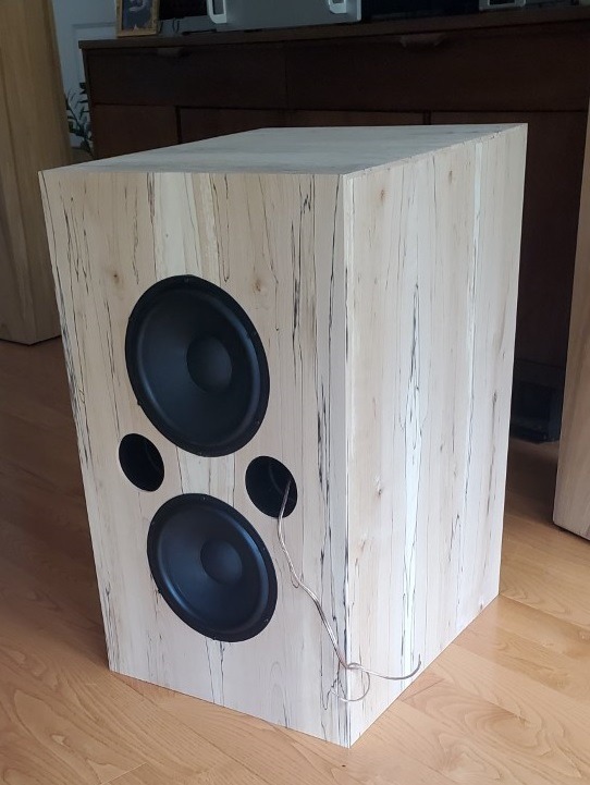

Thanks Dave,
I've considered the slot port initially but as this is my first build I've opted for the round/ tube port as once I would commit to certain slot size built in to the enclosure I wouldn't be able to change it without major work to be done to the construction of the box. With the pvc tube there's usually much easier way to change the dimensions (at least the lenght). Also as my enclosure is at slightly above 100cm in hight there might be an issue of standing waves creating inside the box, therefore if I'd place the slot at the bottom of the box (only practical way I see doing it) I wouldn't be able to place any damping material at the bottom to try and mitigate it.
That is why I chose to go with the round pvc port placed at the back at around 1/4 to 1/3 of the hight of the speaker (from the bottom) to give me the best chances to make any adjustments if needed.
