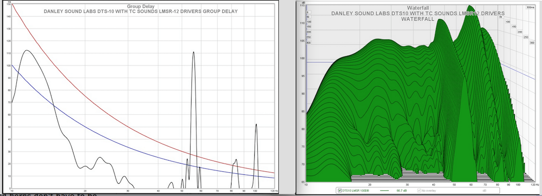

"Ringing" or "energy storage" can be seen in waterfall and group delay response plots, Josh Ricci's Data-Bass makes it possible to compare different designs (thanks Josh!):
https://data-bass.com/#/systems?_k=vhj336
Subjectively, most can't hear group delay with time lengths of less than 1 to 1.5 cycles, though some claim to.
An example of upper ringing is obvious in the DSL DTS10 tapped horn (useful response to ~13Hz), at 55Hz one cycle is 18ms, but the group delay is 110ms, six times longer :
The waterfall chart shows the "ringing" persisting at about -20dB at 300ms.

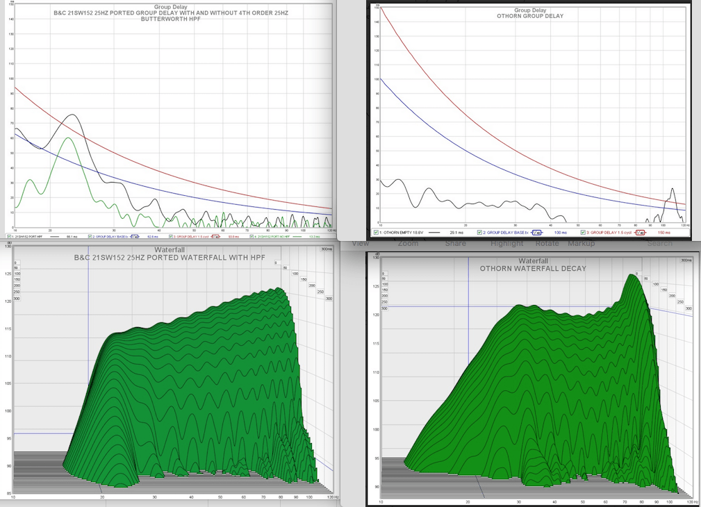

Tapped horns are not all that bad, Josh Ricci's Othorn TH has virtually no ringing other than at 107Hz, which drops by -30dB at 100ms.
The Othhorn and his BR 25Hz FB cabinet both using the B&C 21SW152-4 compared:

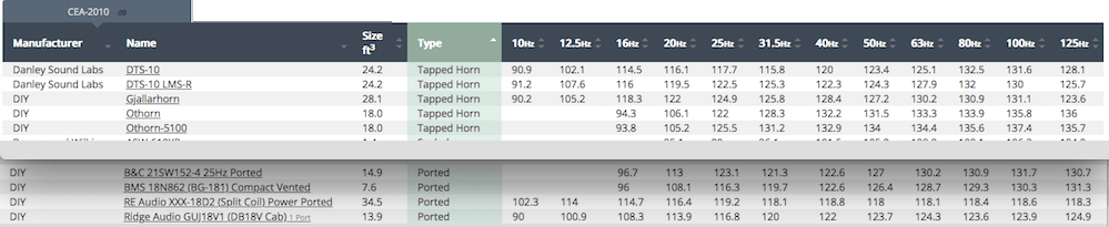

The CEA-2010 testing involves probing the short term dynamic output limitations of a speaker within defined distortion limits.
This test makes it possible to compare the usable "clean" output of systems:
Really good drivers like the B&C 21SW152-4 can do well in either BR or TH at extreme levels.

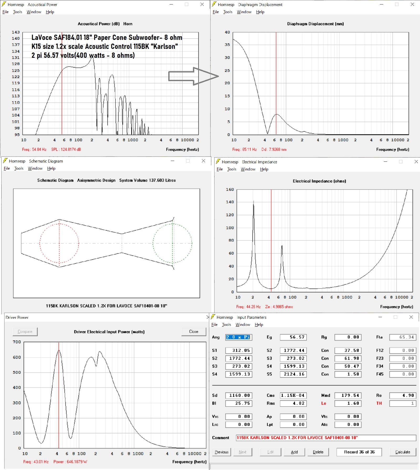

Art and folks - how does CUBO18 do ?
https://freespeakerplans.com/plans/14-plans/basscab/11-cubo-18
for those in the US - Madisound has a good looking LaVoce 18 for $149 - Re is kinda low for running two in parallel
https://www.madisoundspeakerstore.com/special-sale/lavoce-saf184.01-18-paper-cone-subwoofer-8-ohm/
stored energy - yeah a bit but would be fun for me

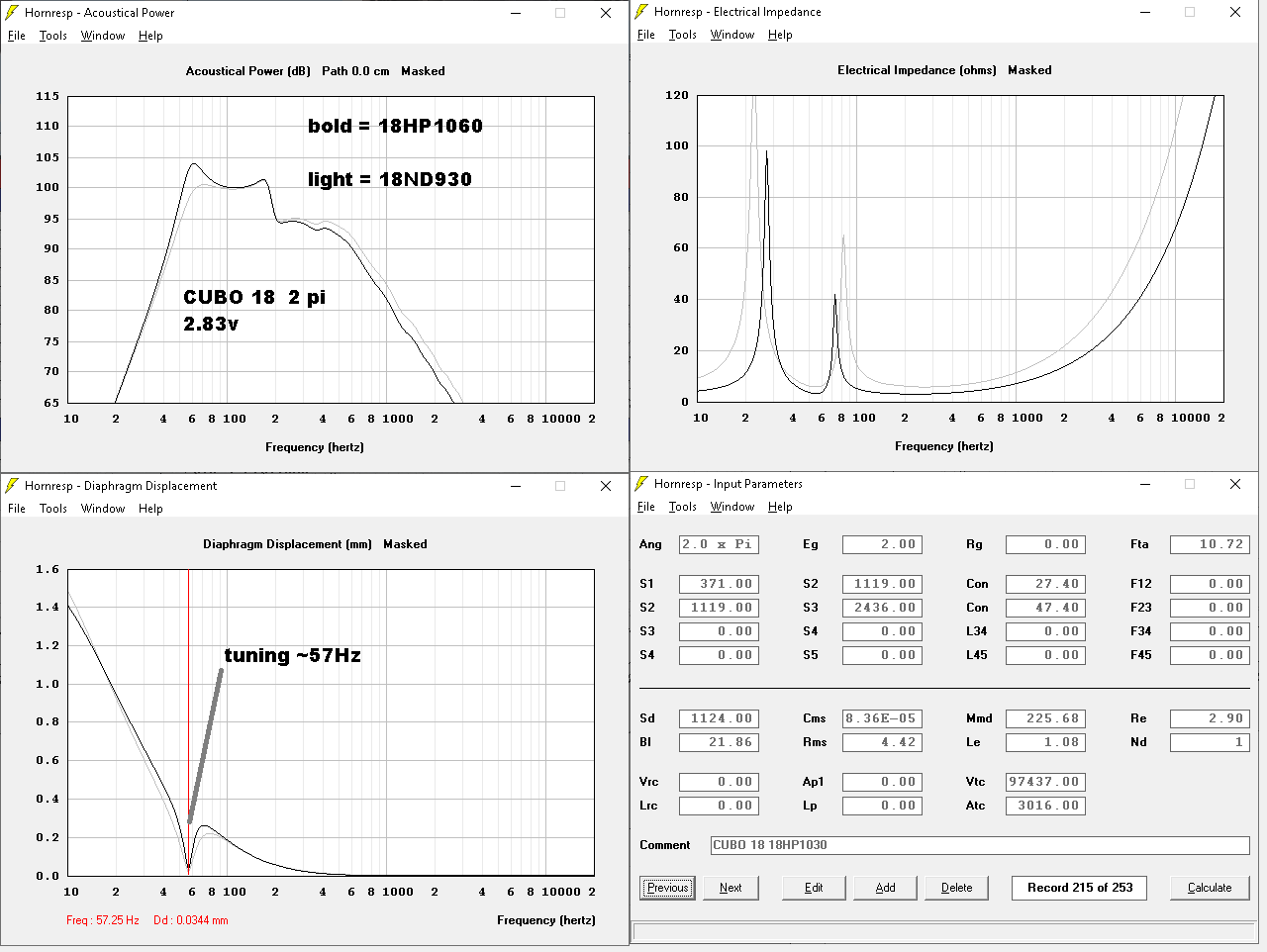

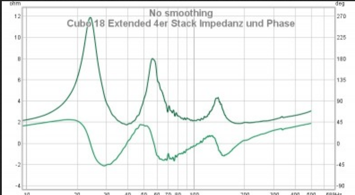

FWIW -
Here's a video with dims for the CUBO 18 and CUBO 18 extend versions:
There might be another 18 version (?) - I did a sim some years back on the standard and IF the input was good showed it tuned
to ~57Hz -??
maybe my sim is bad ? - What did Brian Steele get ?
here's a Z-plot for an extended version
to ~57Hz -??
