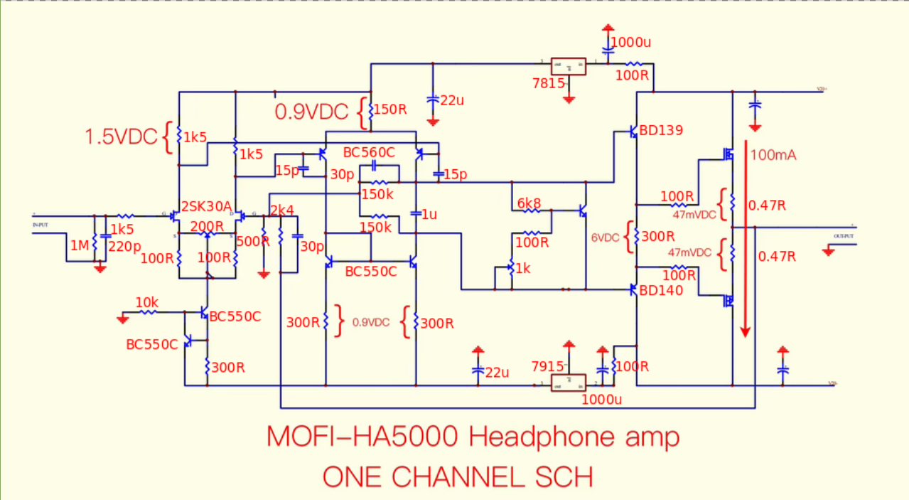

The circuit is a Chinese knock off of the AT HA-5000, which is in turn based on the Hitachi mosfet power amp. I rather like the Hitachi mosfet power amp but have never tried it with headphones. I suspect that from a purely engineering standpoint the BD139/BD140 (STI) might give lower distortion because of the higher hfe, despite the lower ft ( probably around 4-10Mhz).

It’s not “low”, it’s just not 190 MHz anymore. 50+ depending on who made it or when. MJE243 is about 40 MHz. But BD139’s (even ST or Fairchild) are free from quasi-saturation (beta falling drastically at low Vce) and on a low voltage power supply, that’s worth something. And MJE243’s beta falls at both low and high current, and BD139 only falls at high current. That’s worth something too.
Yes, you may very well do that. For prototypes, breadboards, general experimenting. But when building something intended to be permanent I tend to pick parts based on their technical merits and then leave it alone. Eventually you lift the pads off the board jacking with things. Or fry something unrelated that you have to go back and fix. The set of “technical merits” MAY include such things as preference based on early experiments or other experience, or using what’s on hand instead of buying something else. Both perfectly valid. But on the other 3 parameters being compared here - fT, SOA, and beta linearity, BD139 is a hands down winner in this application. No it doesn’t win on SOA, but on this voltage no one could ever care.

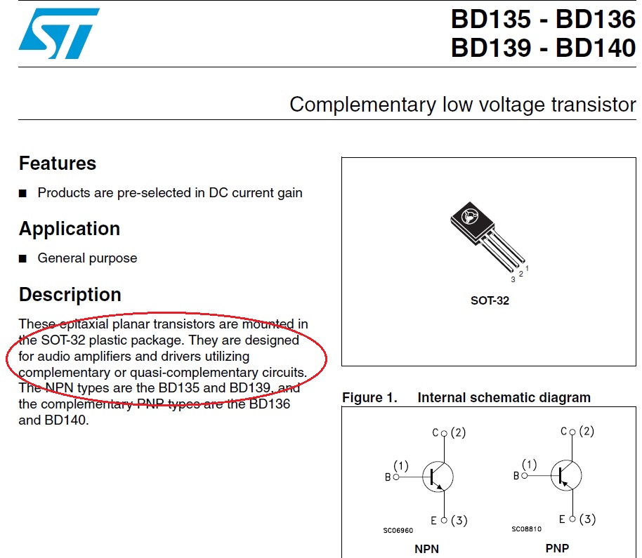

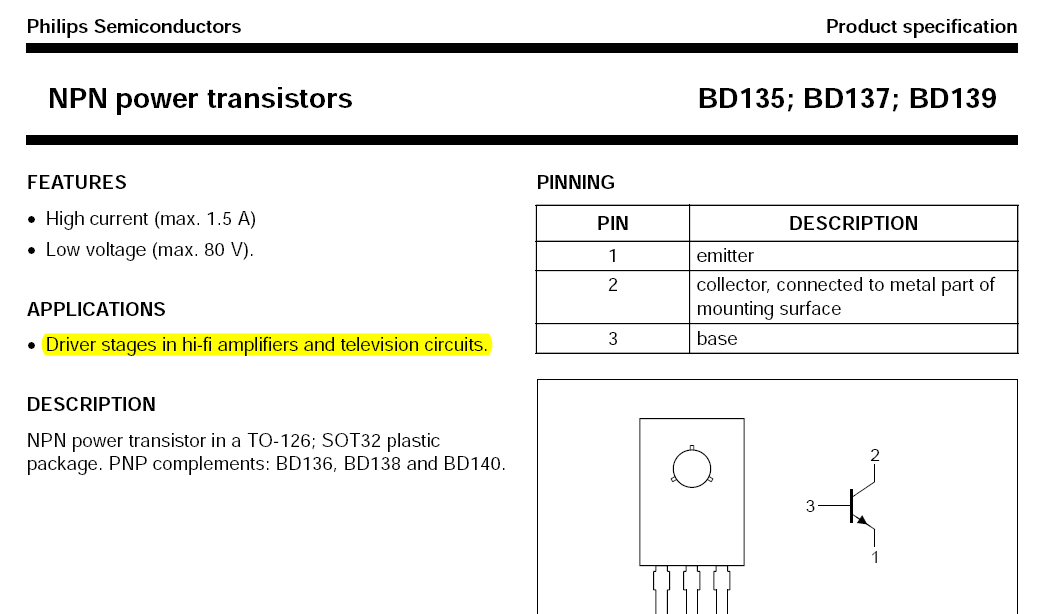

Would you think the datasheet is wrong?BD139/BD140 are no audio transistors.
Hmm... deployed in tens of thousands of audio units over decades in my observation.BD139/BD140 are no audio transistors.
