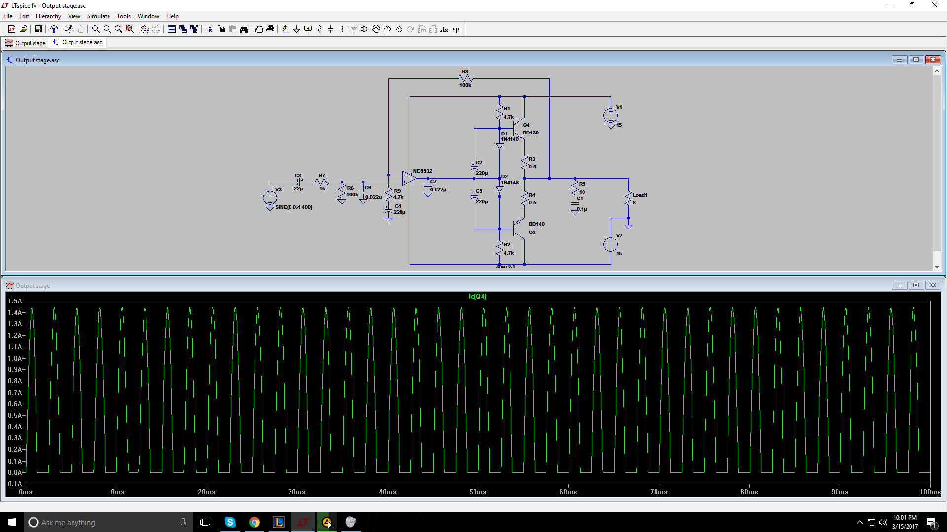

Hi, what is the SOA of these transistors , if I parrallel two of them ( 4 per channel ) how much power can I obtain in 4 ohms - 6 ohms , My friend has two nice speakers(6ohm rated at 25w rms , 5.25 inch driver ) and he wants to use them on his laptop , and he needs an amp ... he doesnt want ic ' based amps . Something around +-15 v to +- 18 v rails. Thanks
Not quite enough IMHO. With 4 ohms from ~14Vpk you're looking at >3 amps peak, and one BD139/140 is just 1.5 amps with a following wind. Better use some "proper" power transistors.
You can work out the power from the data sheet; http://www.st.com/content/ccc/resou...df/jcr:content/translations/en.CD00001225.pdf
It really depends how you use them and in what class.
If I apply my usual guide where maximum output power from the 2pair output stage is given by :
Pout = total Pmax / 5 = 12.5*4 / 5 = 10W
10W into 4ohms is equivalent to 6.3Vac and 8.9Vpk and would run on supply rails of ~ +-12Vdc to 15Vdc.
But I think they may struggle to meet the peak current demand of HF transients into that low a load. It may be better to try 8ohms speakers first (on +-18Vdc supplies) and see how they behave.

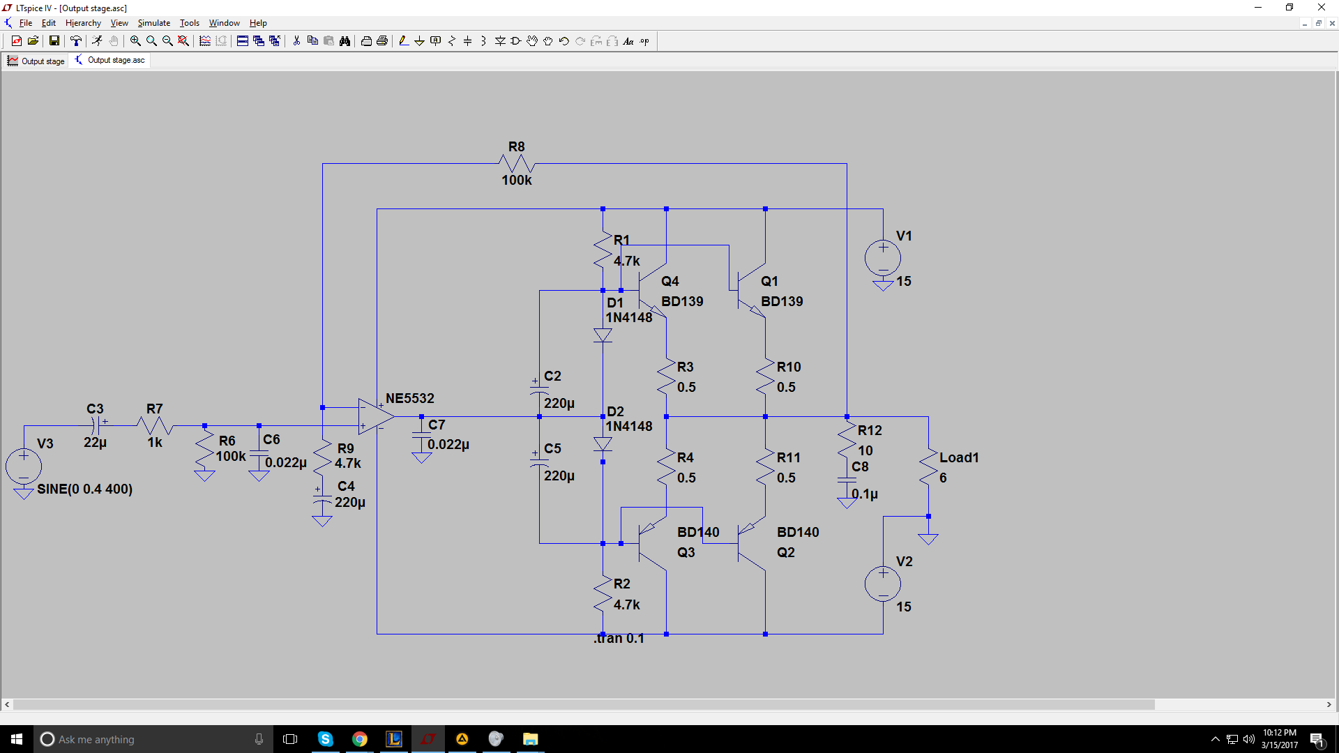

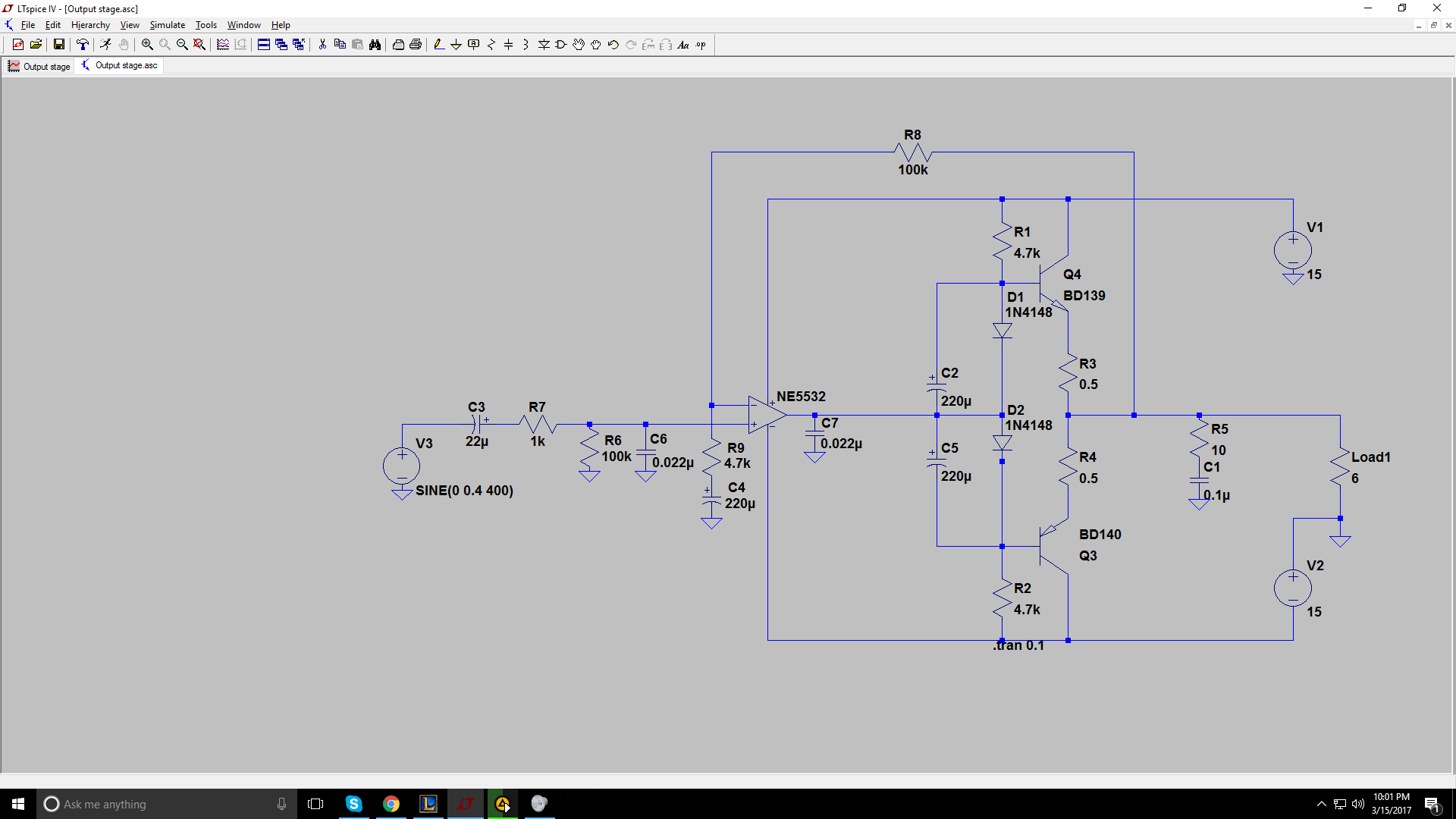

Also would I need some pre drivers for them ? I want to use an op amp and after it the BD's ( used this schematic before and it worked fine , with bigger transistors )
Hi xXBrunoXx,
Why not change to the MJE series parts (like MJE15031 and it's complement) for the outputs and use the BD139/140 as drivers. That would make up a nice amplifier for your needs, and reliable. An op amp could reliably drive those transistors, but use an NE5532 or NE5534 (x2) or equivalent. TL071 /TL072 have very low output drive, so they are out.

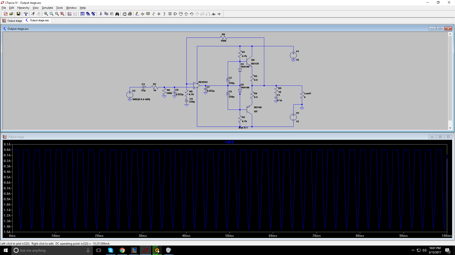

Why are you running the bias so high? Anything between 10 and 20 mA would work every bit as well. Your schematic didn't post, it would be nice to see what you are looking at.

I think you might be asking a bit much from the BD139/140 outputs. Peak currents could kill that pair. You could try TIP102 / TIP107. Those are darlington transistors in a TO-220 case. Remember that the op amp have to supply whatever the output current is divided by the transistor beta. The other choice would be to use the BD139/140 as drivers, and something like the MJE15028 and MJE15029 (good for 8 amperes). OF course, you can also go to a more robust output as well. You need to double your bias diode string, but I would rather see a real bias Vbe multiplier in there. This drops the current requirement from the NE5532 to reasonable levels, which has got to sound better.
Keep in mind that many internet schematics do not include capacitors for stability or even reasonable bias networks. Circuits that simulate well often do not perform as expected unless realistic current levels and supply impedances are used.

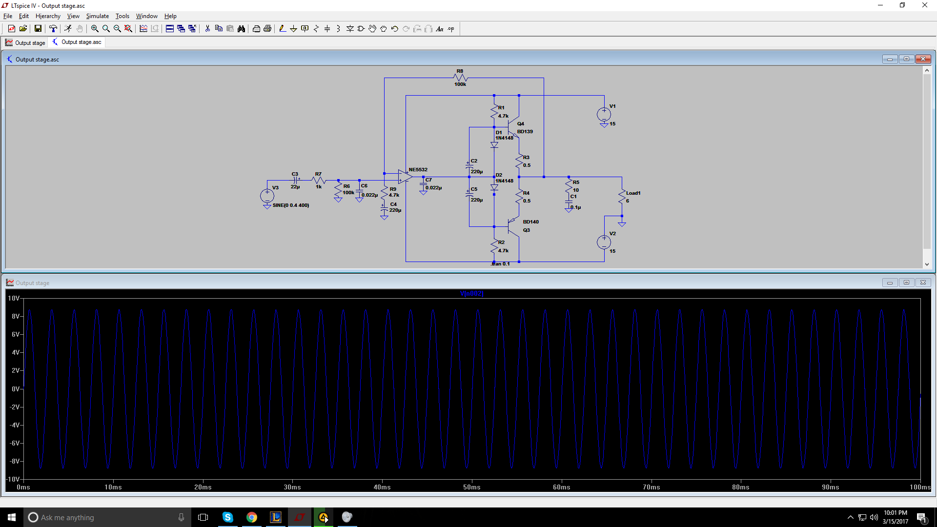

I have done the same schematic with M5220 ( +-25v op amp 10v slew rate ) and TIP 142 / TIP 147 with a big 20.5 - 0 - 20.5 ( 20.5 after bridge rectifier and supply caps 6800uf ) transformer 8A per rail + 6800uF. And after 11 v on output it distorts. On music i get 8-9 v before clip and it draws around 1- 1.2 A per rail ( mono ) I ve seen 1.6A and it clipped, what would be the problem ?
Also tried NE5532 on the same schematic got 12V out ( in the datasheet at 600ohm load it says 32 V p-p so 15-16v output ... what you think ?
Well, your supply voltage represents the peak voltage your output signal can be. But, you have to subtract the drop across the outputs and the sag from the power supply. So a rough ballpark might be 18.5 volts X 0.7071 = 13.08 volts rms. The losses are guesstimates and might be higher than 2 volts. Then, the op amp might have run out of driving current and current limited the output. That's why another stage of current amplification might be needed. A CFP output would preserve more supply voltage since you are low on that.

You don't. Either use a 2 stage normal transistor output stage (way more flexible and faster), or an output stage using darlington transistors. The down side is that you're locked into an EF type output stage. One or the other, but not one stage of output. A darlington counts as two transistors as to how you deal with them.why do i need another stage , if the tip142 / tip147 are darlingtons
So do it that way, but no darlington transistors. It's time for you to sit back and think on this a bit. You have options, and one fact. A single stage output won't cut it in this application. and another, a single darlington transistor counts as two connected emitter-base (as in an emitter follower). So you have to make a choice. Darlingtons or two transistors following another pair. Alternatively you could go the CFP route, but I wouldn't recommend that to anyone starting out.it like bd139 - 140 and 2sc5200 - 2sc1943 ( for example ) why , do I need another pair before the darlingtones ?
