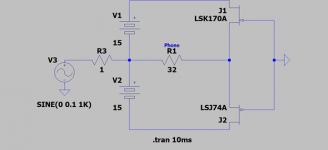

I built this...nothing special, needs more jfets

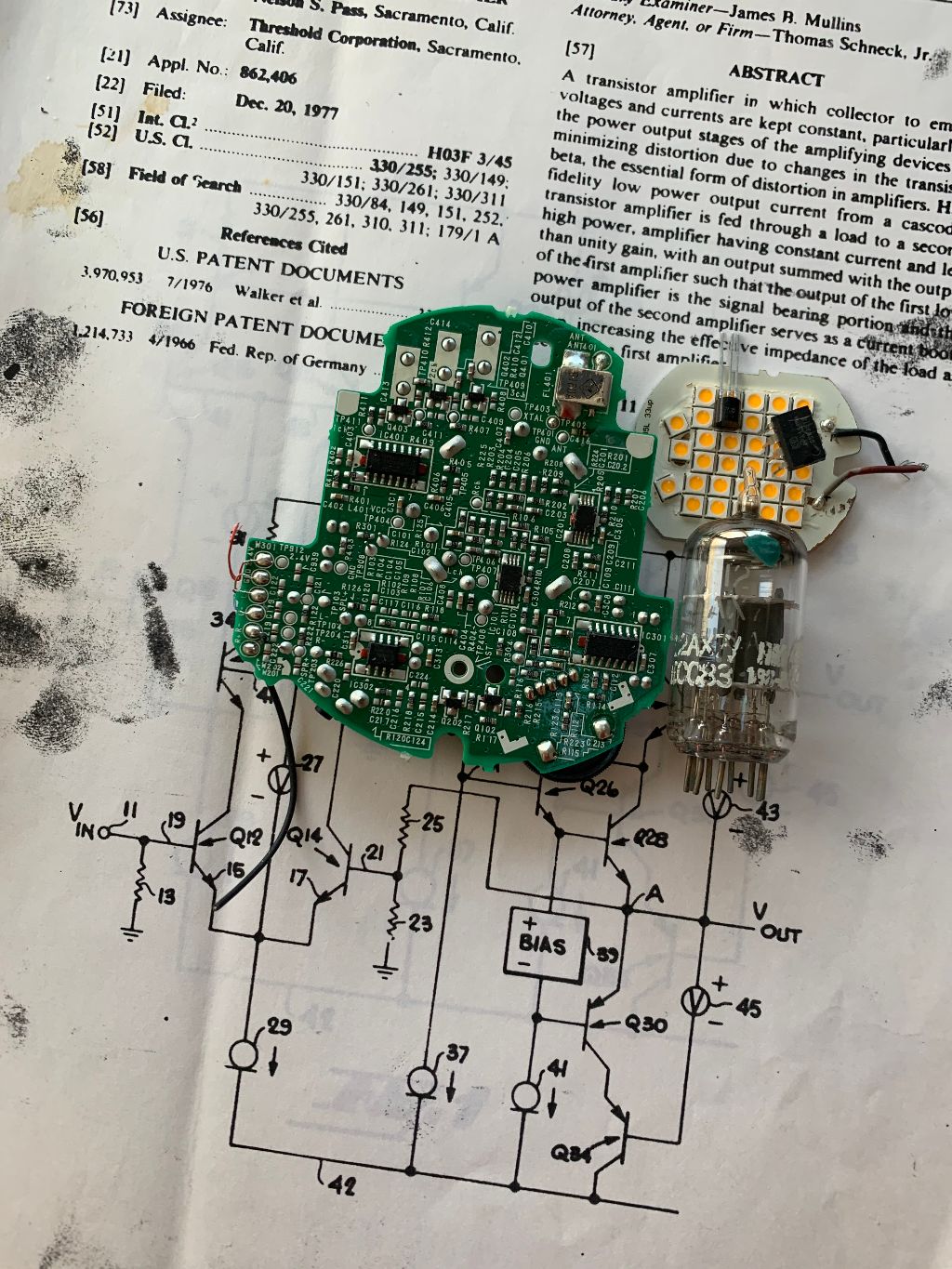

You and Mr. Fullrange are gifted with patience, focus and awareness [plus great eyesight] to assemble and solder this many SMDs. I envision a robot doing this work to produce commercial Beasts.
We've come a long way
The attached picture speaks to the progressing genius of the human race for advancing this technology and downsizing its components/systems.
The green PCB is double sided; for an [RF] SONY stereo headphones which connect to a TV for private listening. The orange-dot parts are LEDs from a spent 800 Lumens Philips household lamp.
I keep these amazing creations because I feel bad trashing them.
Best
Anton

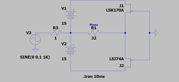

Hello adason and all,
Your JFET-style HA is also useable in reverse as I show in the attached schematic of a prototype which sounded great. This approach has another objective.
The signal generator does not deliver current to the phone. All of this current comes from the JFETs.
If the output stage of the signal generator is cascoded, this HA works like that described in the patent by Mr. Pass shown in my previous post.
Are you still using it?
Best
Anton
