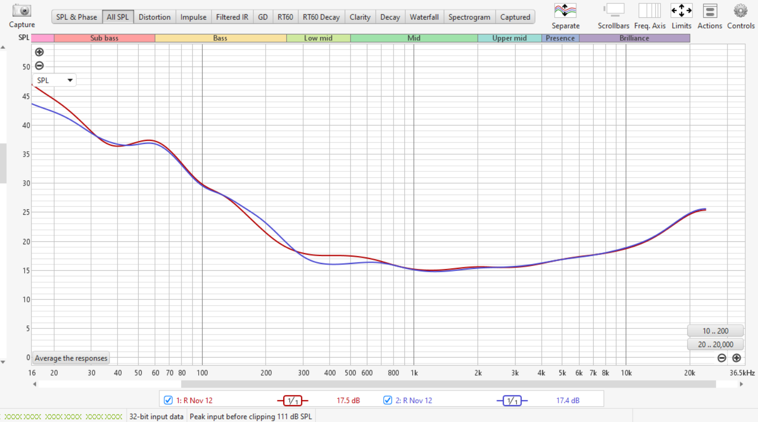

This is a UMIK-2 in my listening room. There is definitely some ambient LF noise present, but I would guess a significant percentage has to be microphone (1/f) self noise.. These measurements were taken a few minutes apart (blue is later) and are calibrated dBSpl. I generally do acoustical measurements in the 80dBSpl+ range.
I should repeat the measurement at some point with my Isemcon EMX-7150 for a sanity check.

@kevinkr Well what I see in your curve is that the noise at 20 Hz is also about 30 dB higher than at 1 kHz. This it the first time in my life I actually look at the spectrum of a (hopefully) good measurement microphone.
Looking at your curve it might be normal what I observe with my ECM8000. Really I had no idea I could expect this.

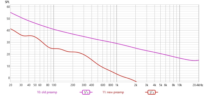

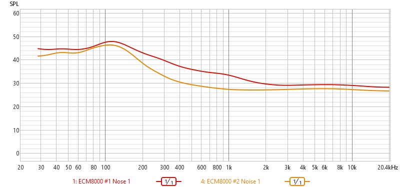

I've seen noticeable if not huge differences in self noise of my ECM8000's, I've also seen excessive noise on a malfunctioning M2010's preamp section, and your ECM's response looks kind of like the M2010's bad pre-amp. Maybe a new ECM is in order? They are going for $20 new at the moment.
Here's two of my ECM's, each level calibrated before wrapping in a plastic bag and buried in a big bucket of sand in a quiet corner of my basement.
In contrast, here's an NTi Audio M2010 with a bad pre-amp section and with a good pre-amp section.
