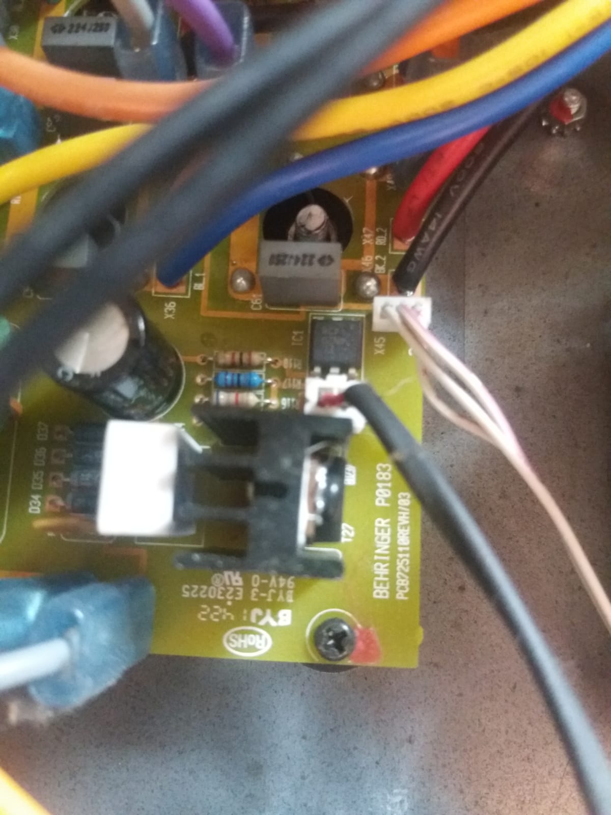

Regarding fault number one. I also recently had a QSC showing the same symptoms. I finally traced it to a high resistance pin on the socket for IC48, I think it was one of the supply pins.
That could be too - anything that reduces the op amp’s current capability. If it’s supply collapses, it can’t drive the MJE15030,15031 pair properly.

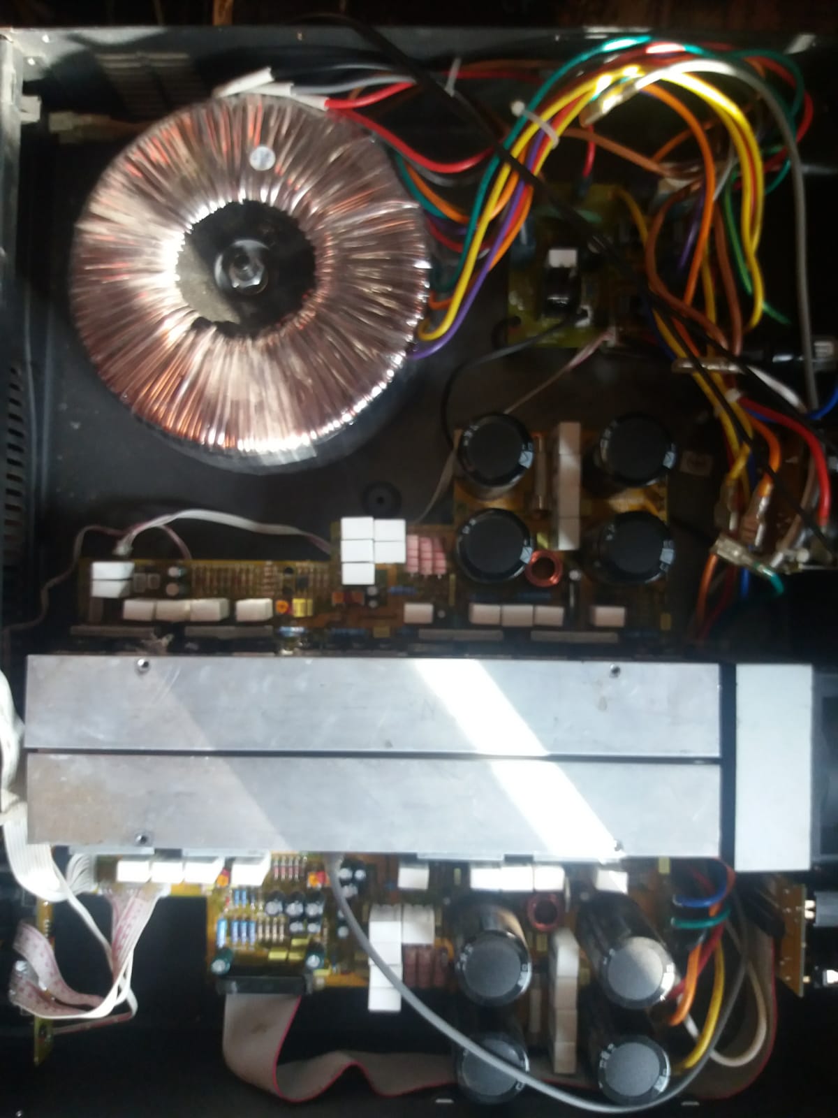

Each channel has its own independent power supply. It can’t be done from a common supply. The channels are likely labeled A and B, so they are not “volt” or “amp” labels - just to distinguish between channels.
Has anyone noticed that circuit diagram shows the main rails as 110A, 55A ?? erm...
It is normal for a class H amplifier.
It is abnormal that channel A has part of channel B on it's board (± 15V controller) and vice-versa, channel B has clipping for channel A on it's board. Difficult to isolate and work one them separately, to protect the working one, during powered tests.
If channel A fails, only channel B could work standalone. Not otherwise.

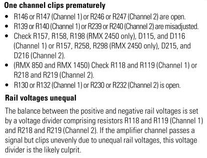

In QSC-rmx_2450 (the genuine amplifier, Behringer it's a clone) service manual I've found some recommendations for earlier clipping on this model but it's strange that they omitted the outputs condition and 0.22 ohms resistors in troubleshooting scheme.

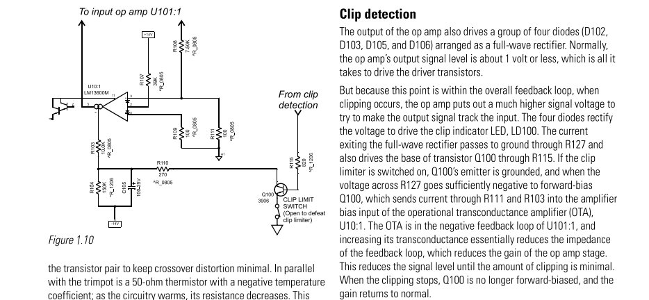

On the other hand, something is strange:
_No clipping if no load or high impedance load
_Clipping exists , no matter of DIP SW position
_clipping LED is triggered by IC4 outputs, IC4 outputs depends on (SPEAKER BUS - AFTER FUSE) -> R46-> pin 5 IC4 combined to pin 6 IC4 (gain output)
_clipping is controlled via R139->T34->IC5A but clipping no matter T34 emitter is grounded or not and the problem here is not the clipping is controlled (reducing gain) , but is "stated" / trigerred earlier
Question: Where is here - in this schematic - the comparision between output signal - positive or negative peak value reached by the monitored signal comparative to ± rails, to state a "clipping" situation ?
There is no “comparison” between input and output to detect clipping. It takes a volt or two from the op amp to get it to full output normally, which won’t turn on the “clip” LED or produce any voltage across R128. When the op amp’s output goes beyond that trying to drive T15 or T17 harder, the voltage across R128 rises indicating clipping. That activates the compressor circuit in the front end.
So, as I supposed, it is not a really clipping situation (some DC on output or high rail voltage on output etc) , seems to be a false clipping - and signal reduction is working as in real situation.
Clipping on 10W, not 1000W.
I'll do further checkings, It is still not clear to me that is a low (at clipping controller group level) or high voltage situation (at outputs level).

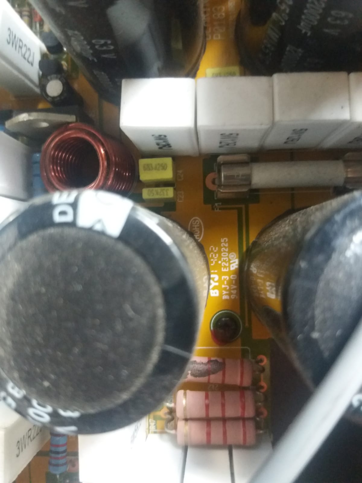

Working on it I've found all 8 emitter resistors burn. This is the reason only 10 W and clipping on output. I think this one it is a chinese Behringer, not an USA one. I'll revert with relevant pictures. A lot of difference between boards.
If all 8 emitter resistors are burnt out, are all the output transistors shorted?

The emitter resistors may be just bad quality. I have seen this before.
No, if outputs burnt - the speaker fuse should be burnt also due triac.
Fuse and outputs happily in good order. Pre-outputs and everything is on heater - ok Everything else also seems to be ok.
This is the main advantage on chinese clones - resistors are so bad that cease ahead of outputs 🙂.
It was a fortunate situation. Rare, also.

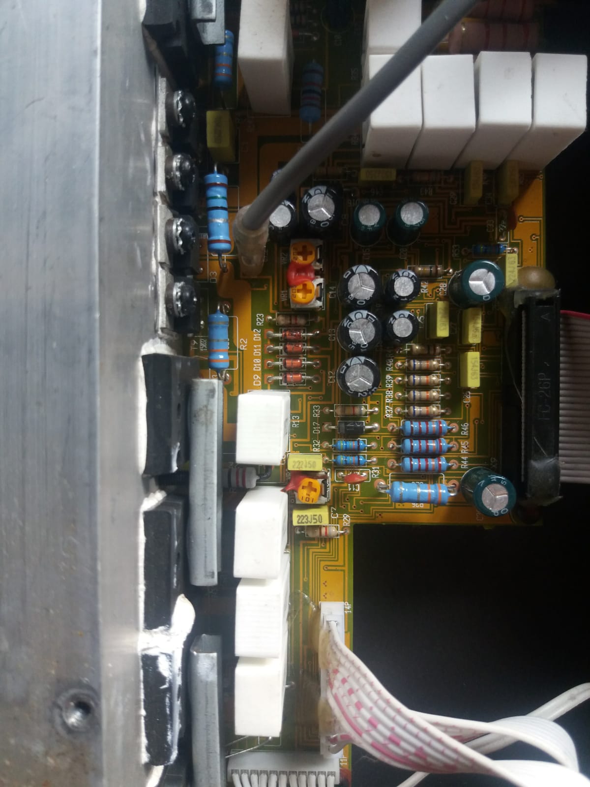

Still remain the crossover distorstion on Behringer no.2 - that gave me a lot of headache - due everythinng seems to be ok there, nothing burnt.
Fusible resistors, intended to burn out when severely overloaded.
