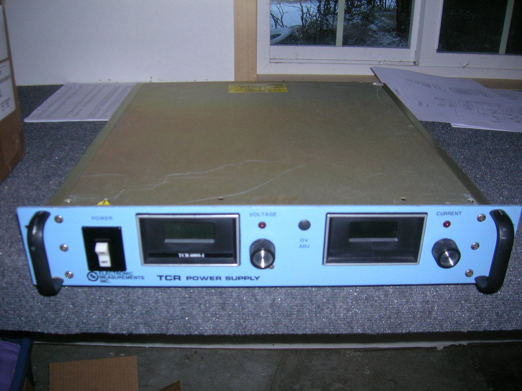

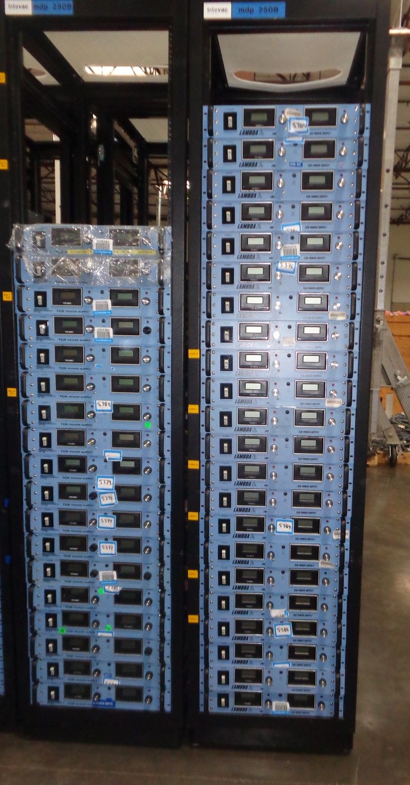

If you can get them to ship it cheaply (not express), or go pick it up yourself:
TDK Lambda EMI EMS TCR 600S1 Single Output DC Power Supply 600V 1A 600W | eBay
Says 64 lbs. Looks like they have so many of them, they will probably take most any offer. I would try like 1/2 the listed price. (the picture file name was $_57 ??? must mean something, maybe that's what they paid for them)
There is another model, EMS 600-1.6 I think, that is lighter and thinner, If you keep an eye out for it. Probably won't get it for a price anything like this one though.

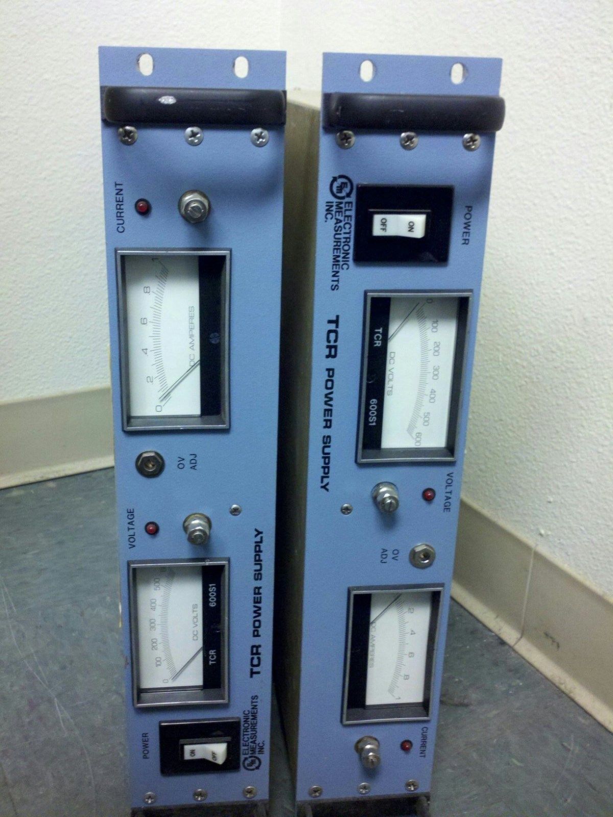

The Ebay link changed or something. Here is the current link to the TCR-600 power supply:
Hmmm, the link still doesn't work. You'll have to do a search on:
TDK-LAMBDA-EMI-EMS-TCR-600S1
Note: make sure to get them to agree to a cheaper rate shipping before ordering one!!! They're quoting like overnight delivery cost for 70 Lbs!

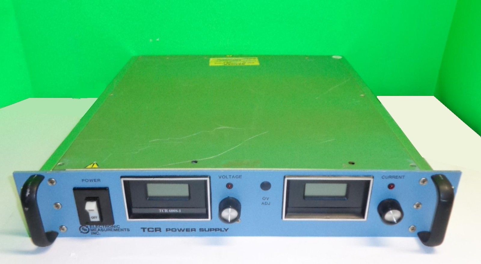

$1 now, tough to beat this one!
$60 shipping though (to here anyway). Seems to be configured as a negative 600V supply, but I think these usually are floating anyway. In any case, the manual is on line to re-configure it if necessary.
Lambda EMI TDK TCR 600S1 600V 1A Power Supply Read Description | eBay
I looked up some Heathkit 400V supplies on Epay, and they mostly start out at $200, what a rip-off! They used to be $50 or less. I was going to suggest just getting a Heath for the screen grid supply and -bias V use, but it's way cheaper to buy some fancy bench supplies.
If someone wanted to do a 1200V power supply for some Xmit'g tube, they might combine this with a +600V version. A rather unique one of a kind unit.
