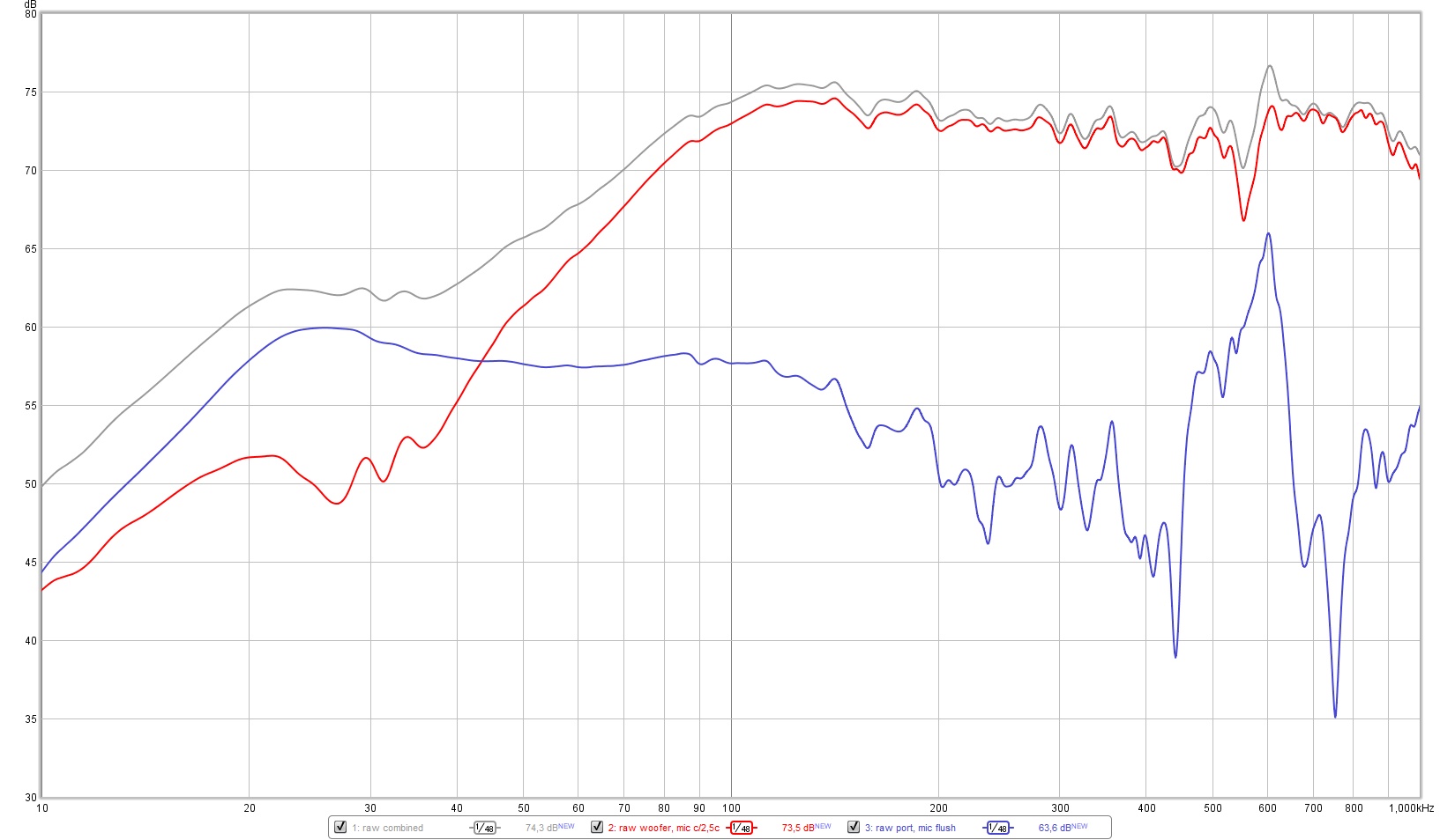

Why is that so? Here is an example of the port resonance of a box without dampening. The resonance is peaking at 600 Hz, because the vent is 25 cm long 8 cm diameter, but it also stretches 100 to 300 Hz wide, depending on the pressure level one finds to be of relevance. Is a port resonance only excited if within the source material, the precise frequency (let's say +-5 Hz) is played, or also in a wider range? Is there a function with something like a Q value to define the steepness of the sides of a resonance frequency, where one can tell within which range it is excited?The lower in frequency the vent fundamental is, the greater the likelihood tends to become of it being audibly excited.
Its not just port resonance..... box standing wave also leaking through the port opening. It looks like you have port resonance near box standing wave, so you geting wide response.
Box standing wave you can reduce with damping material, for port resonance you can make trap by driling the holes at half length of port and then cover that holes with material which doesnot leaking air, but flexing. Neoprene foam working.

I saw a patent on google patents today which explains this, but did not think this was necessary. I assume damping will solve a lot, my question is actually much more about whether port resonance frequency can be optimized by choosing a frequency location which is better and what criteria applies. As in my example the choice between 345 or 785 Hz.
If it is bass driver in 3 Way, then obviously is better to have port resonance at 785hz, assuming xover is lower in frequency, so resonace will be less excited.
