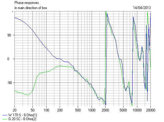

It's a fact that you will discover, that it is best to not mix materials with speakers.
Why would that be so?
Pretty easy really. All drivers have an acoustic signature related to what they are made of.
If you use drivers with similar characteristics, they exhibit faults related to the standard resonances. For instance most paper drivers and soft domes fall apart around 7 and 12kHz. The best you can do is align them so they are equally bad and the Q's (or damping) match. That way, your ear hears no glaring difference.

The know how that i think i have is in the crossover. You really have to suppress the break up peak but also reach a rolloff that makes the blending of the tweeter smooth.
I think the teeter breakup is too high to be audible. You have to consider that a soft dome breaks up too more or less controlled at a much lower frequency. If you measure it the right way a rigid membrane has less distortion and better resolution. Of cause the magnet and suspension plays a big role too.

Well, the crossover is 3rd order acoustic butterworth. Both, in phase and out of phase sum to unity on the design axis. The out of phase has lower phase distortion and the in phase has better lobing to the top.
Atkinson critisized the lobing beheviour so i fixed it with doing the tweeter in phase. Gave me a new and better review .
