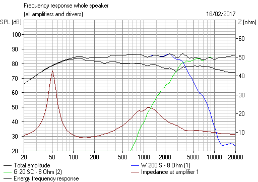

Visaton W 200 is affordable good quality and described as "Especially suited as replacement driver for many HiFi speakers"
And its available in both 4 and 8 Ohm version.
Is that the best option is really hard to say without crossover schematics and other technical data.

I find 8" paper cones much of a muchness:
SB Acoustics SB20PFC30-8 8" Paper Cone Woofer
W 200 S - 8 Ohm | Visaton
H1288-08 CA22RNX
Simple crossovers can be effective:
Ends up a bit like this:
