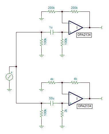

OK...I'll play.
Both of the circuits below have a gain of 6dBv (X2). The upper one has an input impedance of 50k, and the lower one has an input impedance of a little less than 2k. The higher impedance one will have slightly higher noise and a little more CM distortion than the one below.

I merely note that the CM distortion is going to be a function not of the input impedance resistor chosen but rather the AC impedance seen by the opamp with the signal source in circuit. What's the output impedance of that signal source you have?

If you refer to the OPA2134 data sheet: http://www.ti.com/lit/ds/symlink/opa134.pdf - sec 7.3.3 "Source Impedance and Distortion" you'll see that the low impedance version meets those requirements without regard to source impedance, and it works just fine. 😉

No answer to my question then about the source impedance you've chosen? The paragraph you've cited begins :
For lowest distortion with a source or feedback network with an impedance greater than 2 kΩ
You think >2kohm for a source impedance is likely in this context?
Take another look at the circuit, the non-inverting input sees 2kohm at DC and less than that for AC signal. Inverting input sees 2k, 4k in parallel with 4k. Both inputs satisfy the requirements as laid out in the data sheet, therefore CM distortion will be minimized regardless of source impedance.

So why choose such high feedback resistors in your first example circuit (post #13)? Because you care more about DC than audio frequencies?
