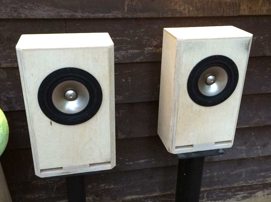

The A11ms, with the monoSuspension allows it to have greater DDR (ability to reproduce [and not bury] the small details in the music. It has more extended HF response than the A10p. The way it was configured (T/S) means that it fits into a really small BR box and won’t likely be as bass capable as the A10p unless installed in a big loudspeaker like Frugel-Horn XL or Pensil11 (ML-TL).
As it turns out i finally had some time to start work on the A11ms Mar-Kens and the 6” driver in a small box leads to something fairly squat and as i look at the boxes think, i wnder what helper woofers i could put into a woofer acting as stand with the same footprint.
The monoSuspension certainly brings the issue of what happens when it is exposed to high evels with LF. But Scott & crew actually tired to break a pair in FHXL when the driver was first presented in the UL at the Bristol show, They were unable. We have also been unable to preturb it with our SeaStack ML-TL. There ar esoe indications that the A7ms may have more of an issue (it does have greater LF potential, bu tless cone area).
