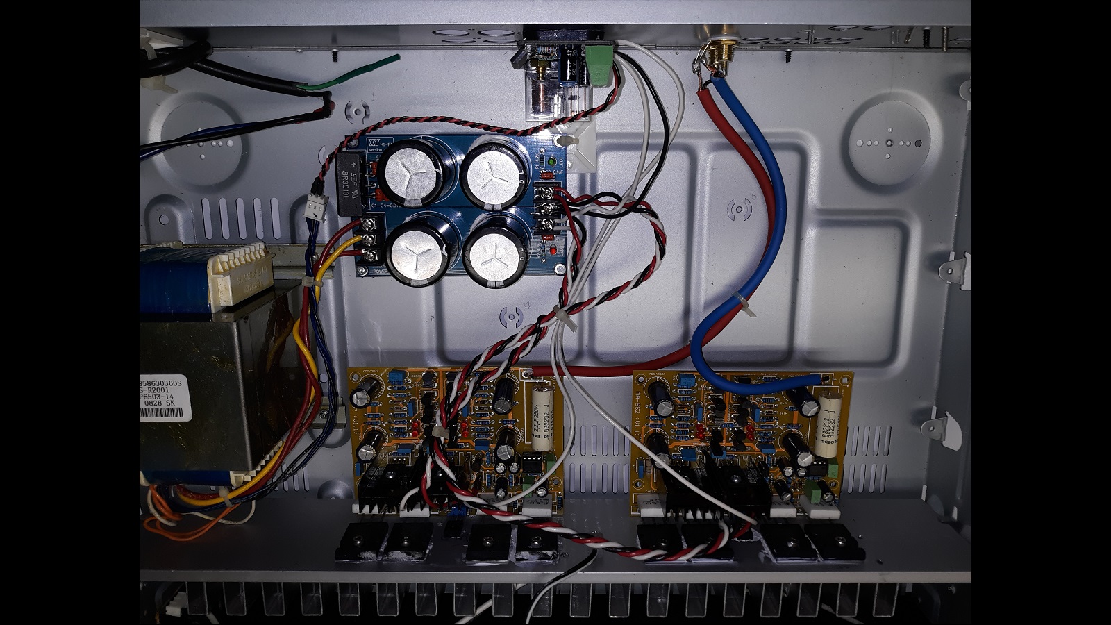

I have attached photos of my "Marantz Style" MA9S2 which I am pretty happy with. I do need to move it to a new case with a larger heatsink and a larger power supply board, more like the one in the photo of my in progress MX50X2.

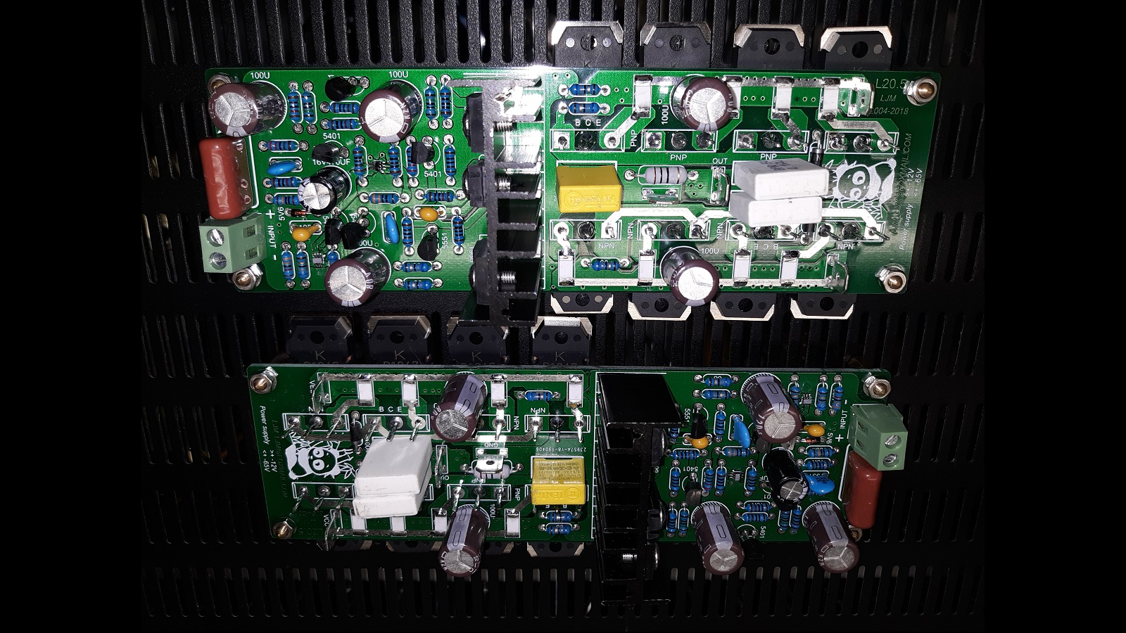

I have also attached photos of the MX50X2 and L20.5. They are awaiting assembly in cases but they have been listened to outside of cases previously at lower voltages.
To be honest I am very impressed with all three. The LJM MX50X2 and L20.5 were pre-assembled and as far as I can tell they use good quality components.
The MA9S2 was a kit and the only problem I had was that one LED cracked and thus one of the strings of LEDs did not light up in the input bias section. But I don't think that is the fault of the kit at all.

Well it will be a couple of weeks until the parts arrive to finish assembling the MX50X2. (Then I can compare some more.)

With the MA9S2 I did not seem to notice the shortcomings of the source recording as often. I have listened to the MA9S2 the most and I think it is my current favorite however I will need to spend more time on the finished MX50x2 and L20.5 projects before I should reach a solid conclusion. That will take more time and then I plan to try building a second set of my chosen favorite kit so that one chassis (with two amps) can drive the left front speaker bi-amp and the second chassis (with two amps) can drive the right front speaker bi-amp. At least that is one of my possible next experiments that I am considering.

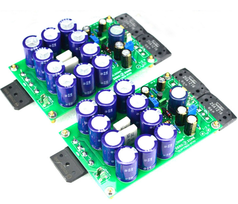

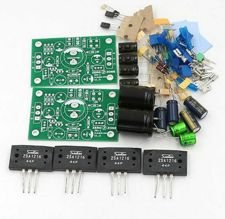

Best sound so far is from a ZeroZone class a JLH PNP (big boards with rectifier & caps). A lot better after some modifications (found in JLH thread). Sounds very nice, but low power and class a heat of course.
So of the two photos I attached I assume it is the second one? Or is it a different kit? I assume not the first one which is just the amp.

-Yes the big JLH boards, and I used the supplied transistors. Modifications are posted in the JLH tread if you can find it..: floating ground, and changed some component values on resistors and caps.
Using 2pcs 19,5V 7A rated HP laptop bricks for supply (dual mono is needed with floating GND). Those bricks didn't mind big caps on startup, and supply a pretty clean voltage. Traces can be cut and the capacitors supplied with the kit can be used for the floating ground setup (saves money and time).
Safety ground can't be connected in the bricks either.. (at your own risk)

Are those regarded as the best JLH kits to try? I have seen them and they are on my list but I am trying to decide between those and a couple of other versions.

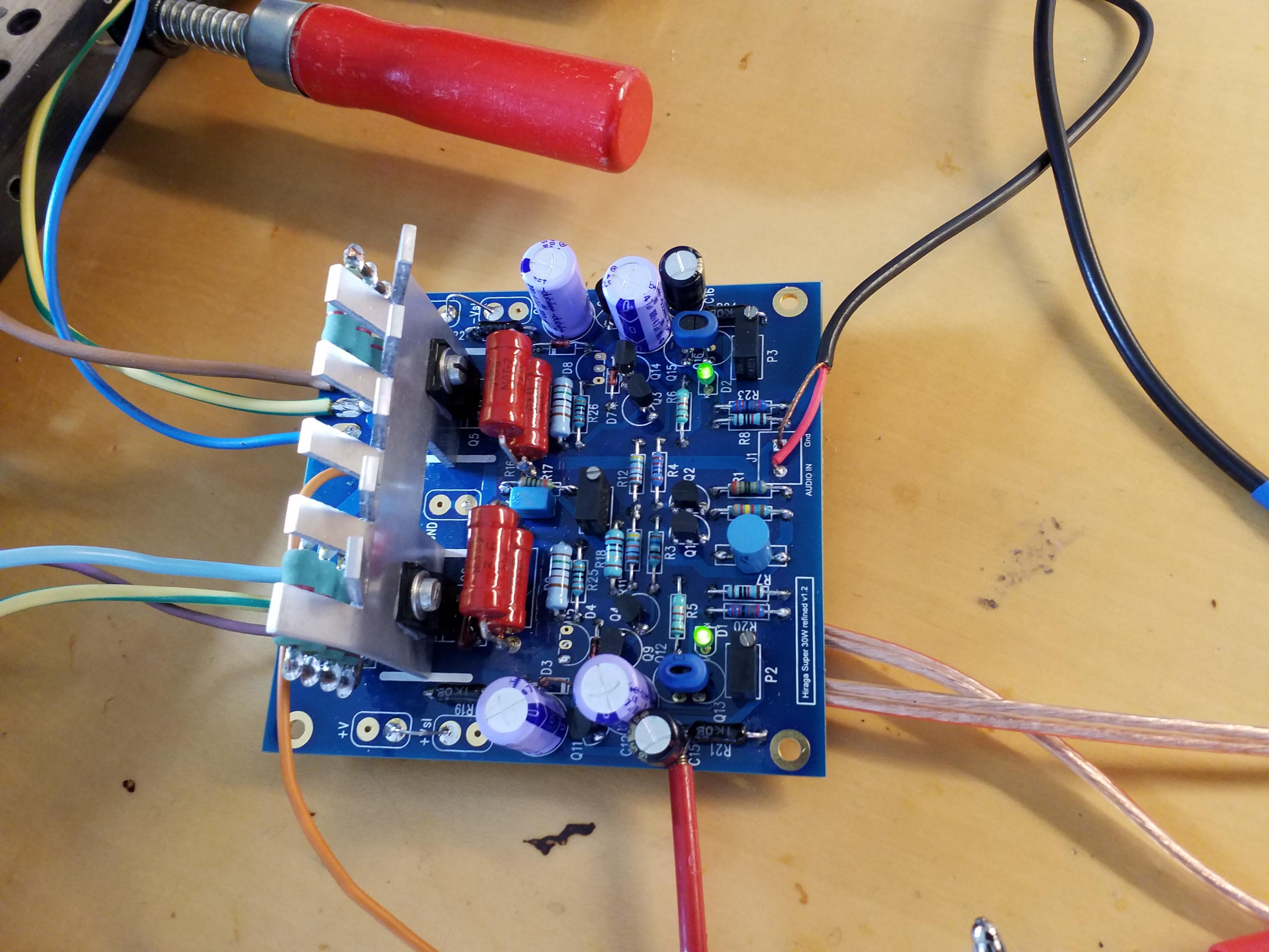

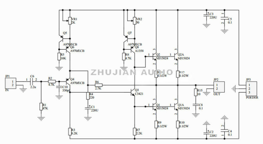

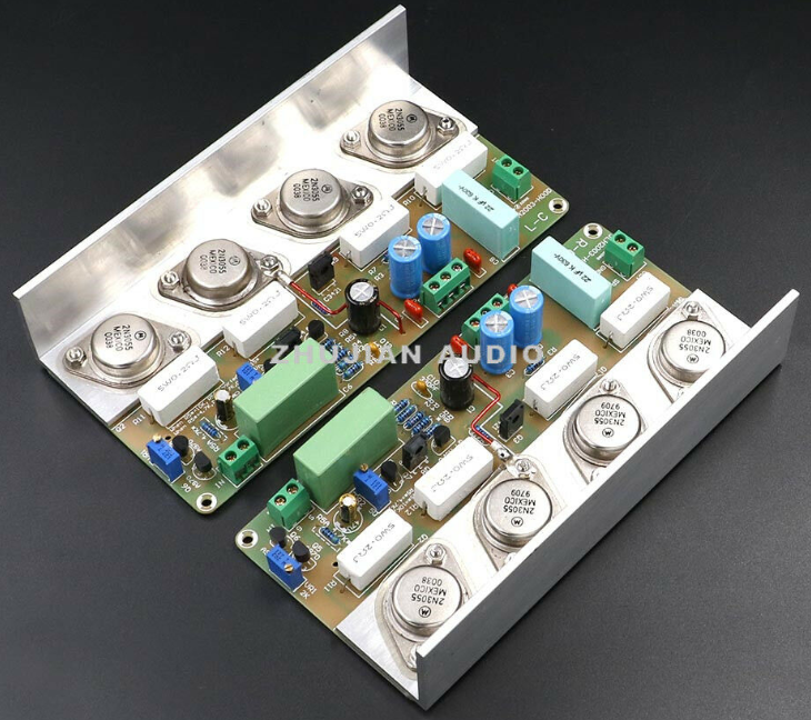

For example, there is the JLH 2003 with no output cap, four output transistors and two current sources. (Photo and schematic attached.)

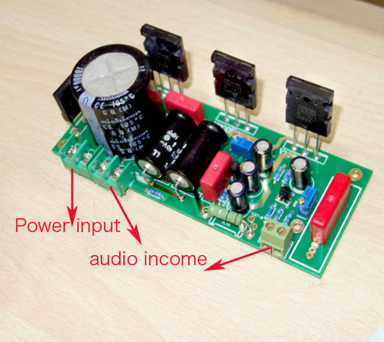

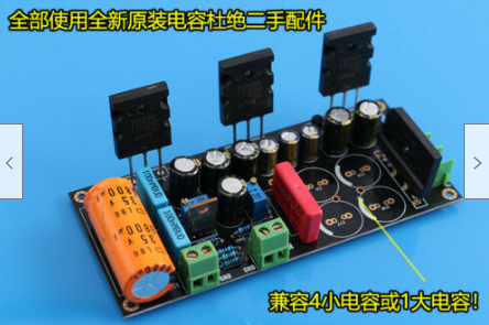

Then I am also considering the two versions that have a regulator built-in and use the 5200 outputs. (Photos attached.)
Have you tried the other types? For this project I would like to get just the "better"/"recommended" JLH instead of ending up with an large assortment of JLH amplifiers like I have with the LJM kits.
I have build the first one shown, from bare pcb, and with other output transistors 2sa1117/2sc2608, I'm really surprised how good they sound, but it demands at least 2 kilo heatsink and a clean dc supply.
I think it's called jlh 2003 version

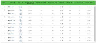

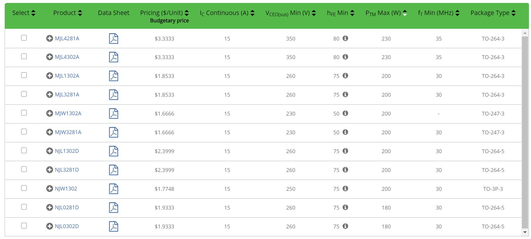

Unless you are committed to TO-3's there are many current BJT's that could be considered instead of the 1117/2608 that have superior parameters (Gain/Vce/ Ic / Price/ Reliability) etc: like this selection. I filtered out anything with gain lower than the originals, as I feel that is an important part of the selection of those trannies.
If you want the extra 2amps Ic parameter, ON still makes the MJ21195/6 that will work but gain drops to 25 instead of 30 of the Sankens at 8amps
Which vendor did that list of prices come from?

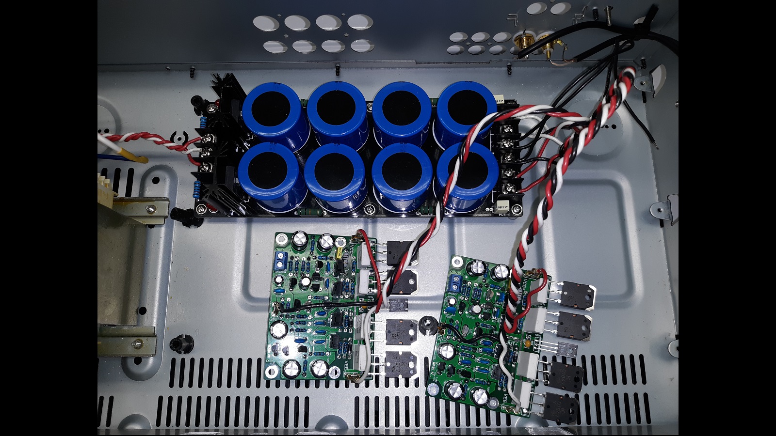

This amplifier DIY KIT LJM L6 has really good sound, I decided to make better PCB with ground plane. So I will have more fun with it when PCB will arrive. I just don't know why it has FERRITE coil? I plan to change it with air coil.
