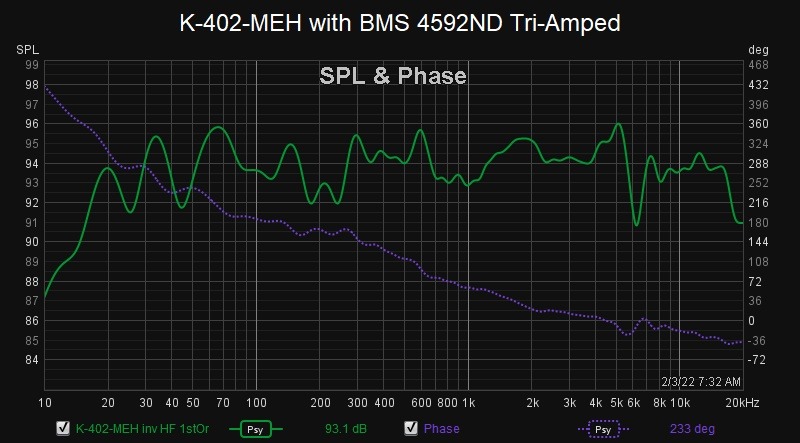

I also run a BMS 4592ND (bi-amped) in my center K-402-MEH--a full-range loudspeaker based in a three-way (including the 4592's two diaphragms) multiple entry horn using dual 15" woofers-- discussed more here: https://community.klipsch.com/index.php?/topic/161404-a-k-402-based-full-range-multiple-entry-horn/.
All in all, I don't believe that your focus on harmonic distortion (HD) is a good way to evaluate these drivers--at all. In my experience, the factors that are audible that differentiate the drivers are:
1) smooth non-breakup SPL and phase performance above 6-7 kHz (very audible)
2) timbre of the driver vis-à-vis TAD TD-4002s (almost as audible, but requiring significantly more time to evaluate using a variety of recordings)
3) "sparkle" or lightness to the presentation that correlates with the diaphragm's ability to play without breakup with ease above 10 kHz (least audible and requiring many hours of listening to form an impression--greater than 20 hours.
Under this scale, my impressions are the following (fully dialed-in drivers/K-402 horns using First Watt F3):
1) TAD TD-4002: no coloration, no audible diaphragm breakup even at high SPL, and plenty of naturalness and sparkle.
2) Celestion Axi2050: no coloration, no audible breakup on cymbals, etc., but slightly lower sparkle and naturalness, almost not audible even after many listening hours.
3) BMS 4592ND (bi-amped, time aligned): no coloration, no audible breakup on cymbals, etc., but slightly more irregular SPL response around the internal two diaphragm crossover point (~6 kHz). No real audible differences between the TD-4002s and the 4592NDs.
All three have almost no differences in listening quality, especially after using a "phase plug extension" (or otherwise described as a horn throat diverging acoustic lens) that spreads out the polars of the 2" diameter throat, which doesn't affect on-axis SPL response, but significant increases the large off-axis timbre consistency. I would seriously doubt anyone could tell the difference under blind test conditions. I haven't heard any other drivers (including AMTs, etc.) that could match the presentation of these three drivers on a K-402 horn, fully dialed-in.

Well, not really...it's more of a choice between flatter phase or flatter SPL response. I choose flatter phase because it sounds better in my listening room. If you want flatter SPL response at crossover, you can get it.There is a gap between the two Diaphragms in the SPL Response.
(Note the scale resolution):
Chris

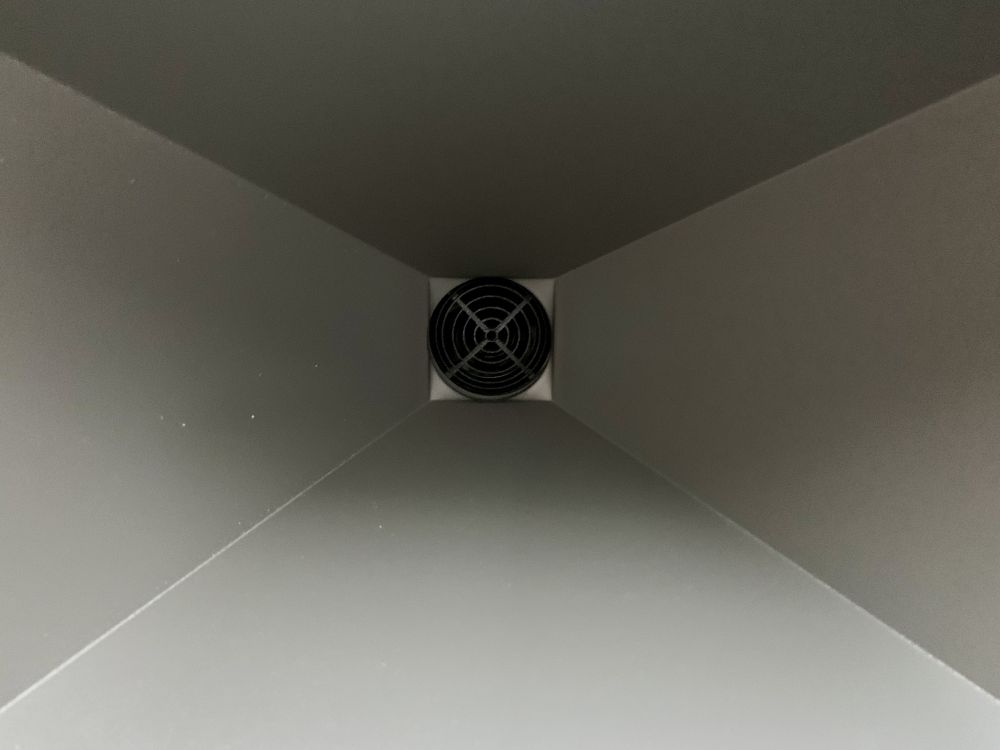

Look at this for a guide, noting the convex exit plane of the lens:Hi Chris do you have any details of the "phase plug extension"?
Chris

Dialing in the BMS 4592ND diaphragms using IIR filters in a DSP crossover works great. If using crossover filters having no all-pass phase growth, then a delay of ~0.145 ms on the higher frequency diaphragm relative to the lower frequency diaphragm will achieve time alignment (~one period of a 7 kHz wave at room temperature). I find that this time correction brings the overall sound quality essentially up to that of the TADs on the K402s. Without the time delay correction, there is a timbre shift that makes the 4592ND sound different than the TADs.
BTW: this is much better performance than trying to use two drivers on separate horn apertures, and this fact should be kept firmly in mind.
Chris
