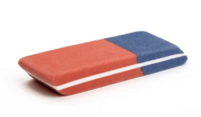

Where I used to work we had these cleaning tools that looked like a very small wire brush at the end of a dental pick. I wonder if something like that would work for you. It sounds like what you need is an extra abrasive pencil eraser. Speaking of... Back in the day when erasers had one end that was coarse and intended for removing ballpoint pen, I did use that end of an eraser for cleaning up circuit boards before soldering. Like this one:

Tom
We used to say "typewriter eraser". The round pink wheel ones are long-gone or else now hard as rocks. But there are several brands of stick eraser. These used to be abrasive. Or hunt "ink eraser".
Oh I remember those. I never associated them with typewriters, though. The typewriter I had access to had a correction tape with some white stuff on it that you pounded into the paper to cover up your mistakes.
Some googling reveals that one can get the "ink eraser" (the blue part) in one chunk. The pink part can be useful for removing gunk from the gold fingers of RAM sticks, ISA/PCI cards, etc.
Probably not the same, but there are "scratch brushes" which apparently, if properly picked and used, do not scratch (much?). brass steel nylon fiberglass. Cars, watches, other uses. Breaking oxide ought to be easy. (If you will flux, you don't need to brush the oxide all the way through, only to let the flux get under old/heavy oxide and do its thing.)
Aha! Thank you for the search term! They're not identical to what we had at work but close. They look to be of higher quality than what we had... But those are what I had in mind. The fibreglass ones should be good for cleaning smooth surfaces. Just don't breathe the fibreglass dust.
