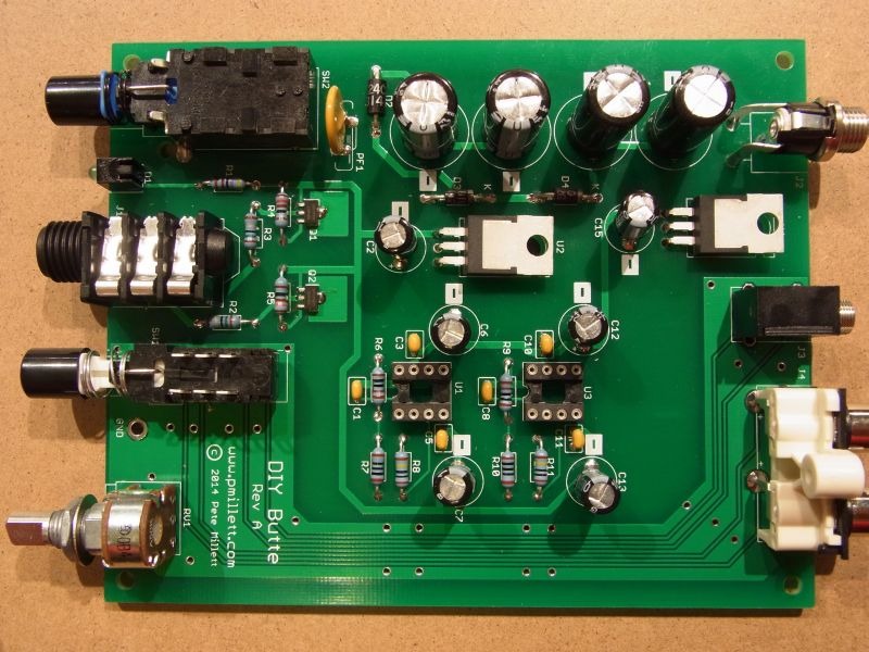

Don’t forget the excellent @pmillett “Butte” headphone amp. It is exactly what the OP is asking for.
http://pmillett.com/butte.htm

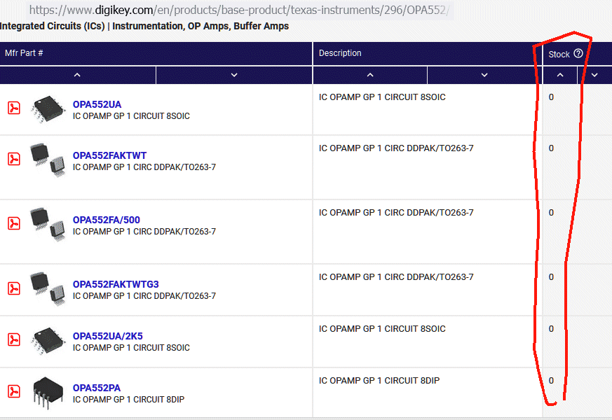

No doubt; but isn't OPA552 low/no stock at the reputable distributors, at least for the next few months?Don’t forget the excellent @pmillett “Butte”
Yes, the present project may not be ready until April (Mouser's estimate), but it would be 😢 to be delayed too much more. A chip in the hand is worth ten on the wait-list.

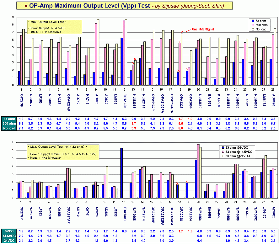

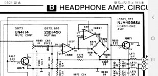

If you wanna go cheap use 2x njm4556 ic's as here and you can't go wrong.
JRC4556AD, cheap and cheerful , see the chart by sijosae. Tip - use +/-5V supply with "real" ground

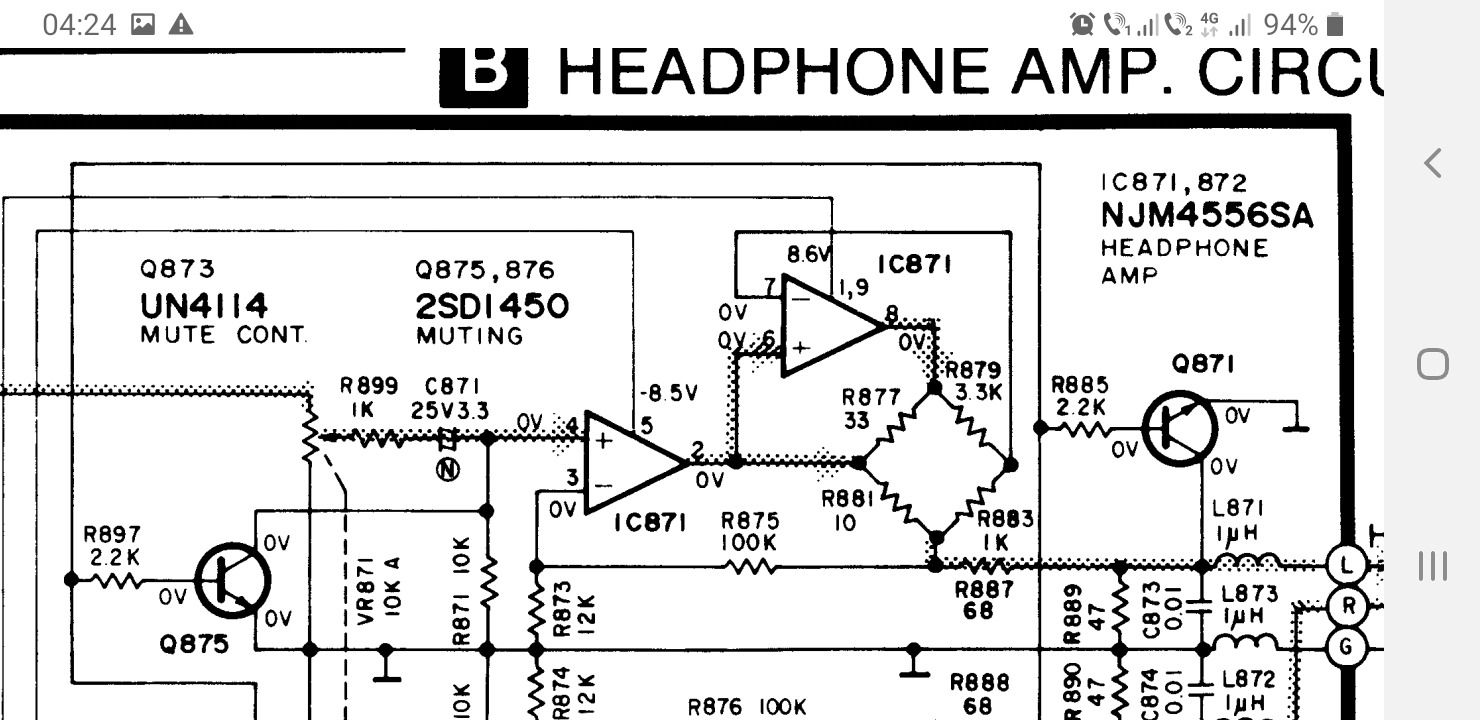

I don't trust his assessement on 300ohms load or I find it irrelevant.I use opa2228 on 250 ohms bayerdynamic dt880pro with 6x gain and I get one of the best and loudest sound I can from an op amp.Bare njm4556 doesn't sound as good as opa2228 on 250 ohms in the same circuit.I think I recommended the class AA Technics hph amplifier with njm4556 for a 100 times and nobody showed any interest in building it ...but that's the circuit to make if you want your njm4556 to sound as good as tpa6120.Sijosae CMOY amp used opa2132 which is a very good op amp.Njm4556 can drive almost anything, but it needs help on the distortion side which the class AA circuit provides.
This is why most TPA6120 projects use an op-amp pre-driverTpa6120 is unbeatable for 99.99% of the headphones found on this planet, but it needs one more op amp to drive it as it's unstable if driven from a high impedance source . 2x lm6171 looks like the next option to me.

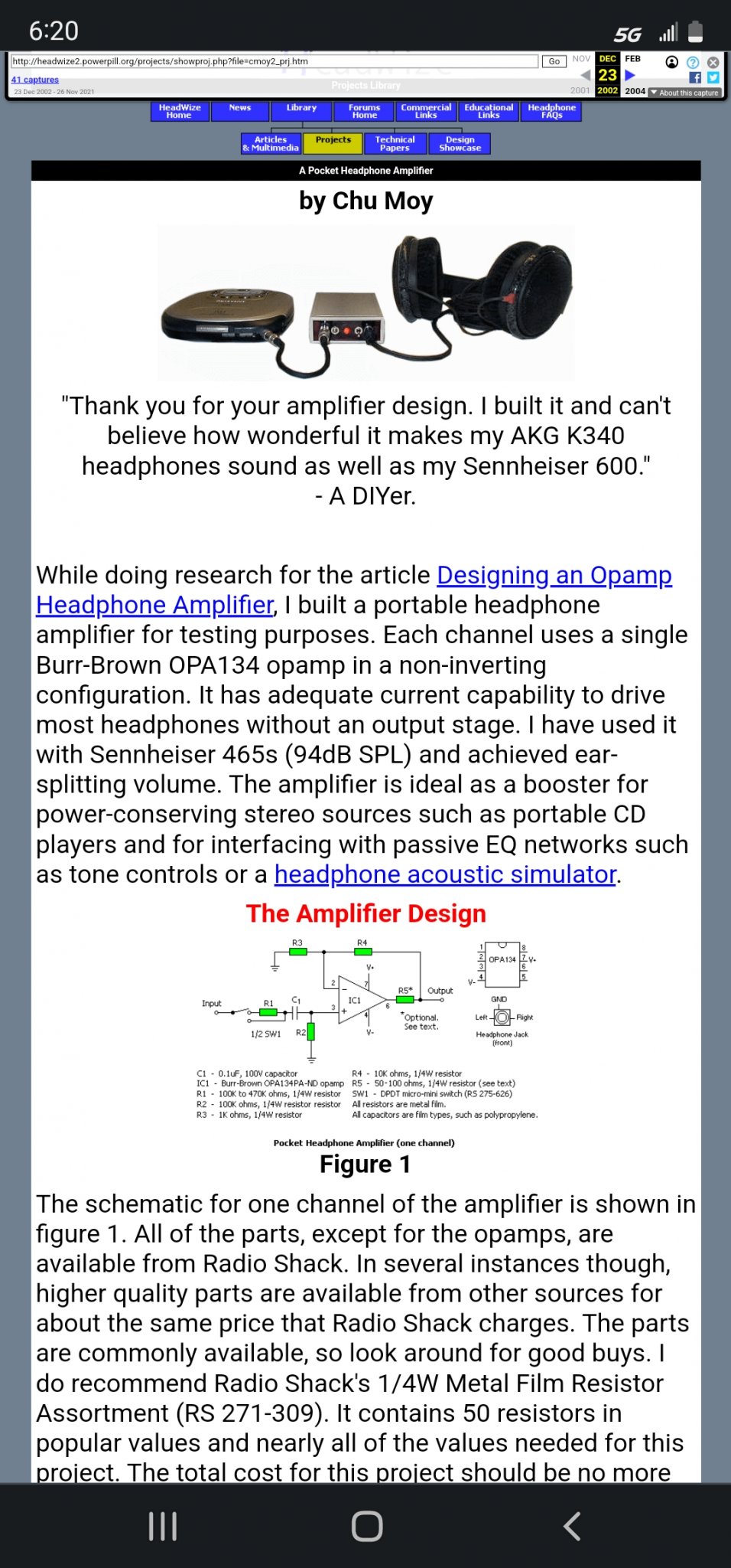

Here is an old chu moy with opa134, you can use dual.
https://web.archive.org/web/2002122....org/projects/showproj.php?file=cmoy2_prj.htm

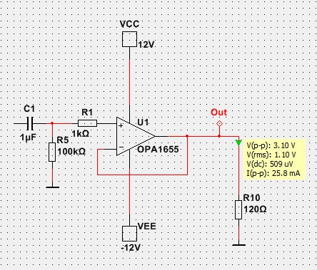

Same thought I have.OPA1656
But I recommend using the single version: OPA1655. Better cooling with 2 devices.
OPA1655 can put out 100mA. It is stable at Gain 1 as far as I know.
