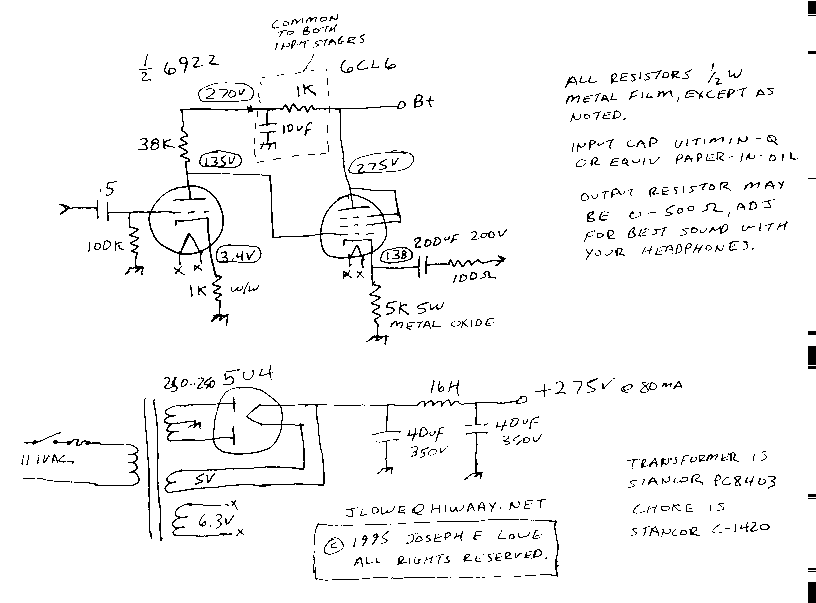

If you can live with just hi-z here's a otl hp amp designed by Joe Lowe and posted to USENET in the mid 90s. I built one and still use it. Great-open-sound. Here's the original post:
I have just designed and built a circuit you may be interested in. It uses a Russian 6922 (6DJ8) driving 6CL6 cathode follower outputs. The sound is fantastic, you can really hear the "monster image" with headphones.
If you look at the requirements for a tube that can directly drive a low impedance, very few have what it takes. Looking at the RCA tube manual the formula for the required Gm for instance is:
(umhos)= 1,000,000/ Zo (ohms)
This narrows the list to about five types. You also need a tube with a low plate resistance and high dissipation so we can pass some current.
I took a hint from video gear of the tube era, they always used the 6CL6 as the output stage to drive 75 Ohm loads. (flat to 4.2 Mhz!)
Joe
Joe

I'm a beginner here too but I already realized that 'best sound quality' is not such a different question from 'most beautiful woman' ....
and why rule out solid state ?
http://www.diyaudio.com/forums/headphones/160646-germanium-single-ended-class-headphone-amp.html
http://www.diyaudio.com/forums/headphones/159815-rush-cascode-headphone-amp-jlh-output-stage.html
Best amp?? I alway say to my buddies that the amps that I builts are the very best.... Ha ha....
Johnny
Johnny
If you want something that's considered up there with the best look for amps designed and built by people who obsessed with this kind of thing for many years. For instance, have a look here:
The Amity, Raven, and Aurora
Don't underestimate the complexities of building something truly outstanding.
Edit: in case you didn't find it in the above link:
http://www.nutshellhifi.com/gary/index.html
