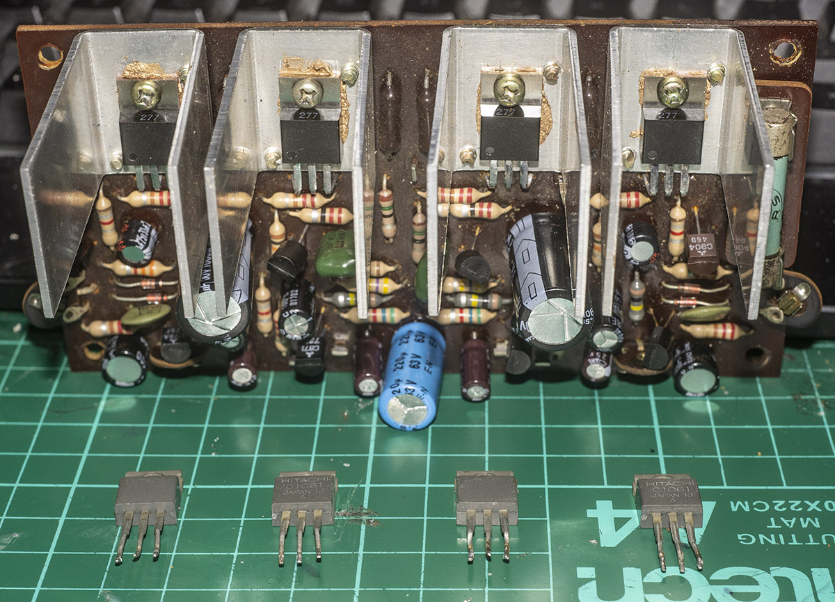

I need to replace the four 2SC1061s in the output stage of an amp I'm repairing.
After reading numerous threads on the subject, my brain hurts, so many contrary opinions.
The parts I removed had hFEs of 26, 30, 38 and 44, so were nowhere near matched for gain. Should I be looking at replacements with a hFE over 40? Is there any benefit to matching parts as closely as I can i.e. buying 10 and selecting the 4 that are closest in parameters?
If these are the output devices, as they were in many small Japanese amplifiers from the 1960s-70s, matching isn't critical. You can see how important low-current hFE matching isn't, from your measurements of the original parts. As this a 3A power transistor, testing and matching hFE at about 0.5A would be more useful than just a few milliamps from a component tester.
Also, beware generic semis. They may be marked C1061 because they are suitable replacements for some applications but not necessarily the most demanding.
I've used the Semelab parts, for two reasons, firstly, I already have them and secondly, I know they are high quality parts.
If they turn out to not work well I'll get something else, probably the MJE1503x as those are easily available to me.

Surprised nobody has mentioned TIP31A? Meets the spec perfectly.
Because I would use the 41. At least it will have some gain left at 3 amps. The 31 is really only useable to about 1 amp even though it’s spec’ed at 3 max.
1503x are not as rugged, but would probably *work* if the power supply voltage is low enough to only need 3 amps peak.
