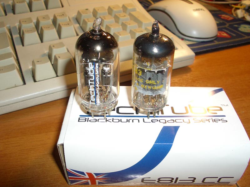

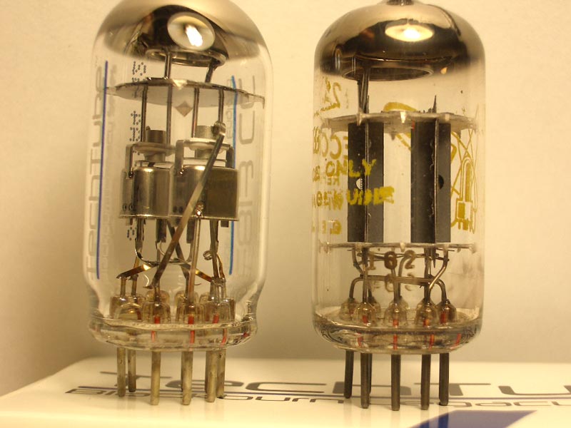

Also, I like extremely cheap chinese ones in a THICK glass envelope. They can sound just as transparent and wide spectrum as NOS mullard or flat plate telefunken.
All you need is to buy a bunch and do some pre-selection to sort out the most suited ones for your needs!
And don't believe a tube is better than another only because it's highly priced! Money is not a quality factor. Expensive tubes in a bad design will only make a bad and expensive design.
The most linear 12AX7/ECC83 I've tested were cheapies from an undisclosed location in Eastern Europe. Fat bottle, small plates (look like 12AT7). JJ were also excellent.
The ones with the small plates were RFTs, made in E. Germany. Wonderful tubes, I agree with you.
But I'm not much of a JJ fan. They may be fine when they work, but I had 50% failure rates when I tried to handle them. I couldn't afford to carry them!
