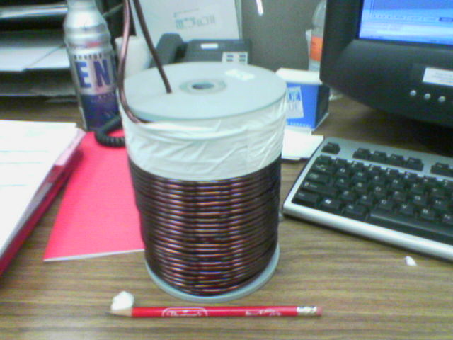

What is the best way to connect some solid copper 6 gauge wire to some copper buss bars? I am looking for the best attachement method. IR lowest resistance. most solid connection etc.
How do that connect wires in big transformers?

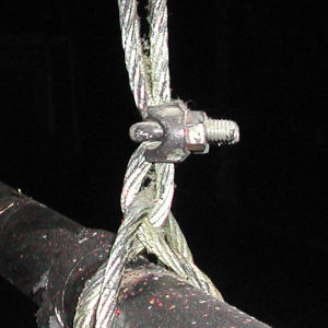

I think old polititicans would make real good bussbar connectors...
"here!, hold this, and this!"
