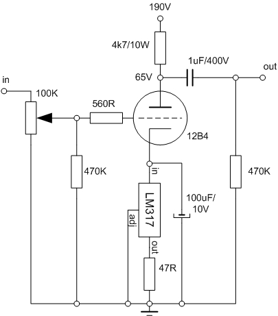

Hi guys,
I have been using for few weeks LM317 in cathode arranged as current source in my 12B4 grounded cathode line amplifier. Plate current is arround 25mA and voltage on LM317 current source is arround 10-11V depending on a tube caracteristics.
I would like to use something that is better than LM317 that will give me arround 25mA and that will work better on that voltage across ccs. A friend of mine suggested TL431 - I would like to hear some other options that might be even better ....
Maybe something discrete .....

Could you explain further? You say that this is a grounded cathode circuit but you have a current source on the cathode?
oups..... made mistake... picture of the current arrangement (almost current-but You will get the idea)...
((100uF is 220uF in fact and it is bypassed with 1uF MCap; also voltaage on anode of the tube is not 65V but 130V and high voltage on plate res. is arround 260V))
In this circuit, it is the cathode capacitor that is the most critical component in the cathode circuit. It's whole point is to efficiently bypass the CCS anyway, so the CCS only sets DC condition. Last I checked, humans can't hear DC 🙂 so if something is wrong, your cap is not doing it's job.
I have to agree.... whats wrong with the 317.... they can be had for 50 cents? Any noise that it might introduce would be bypassed with the caps anyway. There are other regulators one could use by IXYS and others however the 317 is pretty cost effective and you'll still need the boutique capacitors in the cathode with the others as well..... I doubt there would be any major audible difference between cathode based current sources due to the major effect the bypass caps have on overall sound.

The datasheet says the tube needs about -15 to -20V gate voltage to deal with 130V plate voltage and 25mA anode current.
Your 10V-Cap will not withstand this voltage for a long time.

I am partial to the IXYS 10M45 chip myself, but I have not tried it in this circuit........yet.
In this circuit the cap would eliminate all artifacts caused by the CCS, IF THE CAP IS PERFECT. We all know that caps are far from perfect.
I want to build this circuit soon, I have all of the parts, a lab grade power supply to run it (Fluke 407D) and both kinds of CCS chips. I am just short on time right now.

I tried a 317 on the cathode with a couple of good quality bypasses (silmic II, cerafine) plus a generic for good measure. However, I preferred a 10M45S cascode CCS on the anode with no bypass cap on the cathode resistor.
The sound with the 317 CCS changes markedly depending on the cap used: I think tubelab hit the nail on the head - this type of circuit is great, assuming you have the perfect cap. Otherwise you are listening to capacitor artefacts, which to my ears are worse than those of the 10M45S.

🙂 Guys I did not want to argue about how good is LM317 here - .... it is working fine in my circuit that is posted up there in this thread.... I was wondering what will happen if I try a better ccs than LM317 .... that's all ....I want to try everything I can - and I see that this ccs in the cathode might be a good thing but I have also perceived that it's sound is very dependent of quality of the cathode cap bypass - so why not try something better before I say that this project is finished - why not... why we have to stick with the LM317 - when we know that it is not perfect and that cathode cap bypass has problems to deal with it and that sound is dependent on how good that cap is really (I know that it is cheap and everything - but I would like to try better).....that is why I have turned here to ask the question..... 🙂
I have read the thread that is running arround this part of the forum about LM317 in the cathode where our dear Mark A. Gulbrandsen can be seen often - so I am familiar with all the problems (I hope)........... 😀
to be precise... one of my tubes has 10.5V on the cathode and another 11.5V (well not that precise). I have said that I have not 100uF cap bypass in the cathode but 220uF Black Gate and 1uF MCap from Mundorf in paralel.....So it should be good enough I think....😀

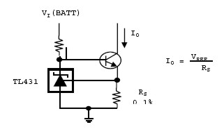

btw.... i am working arround TL431 connected as a shunt in the cathode or as a ccs - don't know which one to use yet.... time and ears will tell......
best regards

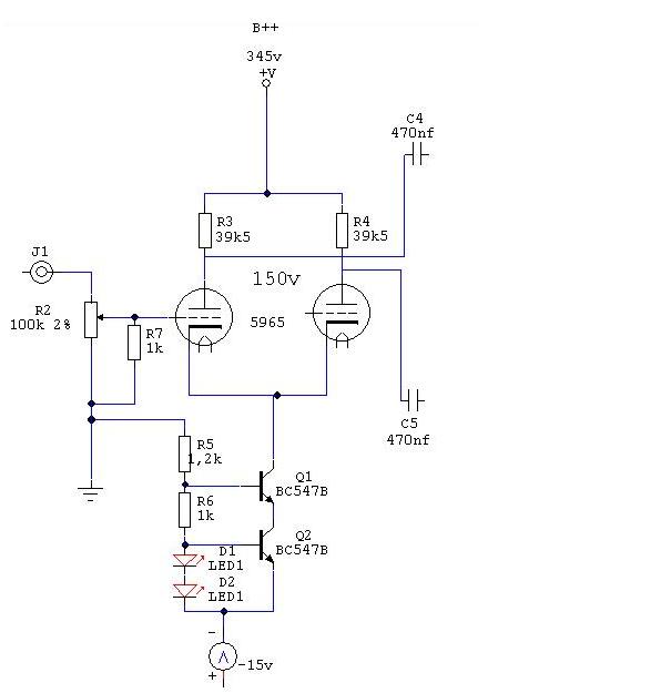

i used a lm317 ccs also on my amp (5965 in ltp driving 6l6gc)
it was said that the lm317 lost its properties above 1-2khz.
so i tried something else, 2xbc547b, biased by two led's.
(see attachment)
The sound did change a bit, but not staggering.
next ccs will be 2xbc547b with the bases connected together....
don't know if it helps.....
(see attachment)
