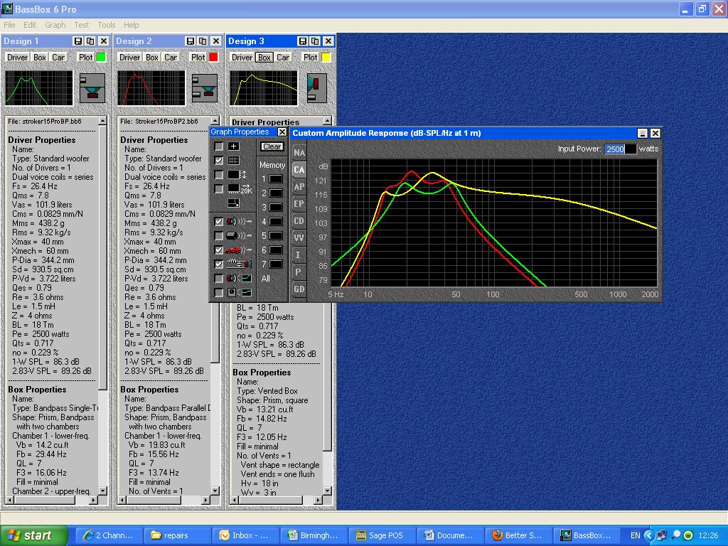

For the best HT output go for a bandpass box,
Single tuned
Chamber 1: 14.2cf
Chamber 2: 3.01cf
Fb: 29.44Hz
F3: 16.06Hz
Vent 18"Hx2.5"Wx43.71"L
Green trace
Double tuned BP:
Chamber 1: 19.83cf
Chamber 2: 5.833cf
Fb: 15.56Hz (large chamber)
Fb: 28.79Hz (small chamber)
F3: 13.74Hz
Vent 1: 18"Hx3"Wx26.21"L (large chamber)
Vent 2: 18"Hx2.5"Wx21.46"L (small chamber)
Red trace
Vented:
14.78Cf
14,82Hz Fb
12.05Hz F3
Vent 18"Hx3"Wx46.89"L
Yellow trace
