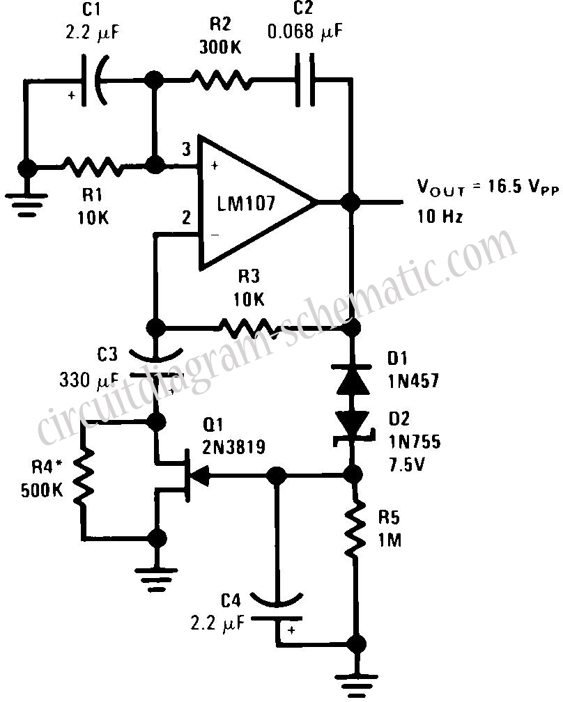

Its use is mainly around the zero crossing of Vgs and Id, both negative as well positive values allowed (under 0.6Vdc) just like their application in Wien-bridge oscillators controlling the amplitude, all ac related. It is a (rectified) 'dc voltage driven' variable resistor. It is obvious to keep a keen eye on the other specs (check), to stay in accord with the original circuit and the OP's request. C3 indicates no dc current, the 3819 suffices.
