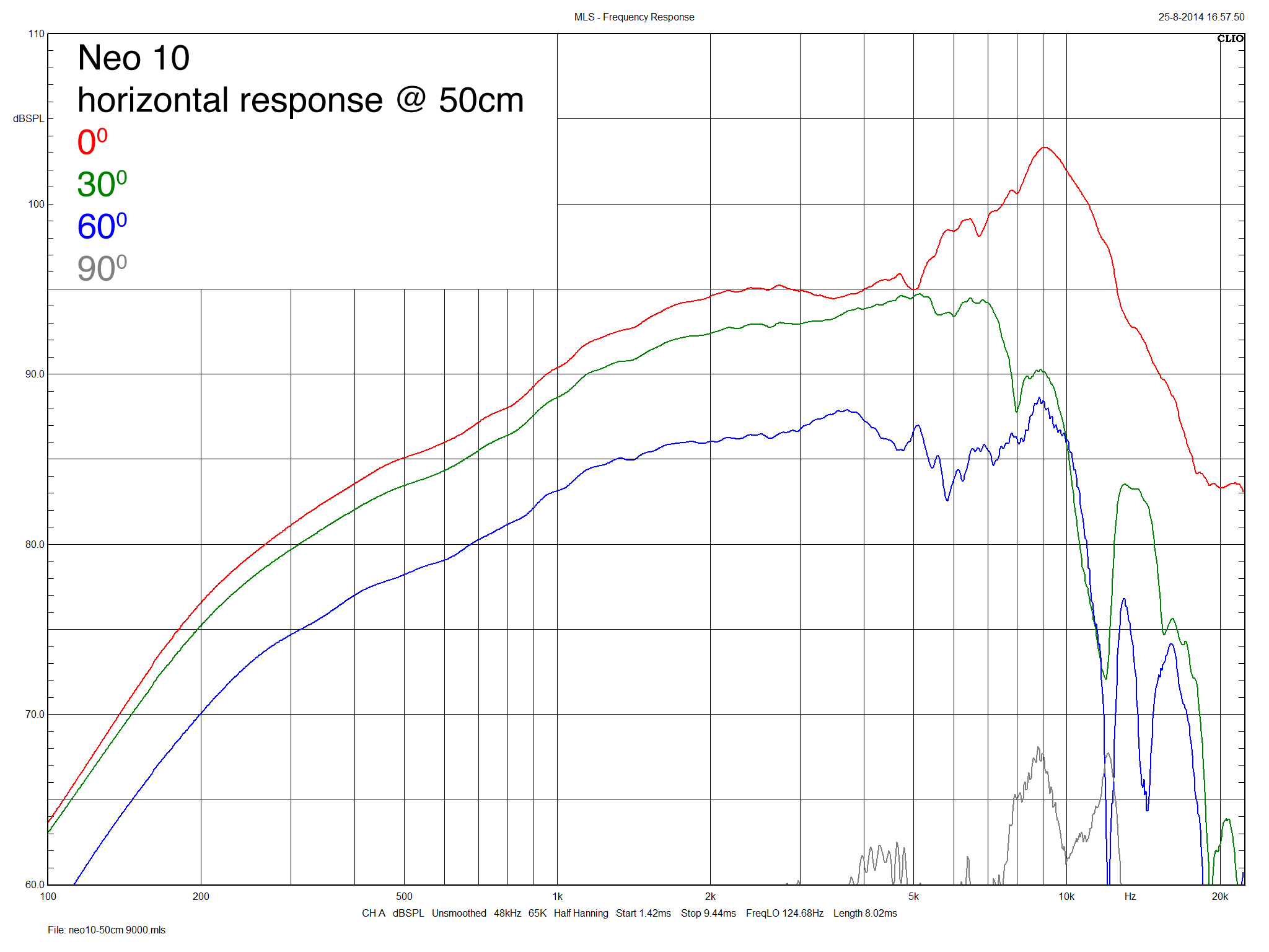

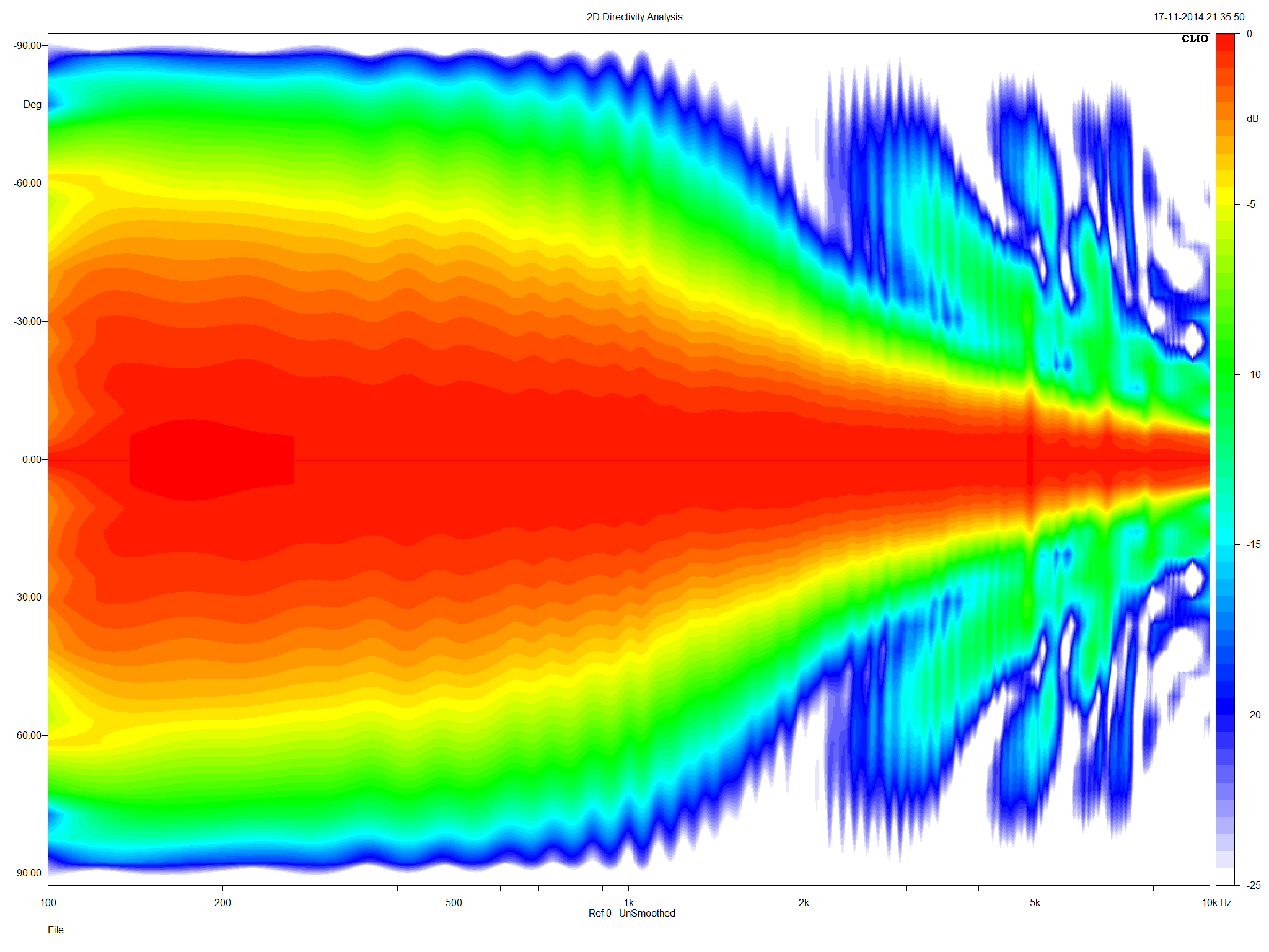

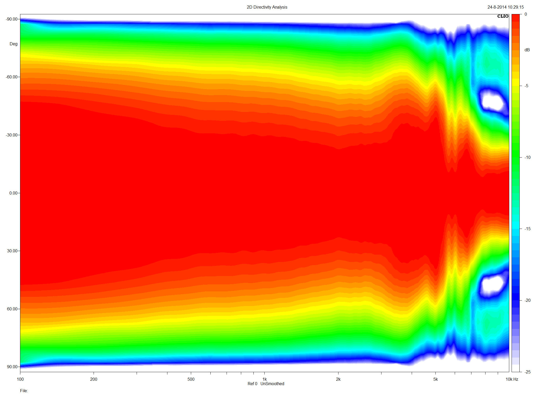

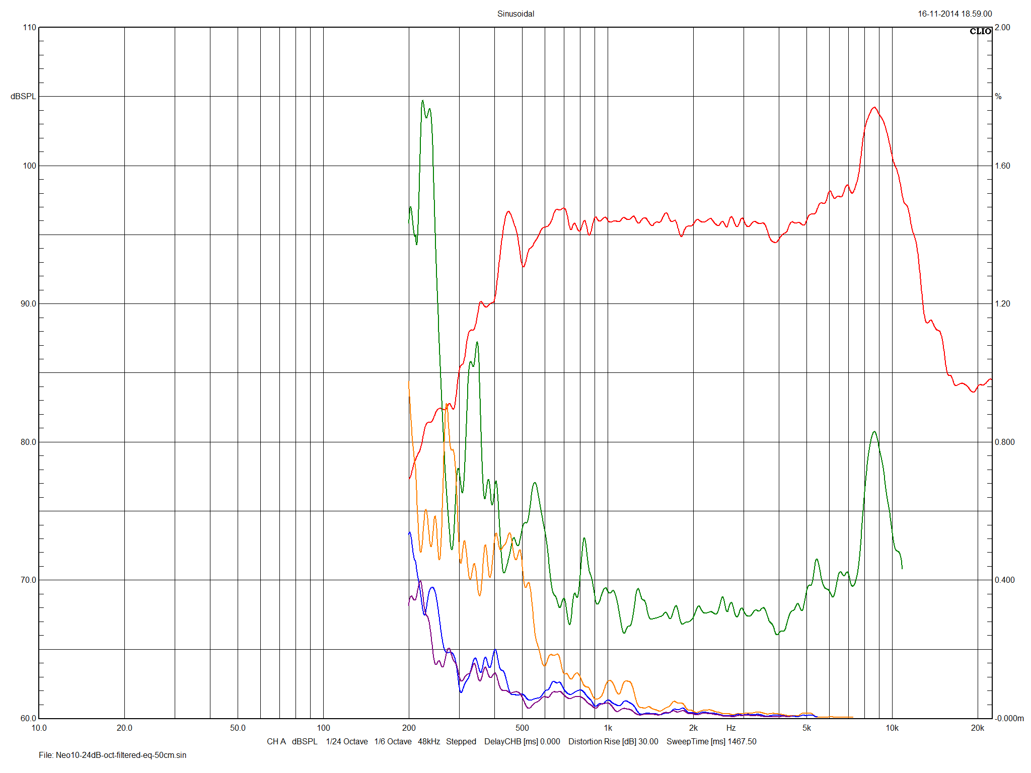

FYI, some measurements of the Neo 10 I made for my dipole investigation. All measurements are with the Neo10 as a 'naked' dipole. Directivity was measured in steps of 5 degrees.
Horizontal response @50cm:
![Neo10-0-30-60-90-MLS.png Neo10-0-30-60-90-MLS.png](https://www.diyaudio.com/community/data/attachments/513/513489-61c0454db4f039e1b0882630b1508c88.jpg)
Normalised horizontal directivity:
![neo10-directivity-normalized-25dB_windowed.png neo10-directivity-normalized-25dB_windowed.png](https://www.diyaudio.com/community/data/attachments/513/513504-337bdf5931953652f095fd2a7a10149a.jpg)
Normalised vertical directivity:
![neo10-directivity-normalized-25dB_vertical-unsmoothed.png neo10-directivity-normalized-25dB_vertical-unsmoothed.png](https://www.diyaudio.com/community/data/attachments/513/513557-3eba5cc48933ea48963b786e69de1be7.jpg)
Harmonic distortion:
![Neo10-24dB-oct--filtered-eq-harmonics.png Neo10-24dB-oct--filtered-eq-harmonics.png](https://www.diyaudio.com/community/data/attachments/513/513517-dea9bdd4134b213720ae0ae3bfb681a4.jpg)
The distortion is for the filtered driver, with the dipole correction applied and a 24dB/oct HP at 400Hz. Response in red (dBSPL@50cm, scale on the left). K2 in green, K3 in orange, K4 in blue and K5 in purple (% scale on the right). The measurement is not gated and I don't know how reliable the values below 1kHz are.

Wow this looks really good up to 4kHz actually! Thanks.
