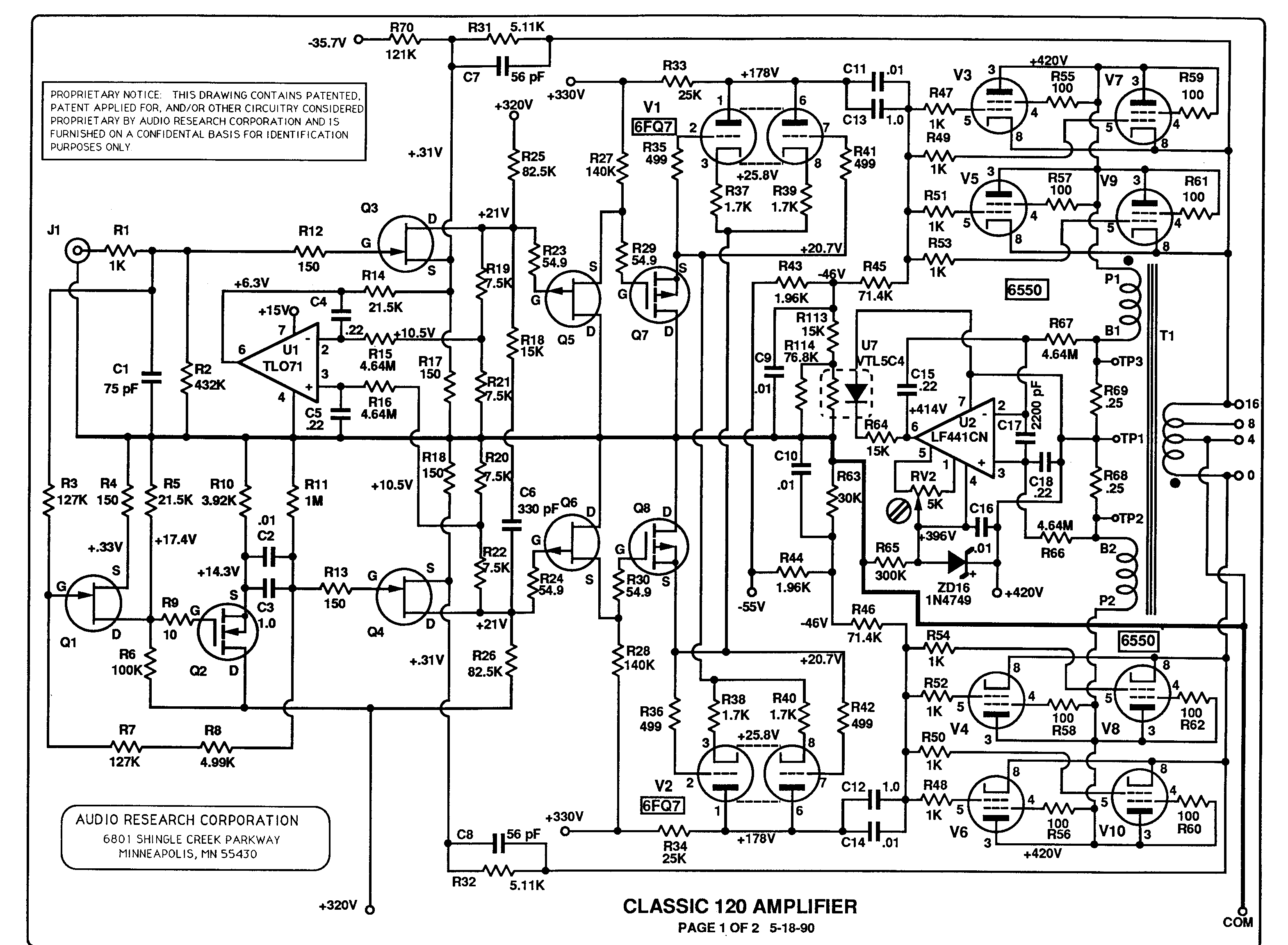

Resistance from g1 to ground is 49.8k ohms on all tubes. People have suggested that I should have gone the other way with the resistor and used 77k which doesn’t make sense to me. I was at minimum on the adjustment and reading 68mv so I thought I would need a larger value resistor to bring that adjustment in range.

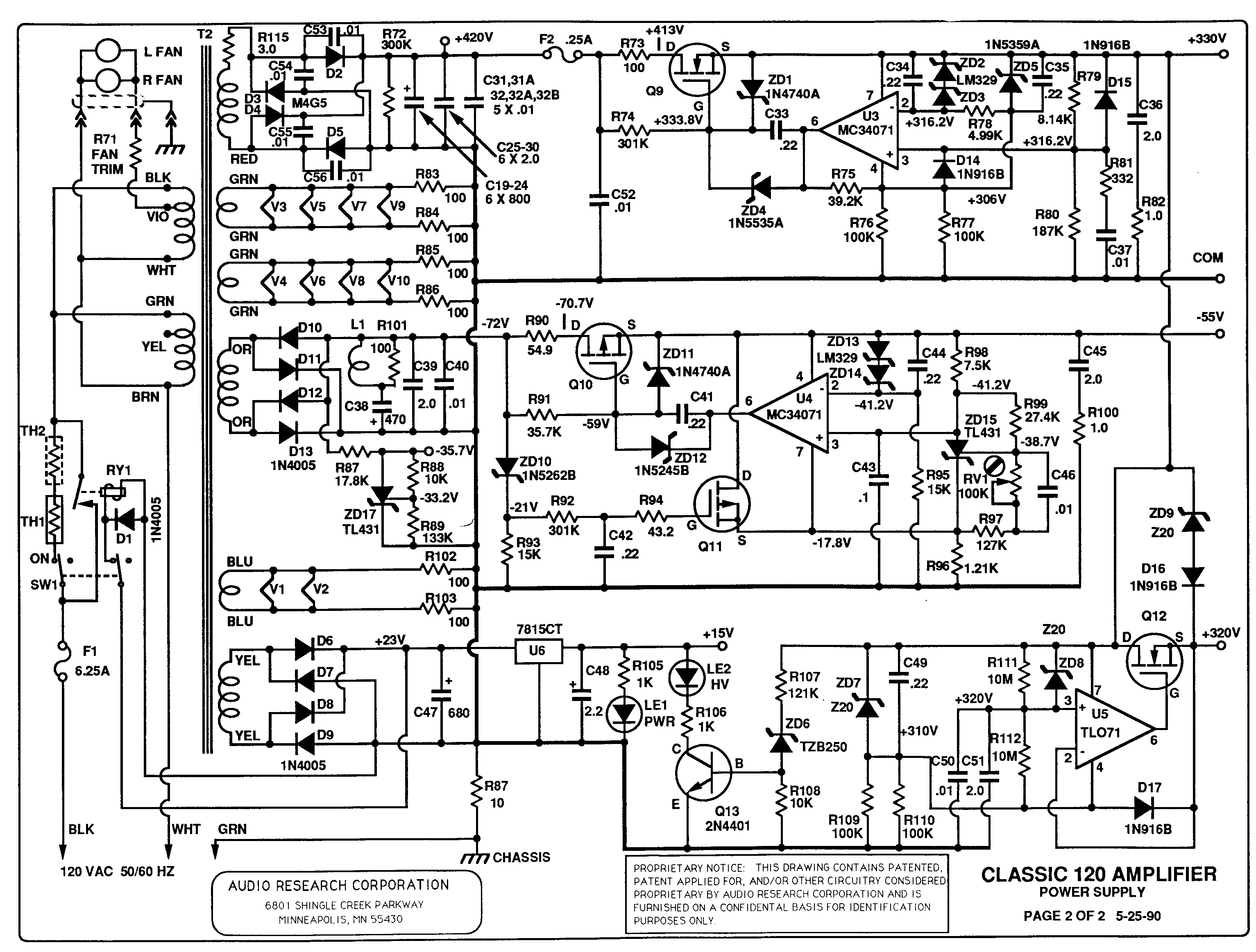

Could you post a schematic I can only find the CL60. Is it the one which adjusts the bias on one tube to match the other?
OK it does have that strange circuit with one side balanced to the other. Mr Summer is correct really the max grid leak resistor is 47k per tube so 74k is grossly incorrect for four - so really you should use KT88's in this application. Shame cause I like 6550's. However that will not be the problem at switch on. Unplug all output tude and measure the grid voltage on each in turn. If you want to disable that bias circuit and just use matched quads remove U7 and replace R114 with 15k. I would do this to test. Check C11-C14 etc for leakage. Also not sure why so many output tubes are needed 4x6550 can generate 120W rms in UL. Triode mode I guess needs twice as many thats a lot of tubes and heater current! I think if you wanted to use 6550 I would go upgrade for servo bias boards as this means you can use much bigger grid leaks and retain the drive. Oh this is more wered its measuring screen current+plate too. Op-amp at HT nice. I would also check the screen resistors too.
The Classic 120 was originally built to use 6550’s. KT88’s were a later option Then a slight mod allowed the use of KT90 and 91’s.
Then I can only think they did not read the 6550 data sheet. To support fixed bias without danger of thermal runway would need R45 = 50k/4 which would be impossible to drive. The minimum I would use is 100K/4 = 25K which is 3x smaller then the 74k. Anyway to help I would check C12 and C13 for leakage. I would also disconnect the master/slave bias as shown above to make testing easier. Using the secondary for the cathode FB OK unless the ground of the 4R tap comes off.
Look at the bottom set of four triode wired 6550 tubes.
Each grid has individual 1k grid stoppers.
The -55V bias is regulated (a stiff DC resistance, and a stiff AC impedance).
The -55V bias is then divided by 1.96k connecting to 30k to ground.
30k / 31.96k = 0.939 divider
0.939 x -55V = -51.6V.
But the schematic shows -46V there.
That means the four 6550 grids must be drawing DC grid current, even at quiescent conditions.
Which ‘fact’ is wrong?
Which is right, -55V, -46V, 1.96k and 30k divider?
Or, the calculation result of -51.6V?
Something does not agree.
And, even with either -46V, or with -51.6V, that bias has to go through a single 71.4k resistor to the four 1k individual grid stoppers.
71.4k x 4 = 285.6k (the resistor is shared by four 6550 tubes).
When you parallel tubes, the g1 resistor is less effective, than the same 71.4k would be for a single tube.
That is a far cry from the requirements of:
One 6550 50k g1
Two 6550 25k g1
Four 6550 12.5k g1
Talk about a violation of the tube specifications.
And in this case, "one bad apple (bad 6550) Will spoil the whole darn bunch".
Note 1: the -55V bias supply has a voltage adjustment pot.
Note 2: the upper four 6550 tubes has a DC balance adjustment pot (and Vactec LED / CDS Photocell) to be able to set the Push and Pull DC quiescent currents to be equal (the output transformer requires equal DC currents to minimize early saturation of the laminations).
I am not sure I would even try using KT88 tubes, given the very large g1 grid resistance, even if it is to a stiff voltage point.
But I would bet on good KT88s versus good 6550s any day in that circuit.
Your mileage may vary (and it seems to be running away, doesn’t it?).
Some think all engineering results are professional and good.
Remember the original Tacoma Narrows Bridge?
KT88 fixed bias:
One KT88 100k
Two KT88 50k
Four KT88 25k.
Conclusion:
Can you live with less output power, I bet you can. Unless this is Woodstock III, or you have those MBL Radiostraller speakers, or you are hard of hearing.
If it were me, I would go for less power output:
Strip out all of the -55V bias supply circuitry.
Strip out all of the VacTek circuitry.
Strip out all of the rest of the fixed bias circuitry.
Then . . .
You have enough room to install 8 self bias resistors, and 8 bypass capacitors.
Individual Self bias will match your Individual tube currents much much better than what you are doing now.
And . . .
Then you can use your favorite 6550s, instead of the KT88s that you do not like.
Let us know what you come up with.

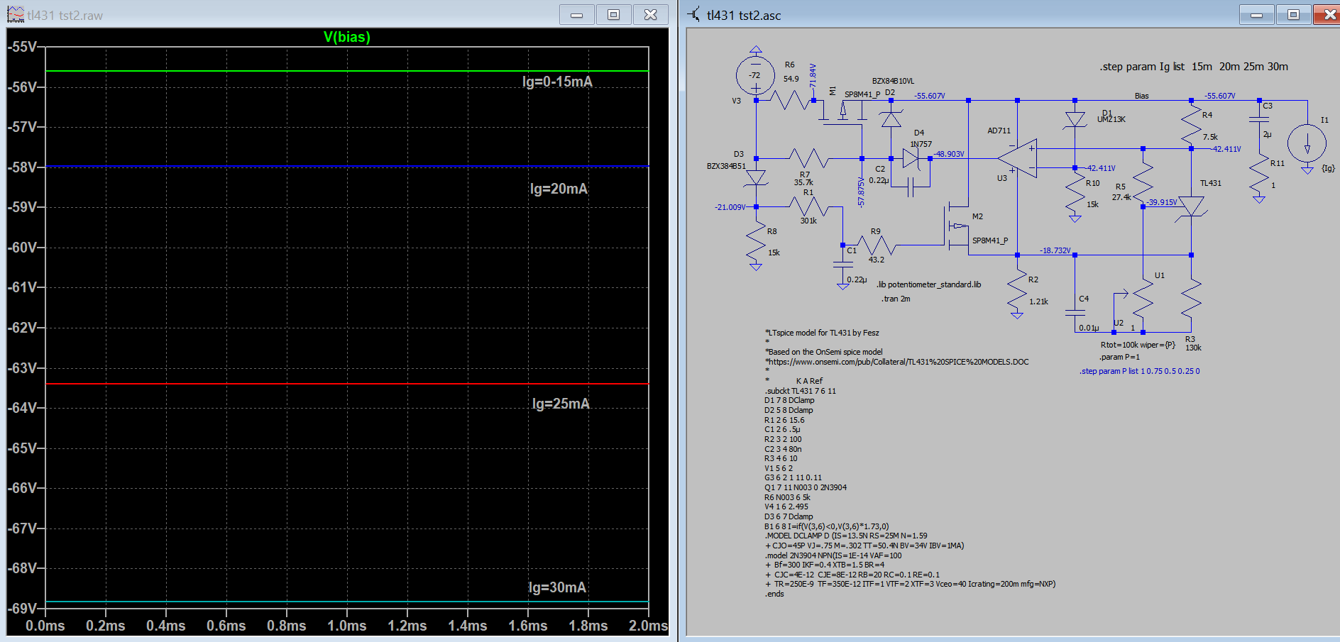

Its odd that its so grossly wrong - maybe it started life as the CL30 and somebody just kept adding tubes.
Thanks guys! Turns out it was a bad tube. Caught a glimpse of it glowing a strange pinkish blue as I was trying to figure this out. Finding a bad tube in a jungle of eight while watching the multimeter and keeping a finger on the power switch so it doesn't blow is difficult. Swapped that tube out and it biased up fine. Now I'm short a tube until I get a replacement.
Audio Research CL30, CL60, CL120 are pretty much the same basic triode design.
....the max grid leak resistor is 47k per tube so 74k is grossly incorrect for four - so really you should use KT88's .....
The KT88 is also 50k max. (It is a copy-cat tube in a different bottle.)
It is not necessarily bad engineering. The 50k number seems to cover "all" working conditions, even on-the-edge hot. Amps which are biased well below their dissipation rations, and using high-quality tubes, are often "OK" with larger grid resistors. A half million Fenders use 220k for two "100k max" 6L6 per side. And often idled at 50%-65% of Pdiss(max), so even if they drift a bit they don't melt. (And also, amp makers rarely warranty the tubes.)
KT88 are meant to have additional radiator fins over 6550. However I am looking at EH KT88 and EH 6550. They look identical. Maybe nowadays they are one and the same thing would make sense from a production point of view. You only likely to get significant grid current if you run the plates very hot as PRR says. You can always measure the grid current across the grid stoppers or the 74K. Anyway the amp will work with 3 each side. Glad you found it. A lot of amps do use 100k each side per tube. I think 74k for four tubes is pushing it though.
The attached is sim of grid bias supply regulation, it can't drawn too much grid current when the bias voltage is increasingly negative when more grid current is drawn. OP amp is arcing, it maybe not be protected this way, IMHO. Some one interested can persuade more about it. Similar regulation with HT supply but I haven't sim it yet.
