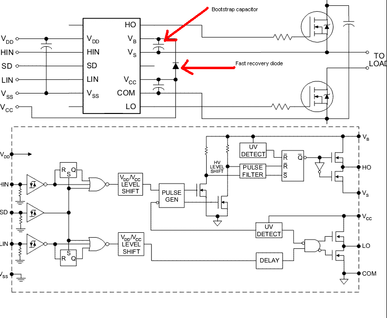

Razor_Edge is using the p,n channel mosfets as buffer to output mosfets ...U need to use a buck convertor first to convert 50v to 15volts..
IR2110 is normally used on 15volts rail...for Mosfets -ve supply is not required..but for IGBT's is a must for better turn off!!
Bootstrap power (for driving high side mosfets)is obtained by using a fast recovery diode+capacitor combination.

One thing has already been mentioned: The ICs have to be fed with around 15 volts. The high-side driver is fed via a bootstrap capacitor. It is important that both ICs have their own bootstrap circuit. To say it in other words: A bridge application is the same as two standalone single-ended driver/output stages.
The spaciality is just that their inputs are driven with different phase and the load is connected accross both outputs.
Best is you make a sketch of what you intend to do and we will be able to correct it.

By BIAS i meant how should I connect the power to the MGD for correct /required operation. I hope, i didnt use this word at a wrong place.
Please find attached is the circuit diagram for your reference.
IN+ and IN- signals are taken from a balanced current modulator. Triangular wave is generated by integrating a square wave from a 555 timer configured for 400Khz frequency for full range front channels.
though a costly option, I wanted to use N and P channel Mosfets for simple design. I am open to experienced recommendation on using N channels for high side using a 7404/7414 to invert the signal.
I am also not quite sure about the compatibilty of the IR2110 for TTL level signals. Please advice.
since this is a stackable design (output stages can be paralleled to the PWM signal) I plan to keep it the DSP section and mother board seperate from the output stage. using shielded cable the IN+ and IN- signals will drive the secondary output boards.
I hope, I have conveyed the whole picture.
Please comment....

Using two N-channel devices is still cheaper because of the superiority/availability of these devices compared to P-channel despite the need of an additional inverting stage.
Furthermore you don't use any means to introduce dead-time (in order to reduce shoot-through) in your circuit. Use a resistor with a parallel diode between gate and driver output in order to cause "slow" turn- on and fast turn-off. The 2110 has some intrinsic deadtime but this doesn't work at all with a complementary stage.
The logic levels of the inputs are depending on the supply voltage of the input logic (VDD). The lower the supply-voltage the lower the levels. But even when supplied with 5 volts I wouldn't recomment TTL levels as input signal. Use CMOS levels for proper and safe switching.

thanks Charles, you have been a great guide. well I will now use N channel for high side too...!! 🙂
Ya, i need to introduce dead time in the gate drive section. would you recommend PNP based turn off. thats because I dont want to go for more than 25 nsec dead time (4.7 ohms resistor). THD figures is what i am a bit worried about at such high powers(7 to 8 amps @ 50 volts)...
For input, shall i use 7407 or similar... or should I use CD4069 hex inverter?

First of all: Even though this might be intended for subwoofer use you'd better let a mod move this thread to class-d since you will attarct more attention there.
This driver IC is sufficiently capable of driving an IRF530 so I don't think an active discharge circuit will have much advantage.
For the inversion of input signals it is advisible to use a circuit that shows the same delay for both input signals.
Therefore a circuit is usually used with two gates of the same kind (one before each input of 2110). So the best solution is CMOS XORs with one input of both driven by the PWM signal and the other input connected to L for the non-inverting stage and the 2nd input to H for the inverting stage.
