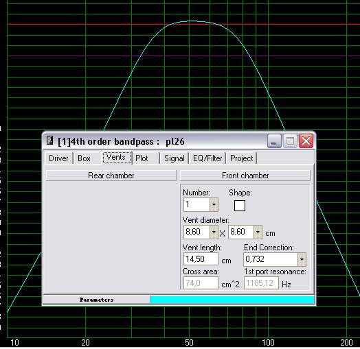

What is the secondary port resonance of that BandPass Sub? How are you dealing with it? Very curious as I've had a similar design brewing in my head.
Hi RJ,
I do not understand your question. Or you are thinking of a vented bandpass.
This is a closed bandpass. See this figure. I have chosen a closed bandpass to get the impulse behaviour of a closed box. Because I think with a Q of 0,75 it is better controlled then a vented type.
The plan.
![fatboy.jpg](https://i220.photobucket.com/albums/dd181/calilm3/fatboy.jpg)
In WinIsd under the vents tab, lower right is a box with the 1st resonance frequency. In Unibox I think it's called secondary port resonance. Sometimes these resonances have a very high spike and larger than the primary resonance. Also a 24 db plate amp might not dampen that spike enough, adding a lot of stuffing helps lower it.
If I had Microsoft Office installed I could probably post a graph.
I'll work on that later.
you mean this one I do not think it is a problem this one is filtered
The TI100 port wants to resonate on 1.5kHz i did not notice a problem there but on 2.5khz there is some interference I want to deal with.
The wind noise is a bigger issue IMO.
The resonance is high enough to be adequately filtered. I've modeled quite a few woofera and quite a few had resonances as low as 200 to 500 hz. Good job and very nice cabinet work.
