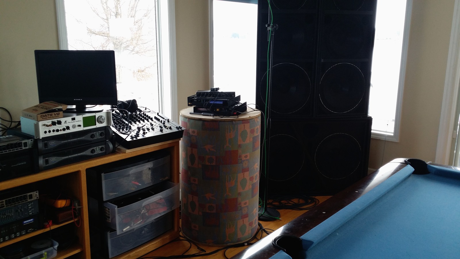

The most effective place for bass traps that I've found is in room corners ...where the energy buildup is....it's like fishing where the fish are 😀
Best trap I've found is big rigid fiberglass steampipe insulation.
Wrap them in fabric for WAF, cap them airtight, and they work.
Here's the best pict of one I could find on phone....
they make great stands too...I've had 300lbs on them no prob...
