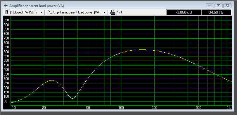

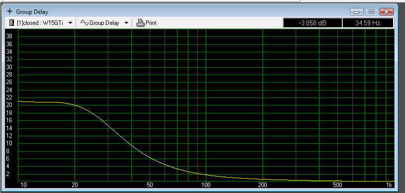

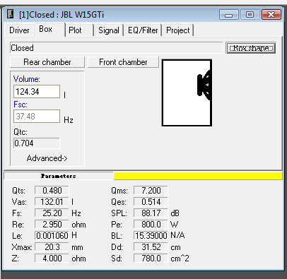

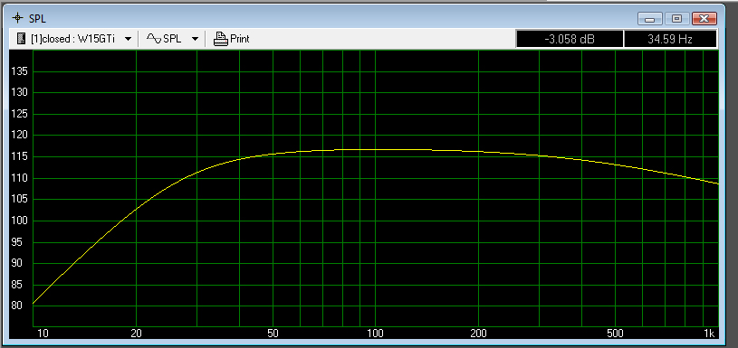

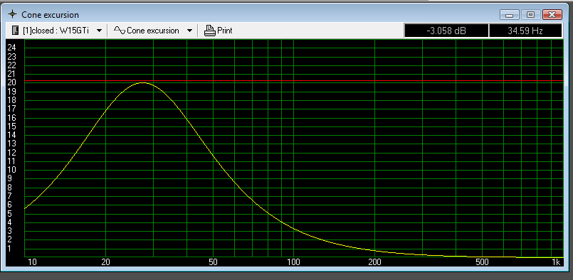

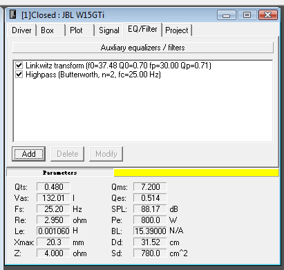

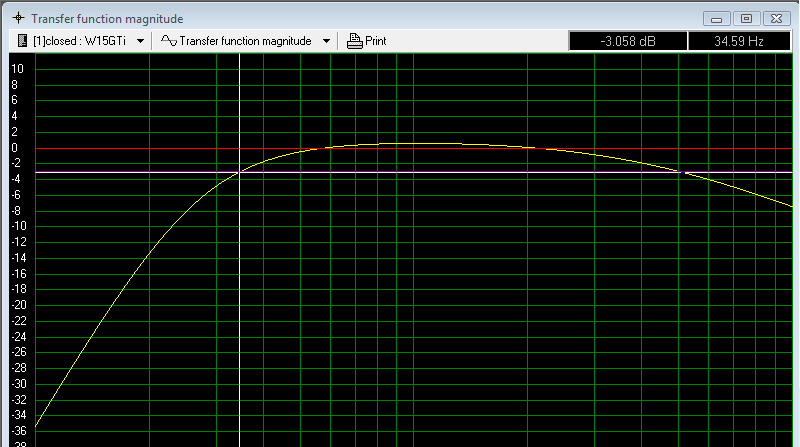

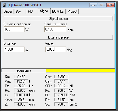

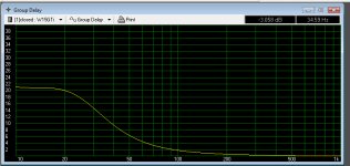

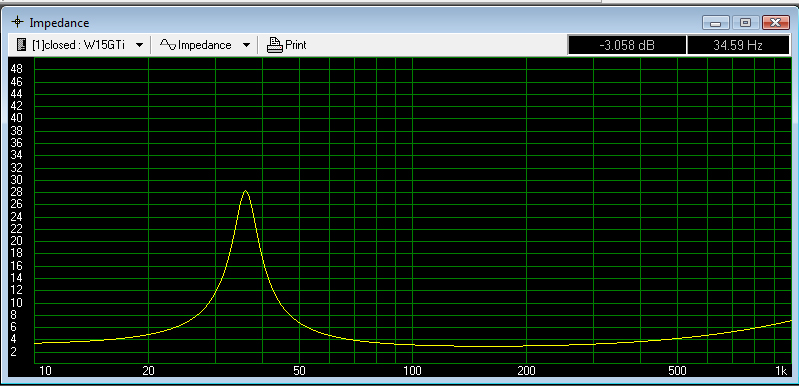

To start things off, this is a 125 litre sealed box with a 35Hz lower limit using the JBL W15GTi. I believe the JBL 2256G would also work just fine. Do note that this is a driver with a very high Mms (260g) and therefore would never ever qualify for a studio monitor driver.
Box details, Power applied, EQ settings, Cone excursion, Response, Group delay, SPL, Amplifier power, Impedance.
