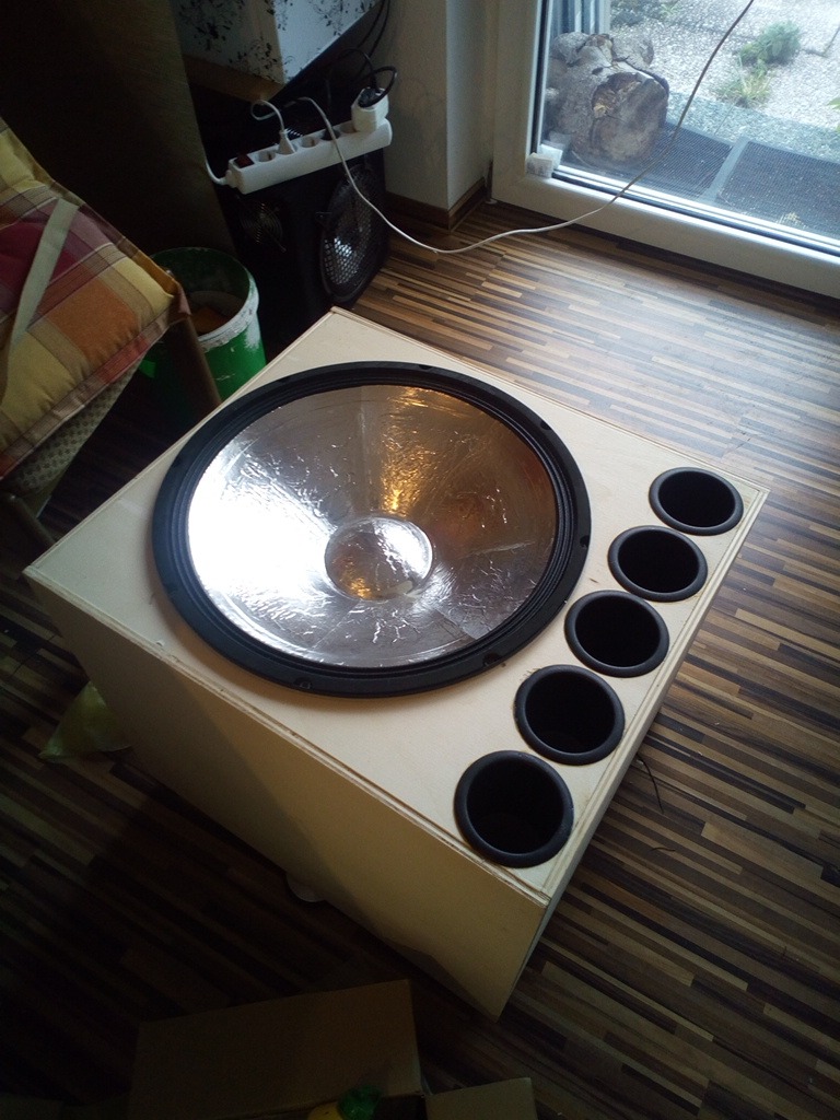

I built this one so that I can still carry it, two lightweight 18inch drivers in minimal enclosure
https://www.diyaudio.com/community/...how-off-my-new-18in-build.365764/post-6711139

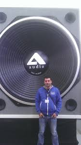

I guess you didnt read what I wrote:
"by movable I don't of course mean enclosures that are a structure that is built to be a part of a building or some shipping containers outside the house lifted on trucks, I am talking about single enclosure subwoofers that you can still move around your room to different positions and even borrow to your friend."
https://www.facebook.com/knowaudio/...e-a-pic-of-the-danley-matt/10152959934230576/
Pretty unique looking cone and if someone accidentally splashes a beer in to that, you can always easily wipe it too, cool.

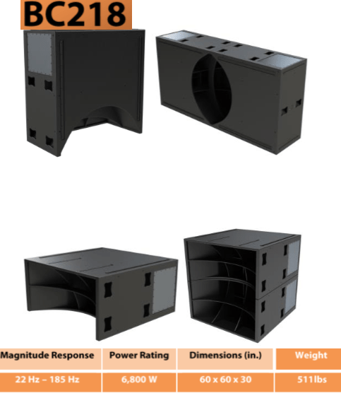

Standard truck dimensions used to be 90" interior, commercial loudspeaker enclosures were built to integer multiples of that dimension, so 45" x 45" x 22.5" was a popular large size enclosure.For commercial subs I have no idea how big they get, but if I take a random example with two 21" drivers, this one is 1200 liters calculated from the outside dimensions, internal volume is of course different.
https://www.dasaudio.com/en/products/systems/ux-series/ux-221a/#dt
Fitting through 32" doors is a concern for movable / portable subs, limiting one dimension to 30".
60" x 60" is a standard size for Baltic Birch plywood, preferred as a construction material for it's even one-piece birch laminations, density, strength and durability.
Larger dimensions than 60" would require piecing sheets together.
DSL's 2x18" BC218 (Boundary Coupled) horn subs are 60" x 60" x 30", about 62.5 cubic feet or 1768.7 liters.
The BC218 horn throat design allows them to be used in various positions in a room or array or free-standing.
A single BC218 can produce over 140dB output (1 meter half space outdoors), adequate for most domestic situations 😎

😊 If I had one and a friend was having a block party I'd take it there. I have a truck and forklift operators licence. Containers aren't difficult to move.I guess you didnt read what I wrote:

That indeed is huge. Probably one of the biggest professionally used subs out there. You had good information about the dimensions used in the industry.DSL's 2x18" BC218 (Boundary Coupled) horn subs are 60" x 60" x 30", about 62.5 cubic feet or 1768.7 liters.
