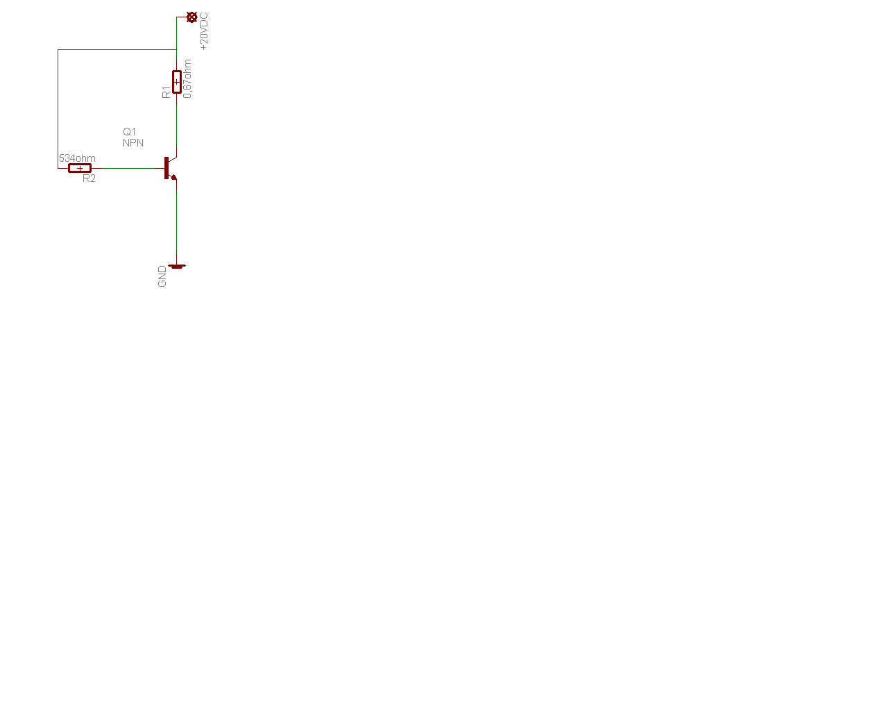

Added schematic which i think is good way to measure tarnsistors
VBE or Hfe value.
explain of schematic:
if i measure current between R2 and base
and current between emitter to GND
and calculate Ie/Ib=Hfe
I think it should give me enough accurate value for Hfe.
Then i just change transistor and do not touch resistors or input voltage
I think i can found matched components with this measurement.
correct if i`m wrong.
Does it matter if i measure it like this or should i measure Vbe?

Your circuit is OK but you will need to use much more than 0.67 ohms in the collector to avoid risk of destruction of both the resistor and transistor. You should also maybe only put 0.5-2 volts on the base. You could be running the device into saturation like you have it, which would give misleading results.
You should also calculate gain as Ic/Ib not Ie as the base current flows out of the emitter so you will get a misleading result.
k1jroth said:explain of schematic:
534 ohms on the base + 0.67 ohms on the collector + 20V Vcc = dead transistor 😉
if i put 534ohm resistor series with base it lovers maximum current to 37,5mA base can take 1,5A and 5Vdc.
I don`t understand why it would broke transistor.
i made mistake calculating collector resistor i think
20ohm 20W wirewound should do it
It limits maximum current to 1A.
with 1A collector current saturation is below 0,8V so it`s pretty low.
Pleso correct if i`m wrong (again).
richie yep it should be Ic my mistake
You should get rid of the collector resistor, and program a known current through the emitter. Typically this would be the quiescent current of the circuit in which you are using the transistor. 1mA, for example.
Use a large resistor for the base, say 10k. Then program a current through the base resistor, such as 100µA. The change in voltage on the base resistor will tell you the Hfe, and you can measure Vbe directly.
