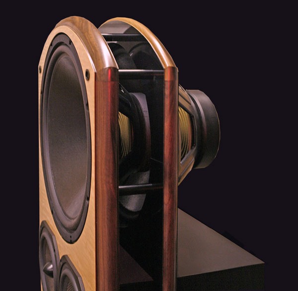

I would like to try this. I have 4 visaton bgs40. Do you think that they could work well is this configuration?
They have:
98 dB (1 W/1 m)
Qts 0.42
fs 40 Hz
xmax +/−8 mm
Linkwitz also wrote about this sub configuration. He proposed a time delay for optimal cardioid radiation. Yours seems to work well enough. Perhaps your dimensions are so small that it is not nessesary.
I haven't even thought about that. Just design it as an option. I could just switch it to bipolar, if i am in the mood for some chest pounding edm bass.
But that would change the construction significantly. For bipolar, i would have to make it completly seeled and make it as rigid as possible. Am i right?
