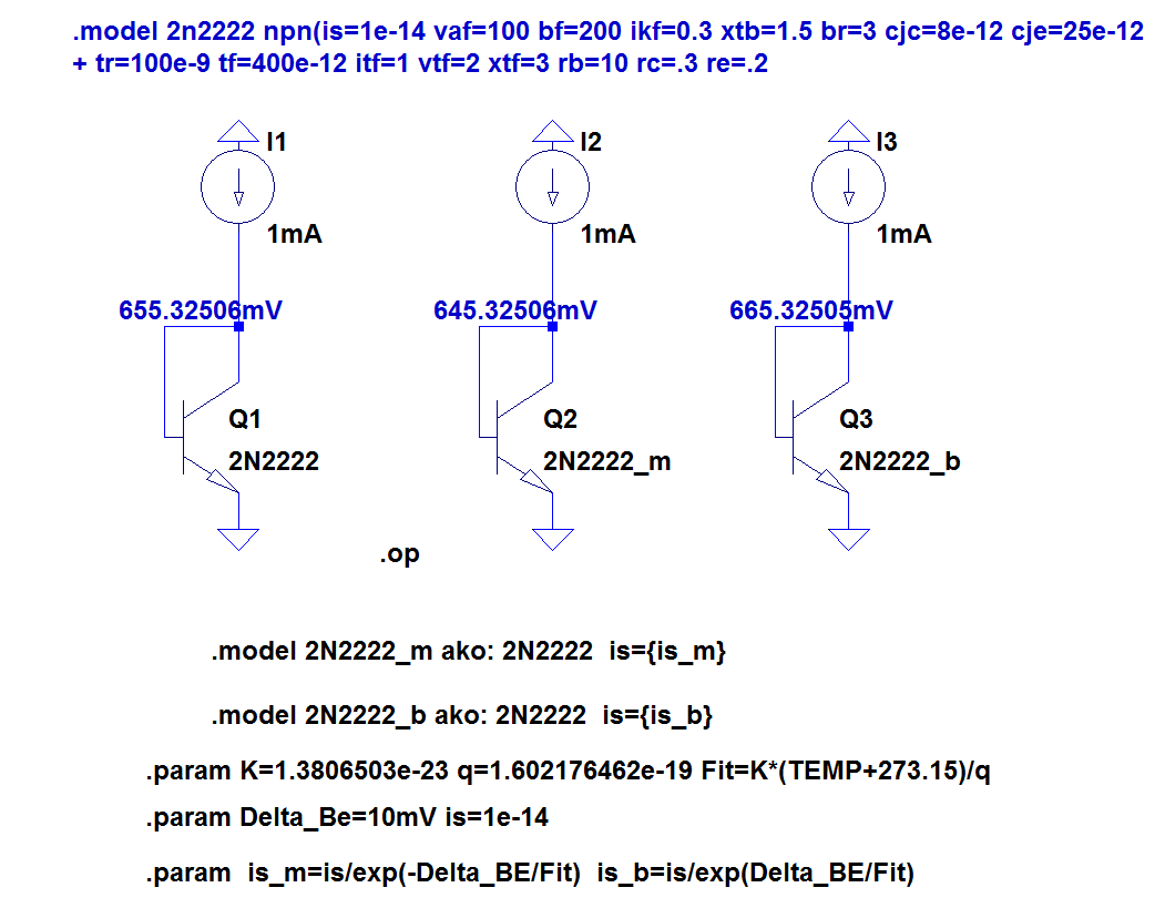

Another dummy test is to put a 10mV battery in series with key Bases, faking a 10mV difference in Vbe. Holistic circuits will hardly notice. Maybe a 2% difference in reported currents, which should not matter.

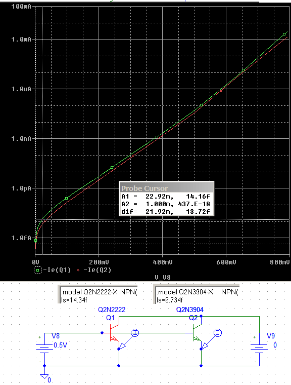

You should *know* basic transistor theory. Vbe comes directly from Is, Thermal Saturation Current. When you force less Vbe, you get less current. What if Vbe is taken to zero? You do not get zero current! You get a really small current (due to thermal agitation) which we can't measure, but we can extrapolate from Vbe versus Ie.
Is is really "junction area". Doping, leakage and other things affect it, but you can think of "area". Printers can control ink to a few percent, and chipmakers can too. A given part/process is likely to have +/-5% control of area. This works out (I think) to 5mV variation of Vbe. Clearly many stable processes do better than this in a bucket of parts. Dies made in different times and places will differ more.
The (SPICE!) report below shows this. Two transistors, one bigger than the other. In fact when you get Vbe down to ZERO the current goes way off. But note the very long flat slant. If you hold your ace of spades to the screen, this slant extrapolates to essentially the Is values *in the SPICE model* used. And the bigger part at the same Vbe makes more current; or at the same current, a lower Vbe.

I haven’t tried this myself, but it seems quite doable by creating two models of the same part, say 2n2222_1 and 2n2222_2 and use the .step command to step through the parameters of interest. Below is taken from the LTSpice Help file:
Code:
.STEP -- Parameter Sweeps
This command causes an analysis to be repeatedly performed while stepping the temperature, a model parameter, a global parameter, or an independent source. Steps may be linear, logarithmic, or specified as a list of values. <snip>
Example: .step NPN 2N2222(VAF) 50 100 25
Step NPN model parameter VAF from 50 to 100 in steps of 25.
Example: .step temp -55 125 10
Step the temperature from -55°C to 125°C in 10-degree step. Step sweeps may be nested up to three levels deep.
Thanks, now I see clearly how to deal with Vbe.

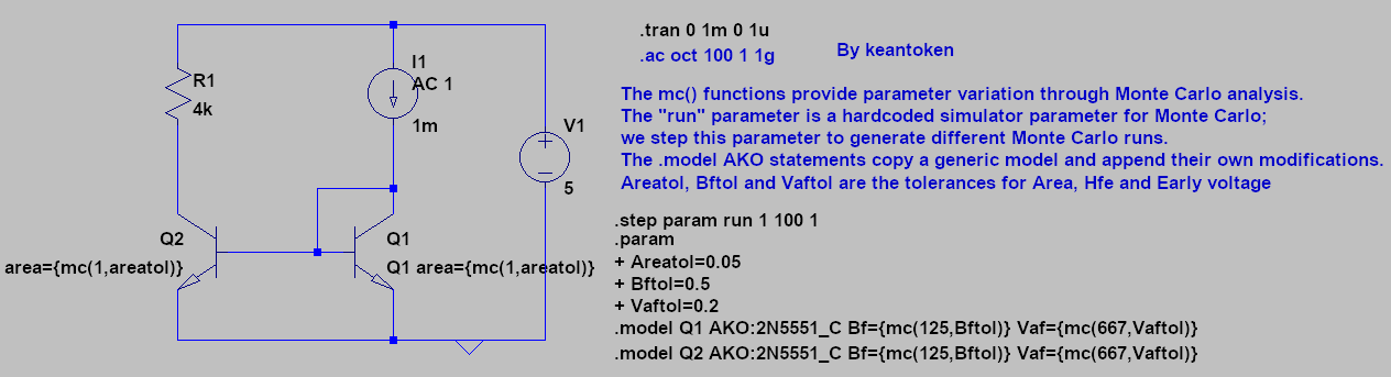

The transistor area can be specified after the transistor part number. So in LTspice you can change
2N2222
to
2N2222 area=1.05
which models a 5% increase in transistor area. This also works with the temp parameter to change static junction temperature. To include this parameter in monte carlo analysis you can use

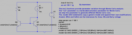

2N2222 area={mc(1,0.05)}
Where 1 is default area and 0.05 is the tolerance for the variation. To activate the Monte Carlo simulation you need to step the "run" parameter using for instance:
.step param run 1 100 1
Which will generate 100 steps with random deviations of area within tolerance.
Area doesn't affect Bf or Vaf. For that you need to add monte carlo statements to the SPICE model for each parameter you want to change.

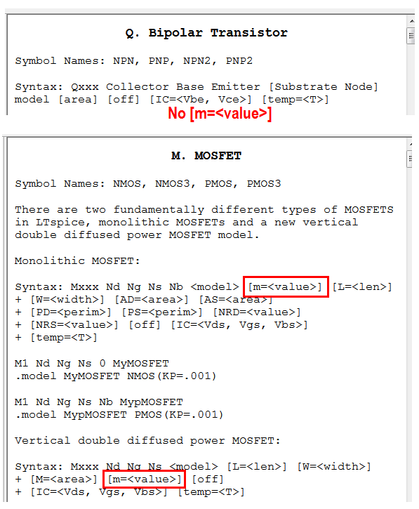

Area=2 is exactly like having 2 transistors in parallel. Vaf is a relative parameter, so it doesn't change when you put transistors in parallel. You can also use the parameter
2N2222 M=2
To represent 2 transistors in parallel. I don't know exactly how this differs from the area parameter if at all. For diodes and other 2-terminal components you can use N=2 to represent 2 in series.
