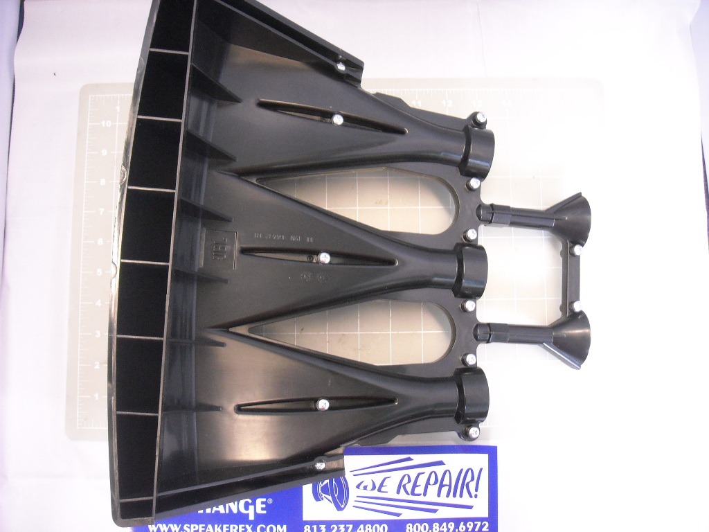

If you look at SR line arrays as an example it's not uncommon for them to use multiples. Same drivers but I would think the manifolds would be hard to do so you don't get destructive interference. Might want to look around for availability, Obviously will limit to one throat size and physical driver size could also be an issue. Food for thought!

https://reconingspeakers.com/products-page/jbl-vrx932la-1-horn-assembly-364432-001/

I have seen people claim the same and people that claim a properly designed manifold doesn't negatively impact performance.I would think the manifolds would be hard to do so you don't get destructive interference

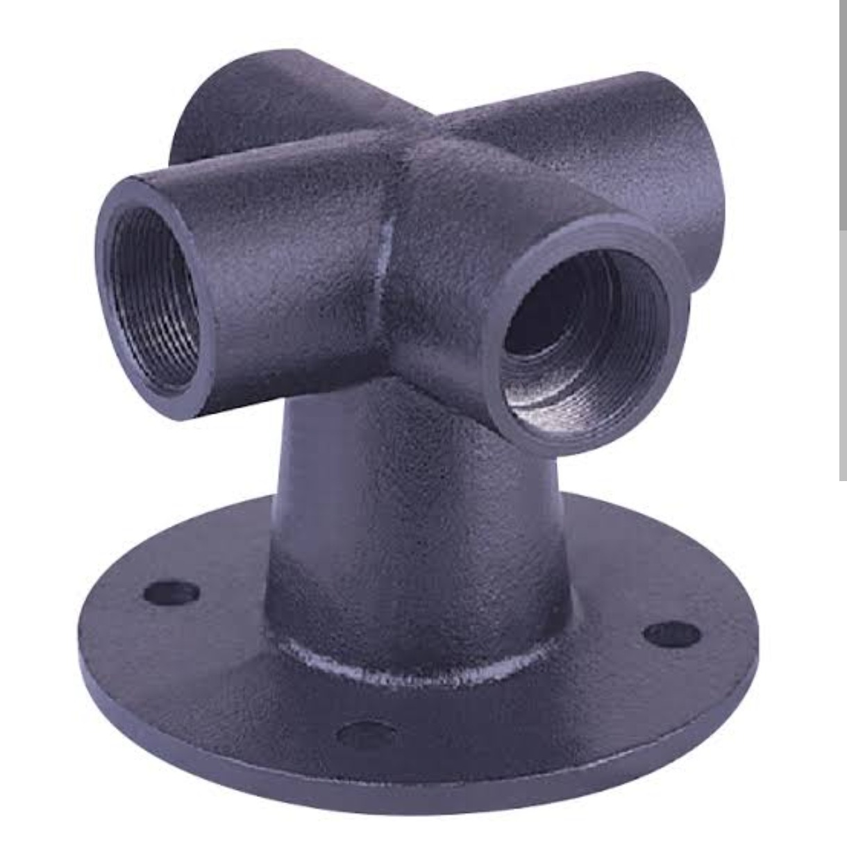

P audio pc-70 4x1" to 2"
My idea is to try it with two different titanium drivers combined with 2 different phenolic ones.........if it is not an obviously flawed idea.
Not necessarily me I am happy with one that said there is no reason you can't try it.My idea is to try it with two different titanium drivers combined with 2 different phenolic ones.........if it is not an obviously flawed idea.
The one I linked have them feeding a common horn not literally aimed at each other. Find measurements on the one you have in the photo. You could look up measurements for the one I linked by looking at the overall system response in the cabinets where it is used. If you are hell bent on 4 obviously 3 won't work.
It's not going to be plug and play. You are going to need a crossover to do it right. You won't know until you measure the combo individually, in pairs and in total on whatever your horn is. You will find out quickly if there is destructive interference going on by comparing singles to pairs.
