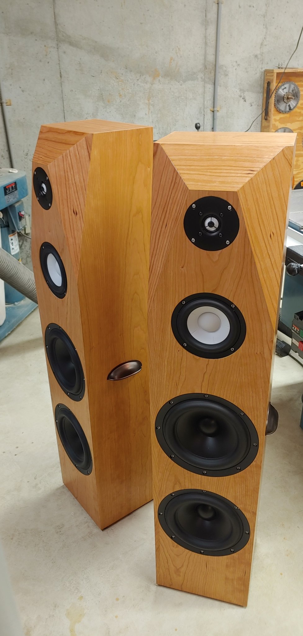

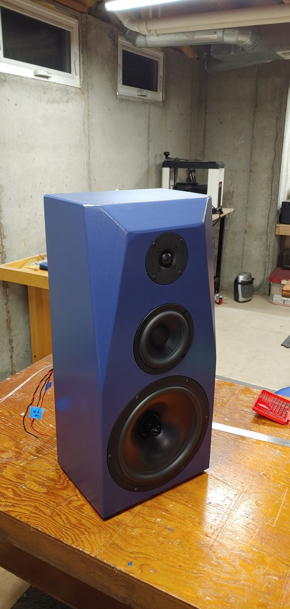

If you are not going to use a waveguide, then I recommend designing the baffle around the tweeter to be as small as possible. I have used tapered bevels to do this, and it works well.
It is important to get this aspect of the design thought-out at the very start, because deep bevels like this affect all the other cabinet design decisions.
A trapezoid cabinet with uniform round-over edges would also work equally well, and I may build this kind of cabinet in the future. The point is that the flat area around the tweeter should be small, and there should be no 90 degree hard edges around the tweeter.

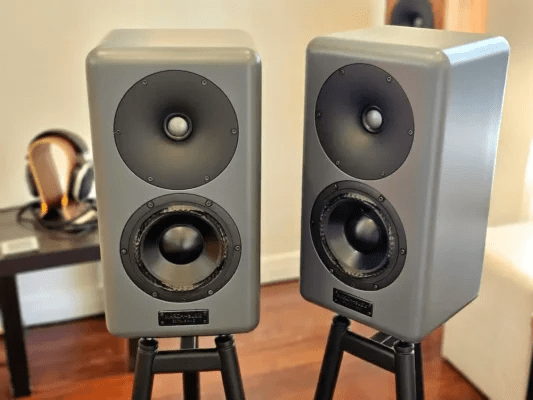

Another option would be to make a small cabinet for the tweeter with a baffle that is just large enough, and put it on top of a separate cabinet with the MW16TX driver. This would be similar to the B&W approach.
If you are going to apply a waveguide to the T34B, you can use a more traditional rectangular cabinet with large round-over or beveled edges, something like the March Sointuva:
The waveguide mitigates the baffle gain in the lower treble region, so that big flat baffle around the tweeter does not cause problems. If this same cabinet had a normal "flat faced" dome tweeter, then the directivity would be uneven in the crossover region. The March Audio speaker has nearly perfect directivity performance.

The Troels SBA MW19 has hard-edges around the tweeter. That is one thing I feel is important to avoid. A 20 mm wide bevel on both sides and along the top edge would improve imaging and spatial performance in my opinion. I like to use a 35 degree bevel angle (relative to the baffle), but any angle between 30 degrees and 45 degrees will work well. A 20 mm radius round-over will also work well.
