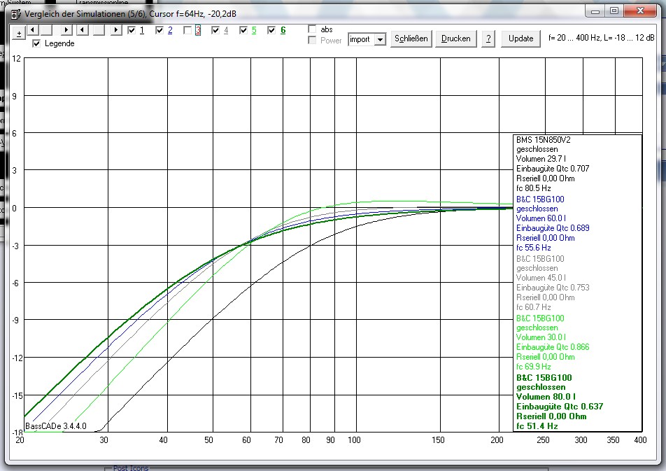

Here are the simulations:
Note: That's a fullspace simulation.
The B&C goes deeper in that volume (less steep drop) but it's not that clean tuning. At first the differences don't seem that different. But I'd go for the BMS, it will sound a lot cleaner and more 'crisp', 'faster'. It's not that deep though but with just 60l you'd sacrifice spl (probably a lot) if you want to go deeper.
Edit: the B&C got much worse group delay

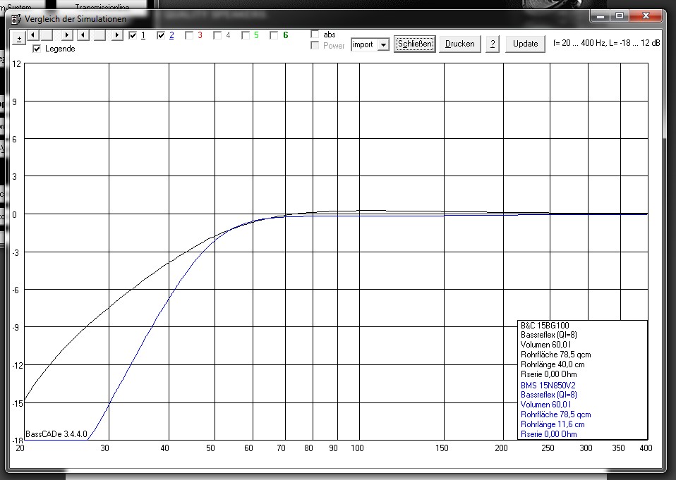

ICG,
I’m a little unsure but did you model them in sealed 60L enclosures or bass reflex?

In 60L sealed they are both very similar below 100hz. BMS has a bit more going above. If cost is no object BMS all the way. More advanced motor, better suspension linearity.

BR. You can see the port parameters in the small box on the right lower corner.
Rohrfläche = port surface
Rohrlänge = port length
Ah!
Do you mind modeling them sealed? I am pretty sure the BMS will need some EQ for it’s F3 to match the B&C. I am wondering how this will affect max SPL even though the BMS has 12-13 mm one way Xmax versus the B&C which is about 9 mm.
I am considering to use 2 drivers in 1 cabinet for total of 120L volume. The goal is 105-110dB max from 50Hz - 200 Hz.

Sure, np.
While ported I'd prefer the BMS, sealed it's reversed. As you can see here, the BMS won't give you satisfying results in a sealed cabinet, -8 dB at 56 Hz isn't worth building, at least IMO. And you can also see the B&C could easily be EQ'd to extend the bass much deeper, don't forget, you also get roomgain, this is a fullspace simulation.
That is absolutely reasonable, with two drivers you'll be slightly above that figure. 60l each is also what I'd chose. Go for it! 😀
