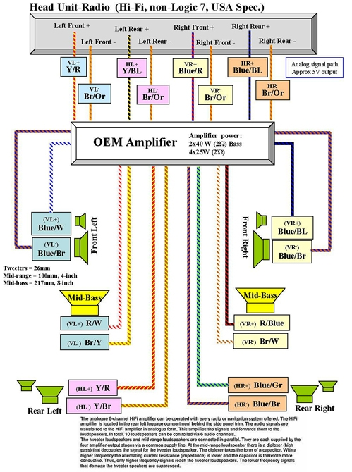

The HiFi audio system has 4 channels of nice, clean, analog audio signals coming from the BMW Professional head unit. I'm keeping the stock head unit as I see no reason for changing it - Bluetooth or any other connectivity can happen at the amplifier side.
As stock, full range goes to all four corners of the amp, which then crosses the signal at 150Hz (some sources say 110Hz), lower going to the under-seat 8" woofers, and higher (and equalized) going to the 4"/tweeter combinations in the front doors and parcel shelf. The speakers are all 2 ohm, and the amplifier gives 25W for the mids/highs, and 40W for the woofers. I think earlier systems had tweeters at the back.

I will post photos soon, and I will then go through the wiring. I will be cutting my wires out of the harness, long enough that I can return the car to OEM if need be, but I recommend getting a connector rather than cutting. I have a wiring diagram I will also post with photos.

Look at the wiring diagram attached for wire references, but it seems that the brown trimmed wire is always negative. The wiring in my car was slightly different to the wiring diagram, but the main colour (blue or yellow) and brown were consistent.

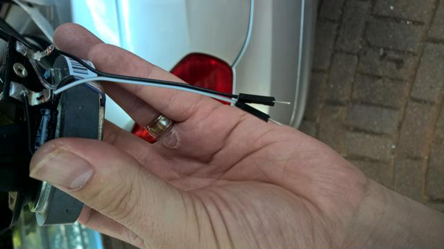

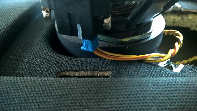

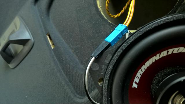

I found an Arduino-ready ribbon with pins on at my local electronics shop, and this meant I didn't have to solder a pin header onto any wires, so that saved me tons of time (attachment 2). Remove the speaker, pull the blue clip, plug in the pins, and you're done.

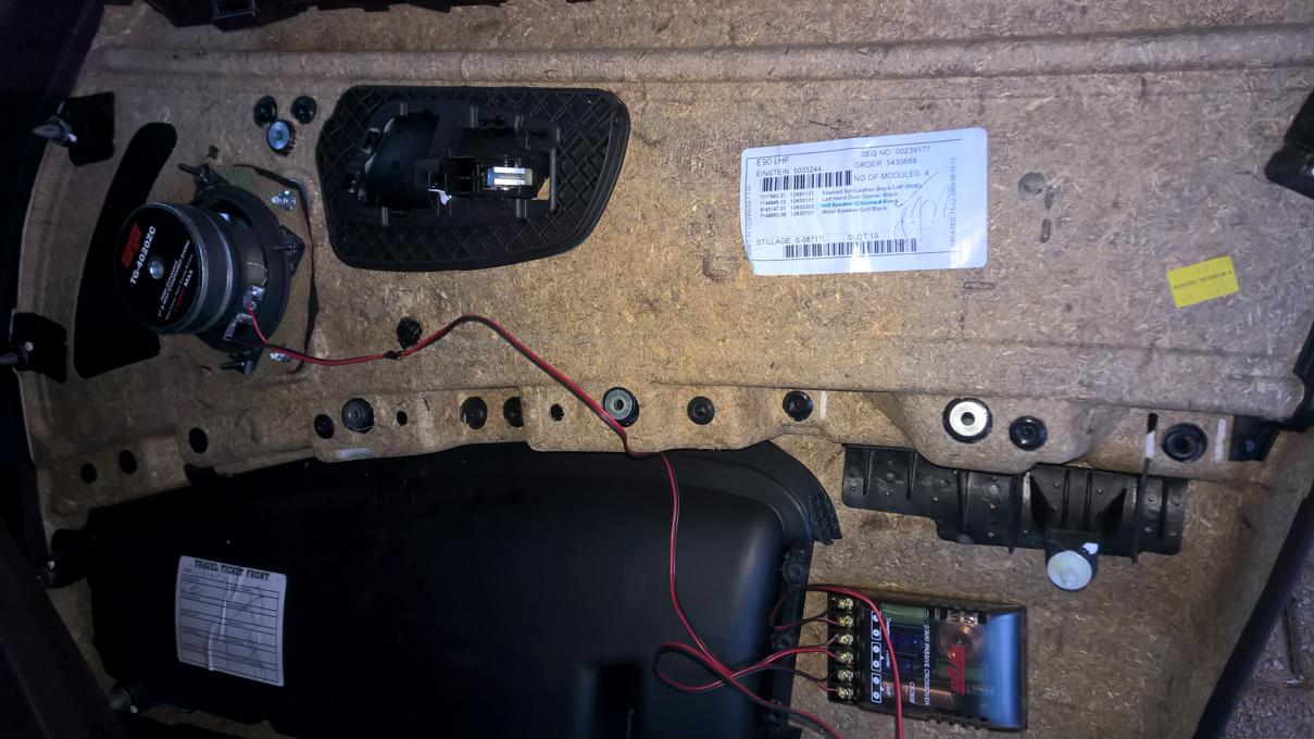

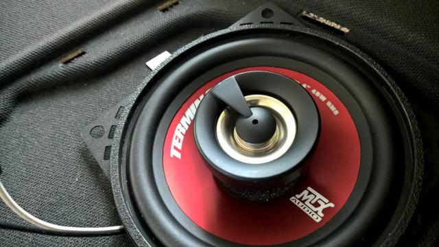

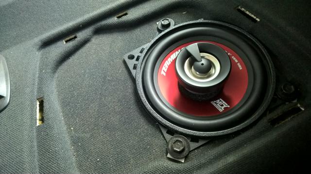

In attachment 5, you can see the one screw tab on the new speaker doesn't fit - cut it off. Use a washer on the top screw to hold the speaker down. It's also possible to drill a new hole and use a new clip on the remaining screw tab (attachment 6).

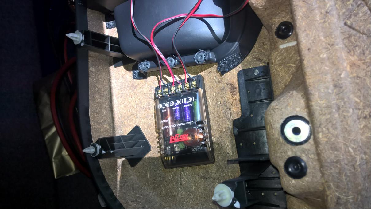

For the doors, install the crossover in the shown location - there is plenty of room. I then used double sided tape to hold the wires in place. The new speakers didn't fit on the existing screw locations, which were quite different to the rear speakers, but the stock speakers also fit into the hole with a gasket, so I recommend cutting an adapter to screw the new speaker onto, and then screw that onto the existing screws, using a gasket between.
