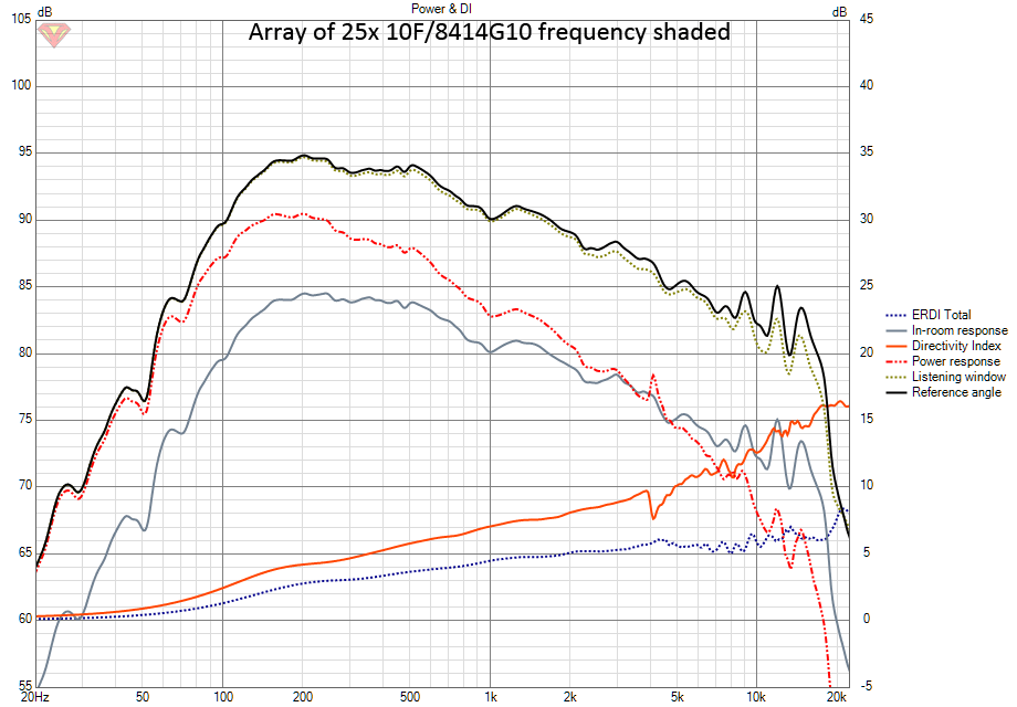

Let me first explain what I had to do to get decent sound in my room. With a line array you get a totally different effect in-room due to the drivers interaction with each other. Al low frequencies all drivers sum, and the higher one goes in frequency, the more the drivers interfere with each other, because the array becomes larger that the wave length they are playing. There is a whole bunch of math behind it that is explained in this thread. It results in a frequency graph that, by itself, is useless to sound good. The curve drops down by about 3 dB/octave towards the high frequencies.
An example of the output of an array (simulated data)
So to get something that sounds good, I had to use EQ. Having no idea how to go about it, I started reading a lot about "House curves".

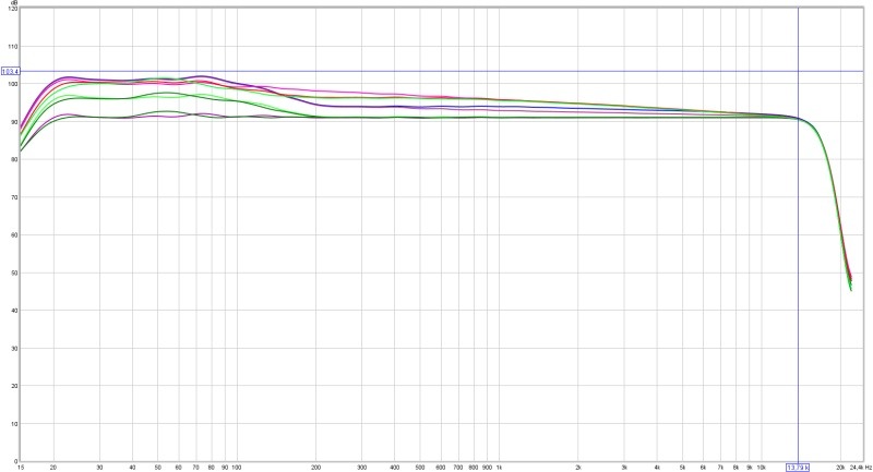

Curves as measured at the listening spot. That's where I measured and set my house curve.
After a few exercises like the above , I picked the one I liked best with lots of different types of music, and lived with it
for a while. Use it in every day use for a long period, while making little teaks every now and then. Slowly growing into
a curve that worked for most material. Having done that for months, I grew towards a certain curve that did good on
almost every song played. I only needed to keep the average SPL level the same too, as that influences the perception.
I chose a fixed average SPL level of about 85 to 87 dB on average. (meaning peaks are way higher)

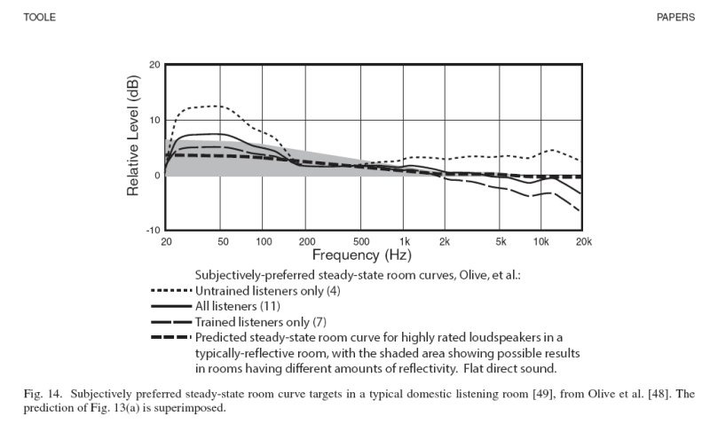

After looking at the curve I grew into, I started comparing it to the various graphs of curves I had collected. One curve
stood out for me, as it was a near spitting image of what I had arrived on:
The dashed "trained listeners only" curve in this graph by Toole was as near as I could find to my preferred curve.

You touched upon it in your original post. The directivity of the speakers influence what sounds good. Meaning that
the speaker directivity can determine if and how much the top end should drop down. So take the above as a starting
point and do further tweaks from there on. The basic shape can guide you, the exact values might differ in preference.
just look at how wide all the different preferences are within that graph from Toole. As you listen more and more, it
becomes easier to be more critical of what it is you're hearing. Live with it for longer periods, it is much harder to
determine what's right in a short brief moment. Yet, coming in with fresh ears the following day often is an eye opener
too!
