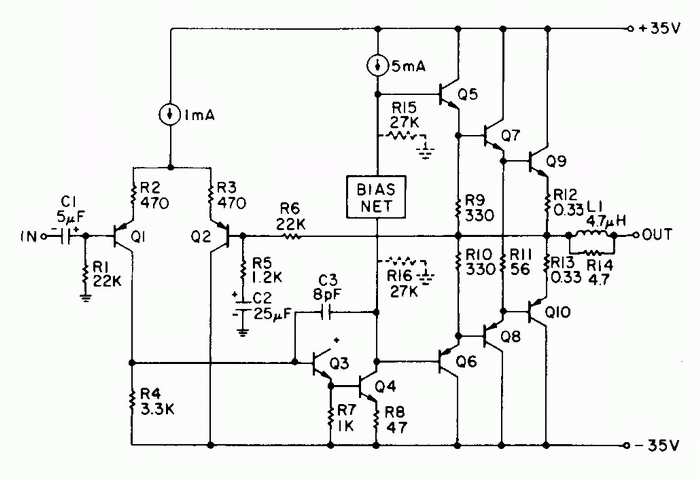

In one of the PDF's in Bob's site, there is an amp. The amp is attached below.
The output stage looks like triple darlington, Q5+Q6, Q7+Q8, Q9+Q10.
Why is that Q5+Q6 and Q9+Q10 's emitors are attached to the output node, while Q7+Q8 are not attached to output? What is the reason to make Q7+Q8 have different connection than Q5+Q6 and Q9+Q10?

Why is that Q7+Q8's emitors are not connected to output like Q5+Q6 and Q9+Q10? I saw this also in Fostexlab600 amp, Alesis RA500 amp, these amps also has the same connection, in triple darlington, the 1st and 3rd pair is connected to output, while the 2nd is not. What is the reason of such connection, do you know the reason why?
mikeks said:This connection of Q7/Q8 makes for more rapid extraction of charge from the output device that's being turned off.
This cross-coupling should be extended to Q5/Q6 so as to cause them to operate in Class-A, regardless of output load.
It is right, but who will diswcarge the cable and the speaker?
it may interest you to know that leach amps have both predrivers and drivers connected so...
