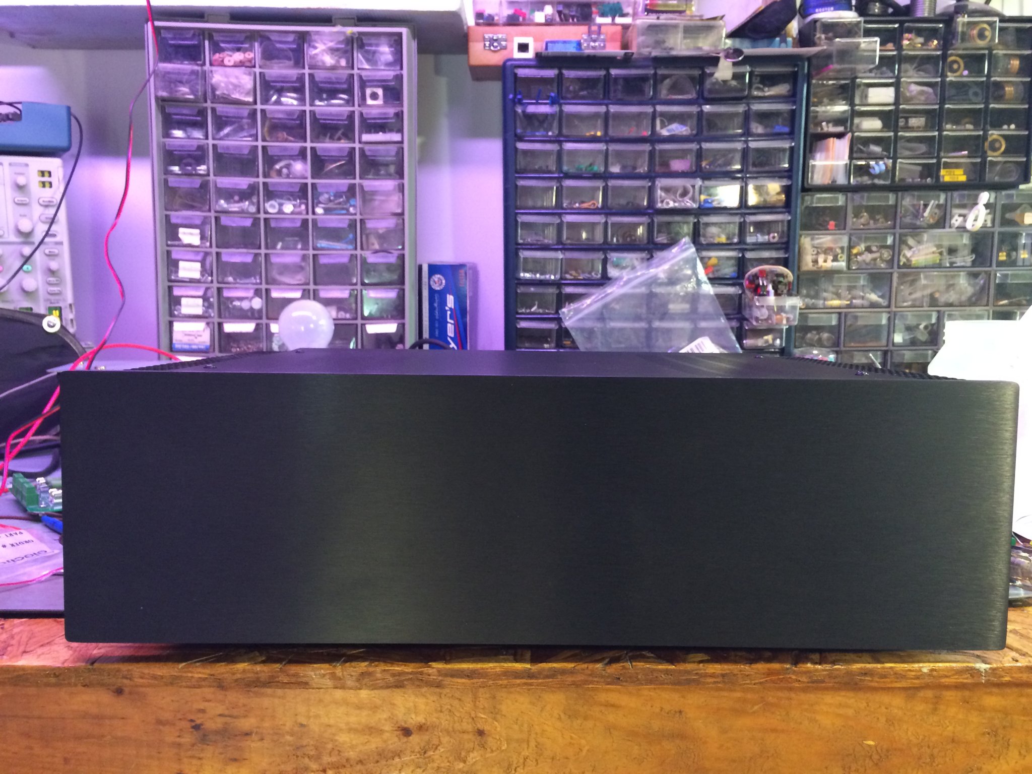

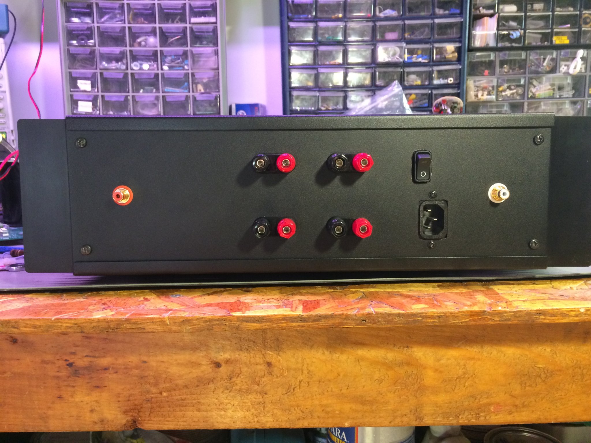

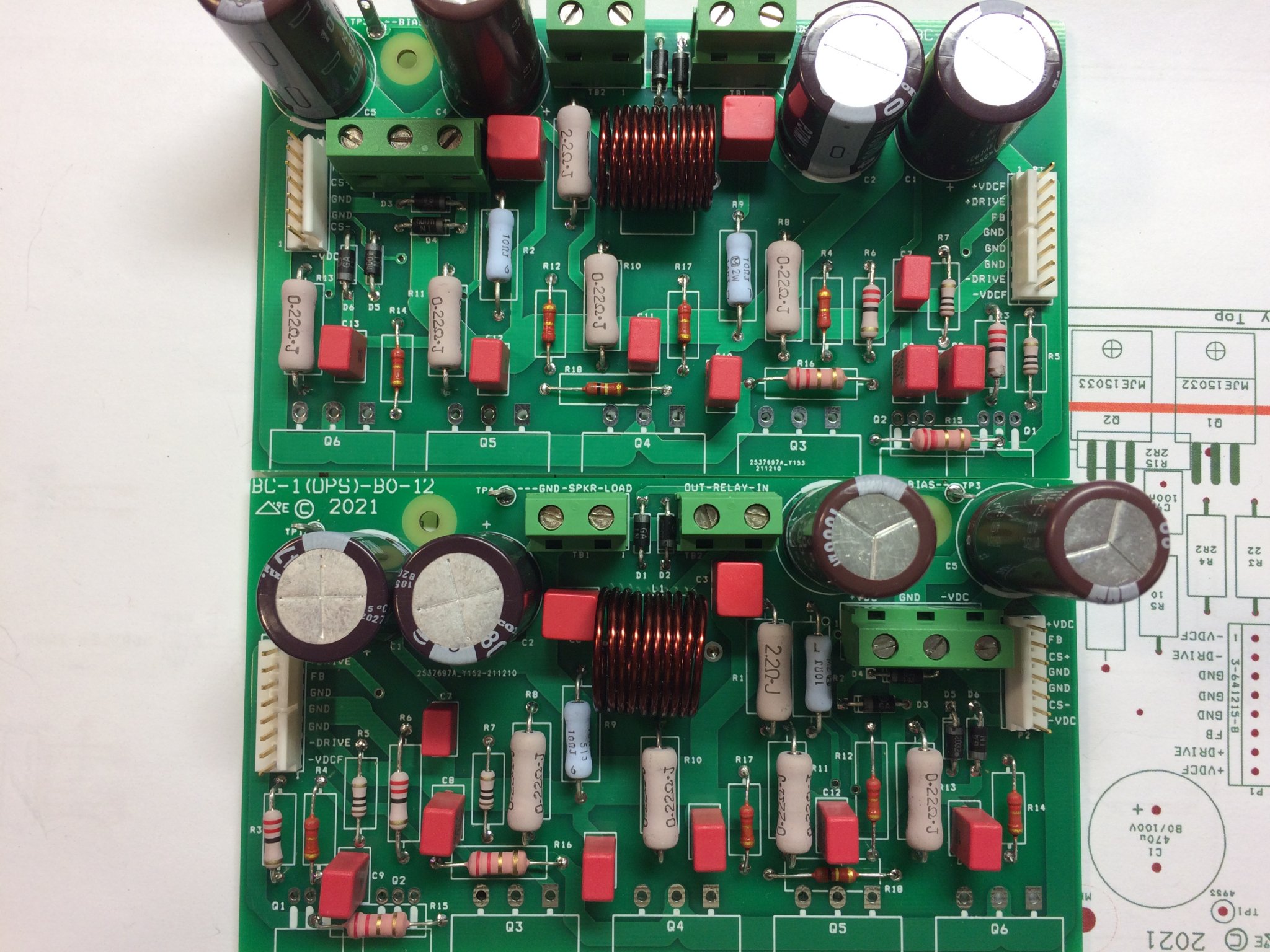

This thread is created to discuss the BC-1 amplifier design and implementation as described in chapter 4 of Bob’s 2nd edition of the “Designing Audio Power Amplifiers” book.
We decided to put BC-1 in a hifi2000 Dissipante 3Ux300mm chassis as a means to have a complete design and as I put it, a reference design right down to the finest of details to make the build as easy as possible. It was done this way since it involves mechanical work such as heatsink drill and tapping that could be done by the chassis mfg as an additional cost if required.
The pcbs were designed to fit on the heatsinks and that chassis with a base pan.
The pcb set has mirror images pcbs for those heatsinks mounted on left and right sides.
As a beta tester I was hoping that you would review my build guides and assembly procedures for that chassis build.
Not to say that the design can’t be put in a different chassis but it was optimized and laid out for that particular chassis. Which means you will probably be on your own for mechanicals in a different chassis.

When I get on the computer I can show a few pics of the completed design
Still interested?

It depends on the transformer, we had this conversation, went like this, but it was determined that 100VCT is needed, since 90VCT is a little shy of the target 150W/8 ohm.
So its 500-650VA for that chassis as it is laid out in the pic. I used a Triad VPT100-5000, since it was a good deal at Arrow, shipping was free, Mouser wanted more plus extras for shipping, same for Parts-Express.
