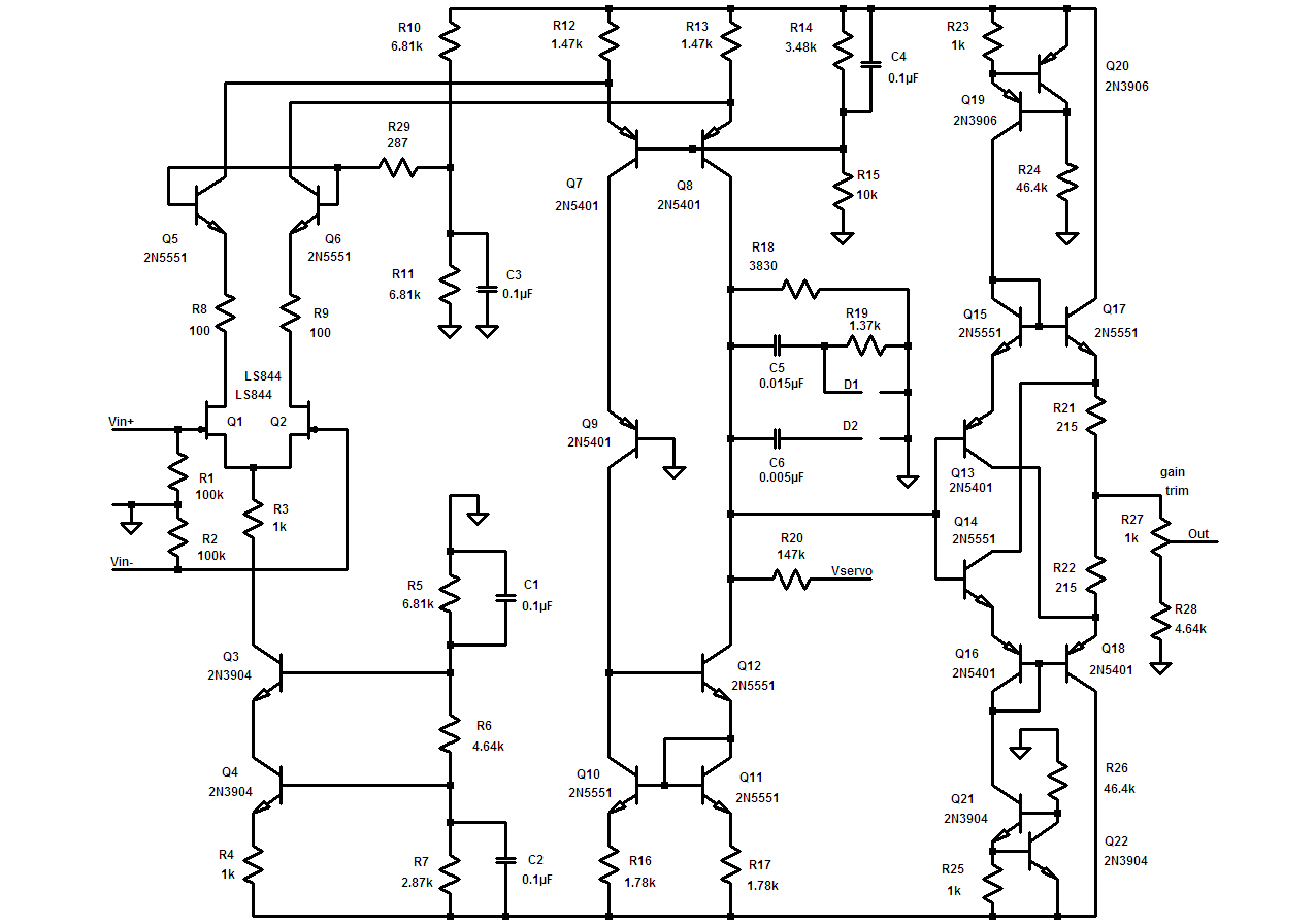

2) Chapter 15, p336, Figure 15.13 was changed from my review. Text in book was for attached fig 15.13

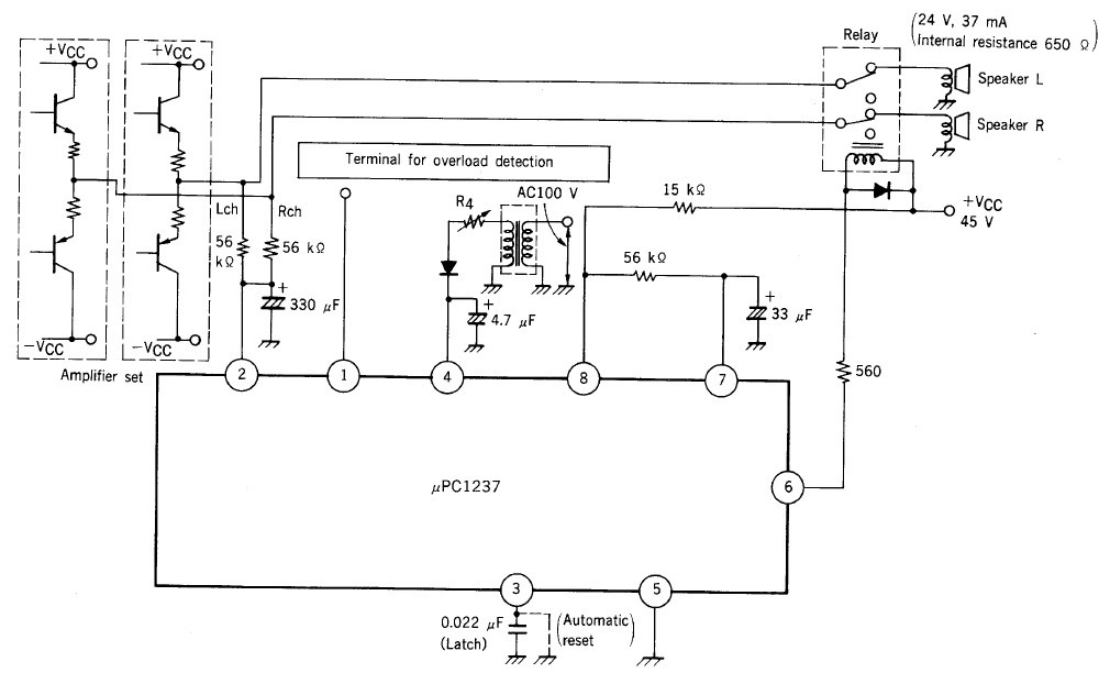

5) Chapter 21, p483, Figure 21.6, the function block should be labeled as "TA7328" and not uPC1237. uPC1237 example as attached

Thanks for corrections - duly applied. Couple of points, as follows (with reference to Rick's nomenclature above);-
2) Figure 15.13 - the revised diagram has D1 & D2 missing - is that intentional?

As written in the book describing the circuit operation.2) Figure 15.13 - the revised diagram has D1 & D2 missing - is that intentional?
Nodes D1 and D2 are connected to ground through relay contacts for conventional equalization.
